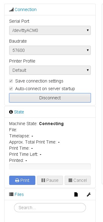

on the left hand side we have our printers connection info:
[img]https://lh3.googleusercontent.com/-Ypqg ... pture8.PNG[/img]
serial port is where the printer is plugged into, if you have the webcam installed there will be 2 options of possible connections.
select one of the serial connections, set the baud rate to 57600 and try to click connect.
if that was the correct serial port you should get a updated "state":
[img]https://lh4.googleusercontent.com/-_DkQ ... pture9.PNG[/img]

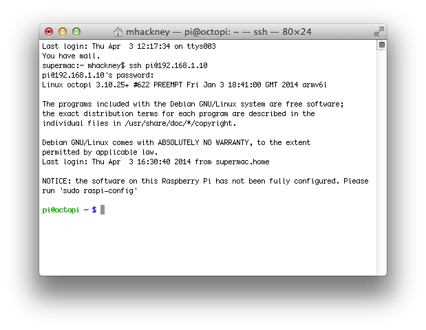

Launch the OSX Terminal application. At the prompt you are going to open a secure shell (ssh) to the RaspberryPi by typing the following (not, substitute YOUR IP address for mine)
ssh [email protected]
After a few seconds you should see this screen:
You are now connected to the RaspberryPi! From here, follow the instructions on that screen by typing sudo raspi-config at the prompt. You will get this beautiful screen that allows you to configure:

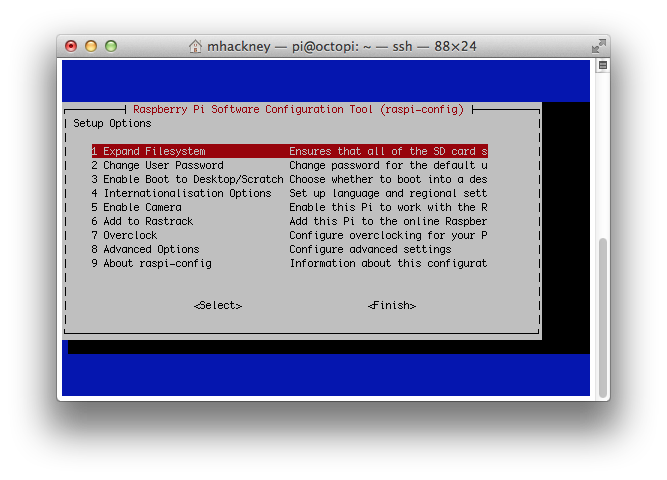

Here's what to do next:
Select option 1 Expand Filesystem - use the UP & DOWN arrows to select the options and RETURN will run the selected option and ESC will invoke the button at the lower right - usually <Back>. After the SD filesystem is expanded, you will need to reboot the Pi to complete. But, finish configuration before doing that...
Next, change your Pi's password with option 2. By default it is "raspberry", you might want to change it to something else.
If you are non-US English speaker, set internationalization options in 4.
If you have a camera (I got the Pi Cam with my Pi from Element14, it's very cool) select option 5 to enable it.
That's all the basic configuration you need. The other items are more advanced and you can always come back and run this utility later.
When you are done, hit ESC key and you should be back at the pi@octopi command prompt. Type reboot to reboot your Pi.

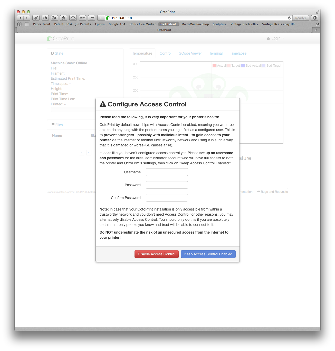

That's it for OctoPrint configuration. Now you can access it from your web browser. Once the Pi is rebooted, launch a browser and type http://192.168.1.10 (again, use your IP address) and you should see the OctoPrint screen:
The first time you do this you will get this access control configuration screen. Select a username and password that you'll remember.
That's it for the hard part. Now you can connect to your printer by selecting the Serial Port and Baudrate in the connection panel in the upper left. Note that the baud rate must match what you have configured in Configuration.h (or in the EEPROM) for your RAMBo (or other) board.

Hello,
I have followed your instructions exactly as shown and I cannot get my OctoPi to connect to my Rostock Max v2. I don't know if maybe the Rambo board is new to the Rostock and OctoPi doesn't have drivers, or what the deal is. The screen on the Max will reboot every couple minutes while it's trying to connect, but nothing every happens. I set the baud rate to 57600 from the LCD menus on the printer and was able to connect to it with MatterControl just fine at that speed.
Any suggestions?
jsnbrgg
Posts: 35
Joined: Wed Apr 29, 2015 9:37 am
Re: My OctoPi setup for MAX
Post by jsnbrgg »
Never Mind, I got it! Apparently it needed to be unplugged for a few minutes and plugged back in.
Thanks anyways! :D
