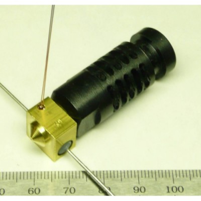

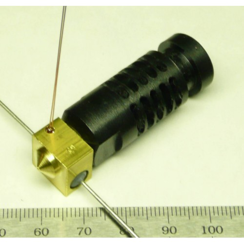

I found this J-Head here in swiss http://www.fabberworld.com/Extruder-und ... e::68.html is this the original J-Head or a Chinese fake?

That is a difficult question to answer because it looks like the real thing with the 5 cooling grooves and all. I have enclosed an image of a "real" J-Head from hotends.com and you canWoolf wrote:okey, then I will buy a J-Head.
see that they look identical. Except for the location of the cooling grooves.

It is the "official" J-Head. If it is not in stock, he only takes new orders on Friday starting at Noon. His time I think.Woolf wrote:maybe its the best when I order on the hotends.com web side.
