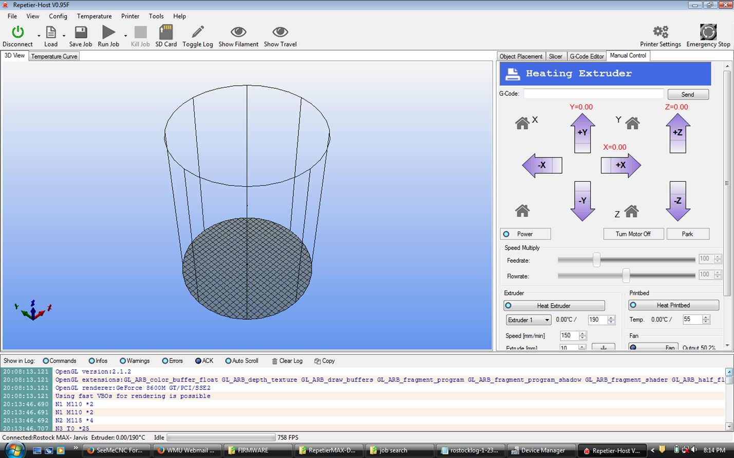

I first got my Rostock MAX up and running on Monday, and I could print from my computer just fine. Tuesday night I finished soldering the LCD to RAMBO board (I somehow missed that step right up until the guide said to plug the LCD in, and I had nothing to plug it into :roll: ).
Since then I can print from the SD card fine, but shortly after I got the LCD working I haven't been able to print (or even fully connect) from the USB.
When I press 'Connect' in Repetier it switches to the green power button/disconnect and seems to think it is connected but it can't quite get the firmware. (I believe the M115 command is failing)
Then when it tries automatically get a temperature reading (M105) it spits out "wXZWH? wait".
While this is happening no other commands work.
Attached is a copy of the log if that helps.

I don't see the 0.83 in in Repetier Host. Only on the LCD screen.
Manually jogging the motors does nothing.
Heating the extruder or the bed does nothing. They have a reading in Repetier Host of 0 C. (thermistors are working because on the LCD the temperature reads as 19.8 and 20)
The machine is not in Dry run mode.
Attached is a screen shot for clarity. (at the top of the screen is where I get the 0.95F for Repetier host)
Re: Can't print with USB/firmware doesn't load
Your Repetier Host is not talking to the Rambo firmware which is usually the result of a mis-matched baud rate.
On the LCD there should be a setting that says configuration, go into it and find something that says baud rate it should be at 250000
Once you verify the number open Repetier Host go to config - Printer Settings and see if the baud rate is also 250000 if it is not 250000
change it so it is then apply it and save. You may have to reboot the computer open Repetier Host and see if it now connects to the firmware.
Let me know.

Baud rates match. I even tried changing both to 256000, still no luck.
