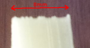

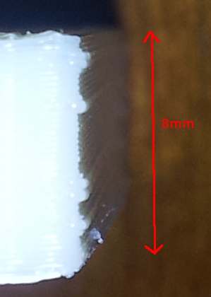

I'm having a similar issue in my just born Rostock Max. Although I have good knowledge on cartesian printers and slicers, I'm noob on deltabots.
Sorry low quality pictures from my phone, but the issue is clear.
As an electrical engineer I don't believe on electrical interference/issues.. maybe some config or mechanical issue..
Info:
- Stock Rostock Max bought on Oct/2013
- ABS at 225ºC
- 0.35 nozzle, 0.2mm layer height, 0.35mm extrusion width
- 3 perimeters (about 20mm/s external and 100mm/s internal)
- 20% infill (100mm/s)
- print from SD Card
- Repetier 0.83
- Cooler on RAMBo to cool the drivers.
The extruder seems to be calibrated, since the top infill looks good.. need some tinkering but I don't think it will cause such layer misalignment.
My aluminum U-joints have a little bit play, but just a little bit.. I mean, about 0.1mm.. I figured out quite impossible to let it friction free and no play AT ALL.
By the way, I think this is the huge drawback of this machine.. they should ship that Trick Laser arms instead of this highly-human-dependent solution.
Cheers.
Alex.

From your pictures I would suspect its over extruding, I'd double check your Extruder calibration.

Nylocke wrote:From your pictures I would suspect its over extruding, I'd double check your Extruder calibration.
But over extruding only on random layers ?!?!? That's weird... Anyway, next step will be fine tuning the extruder.
I don't have the print on hands right now, but I guess the layer is shifted, I mean, one side (in the picture) is outwards and the opposite side is inwards. I need to check that..

The effects of over extruding are misaligned layers. It's not on random layers, it's effects just are more prominent on different layers. It's constantly too much material, and it just moves to the most open space, creating random ridge patterns in the print.

I've been pulling 70 hour weeks at work, so I haven't had much time to play around and wont until the new year. However, I did another print, this time dropping the flow rate, and didn't notice a difference in the shifting.
Just to elaborate, the reason I am skeptical of over extrusion is that the layers that are protruding out of one side are accompanied with an equal indentation on the opposite side. See below:

It was a suggestion, I get what you're saying. Its probably mechanical, lash or friction would be my bet.
Re: Need help reducing interference
Disconnect the belts and check the cheapskates for free movement without any play.
While you have the belts off inspect them and the drive gears. Sometimes the gears
also develop play from the screws working loose.

I'm wondering, if we have some kind of slop/play in the belts/motor/cheapskate, this issue will happens in all layers.. and probably the effector will not travel flat, I mean, parallel to the bed. Otherwise some play in the effector will keep the travel flat and cause similar issue.... need to check... but since daftscience is using magnetic arms, It is not usual play/slop.
