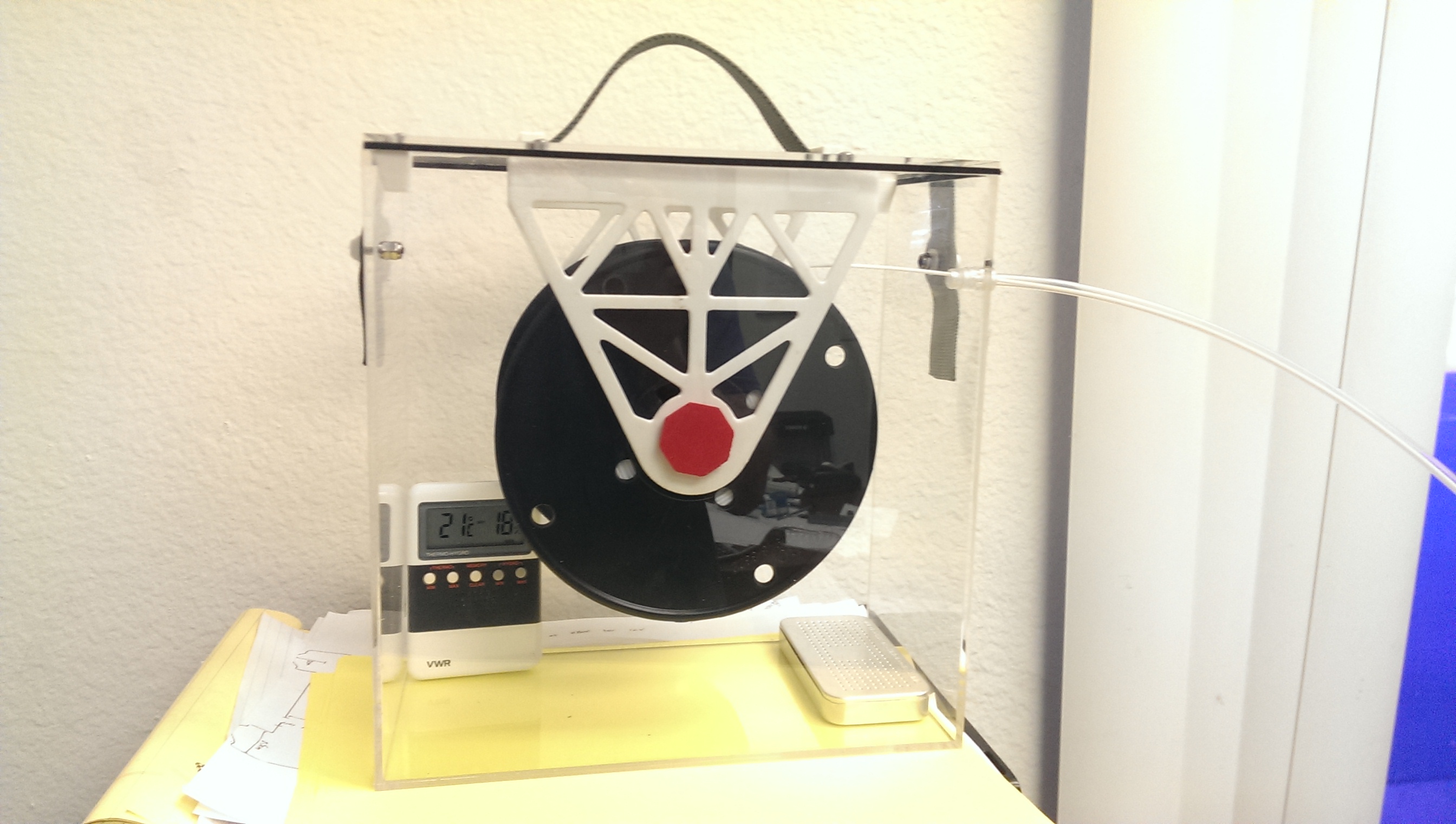

Hey guys, I got busy with honey-do stuff this weekend, so I wasn't able to post everything I was planning on, but I wanted to get this up.
I'll have more information coming soon, but here are the basics...
I've been printing with nylon (both trimmer line and taulman stuff) a lot lately (over 25lbs of the stuff in the past 2 months or so), and while it's by far my favorite material to print with for it's strength, flexibility, and the way it prints, it's an absolute pain in the rear to keep dry. And if it's not dry, it's virtually worthless to print with...
My buddy Dave and I have gone through a couple iterations of drying boxes... 5 gallon buckets, 15 gallon tubs, with light bulbs, without, with desiccant and without, then we started playing with acrylic boxes, and here we are.
The quick and dirty summary is that once dried, nylon has about 18 hours before it needs to be dried again if it's kept out in the open. That's obviously a huge pain to deal with, so we made this box.

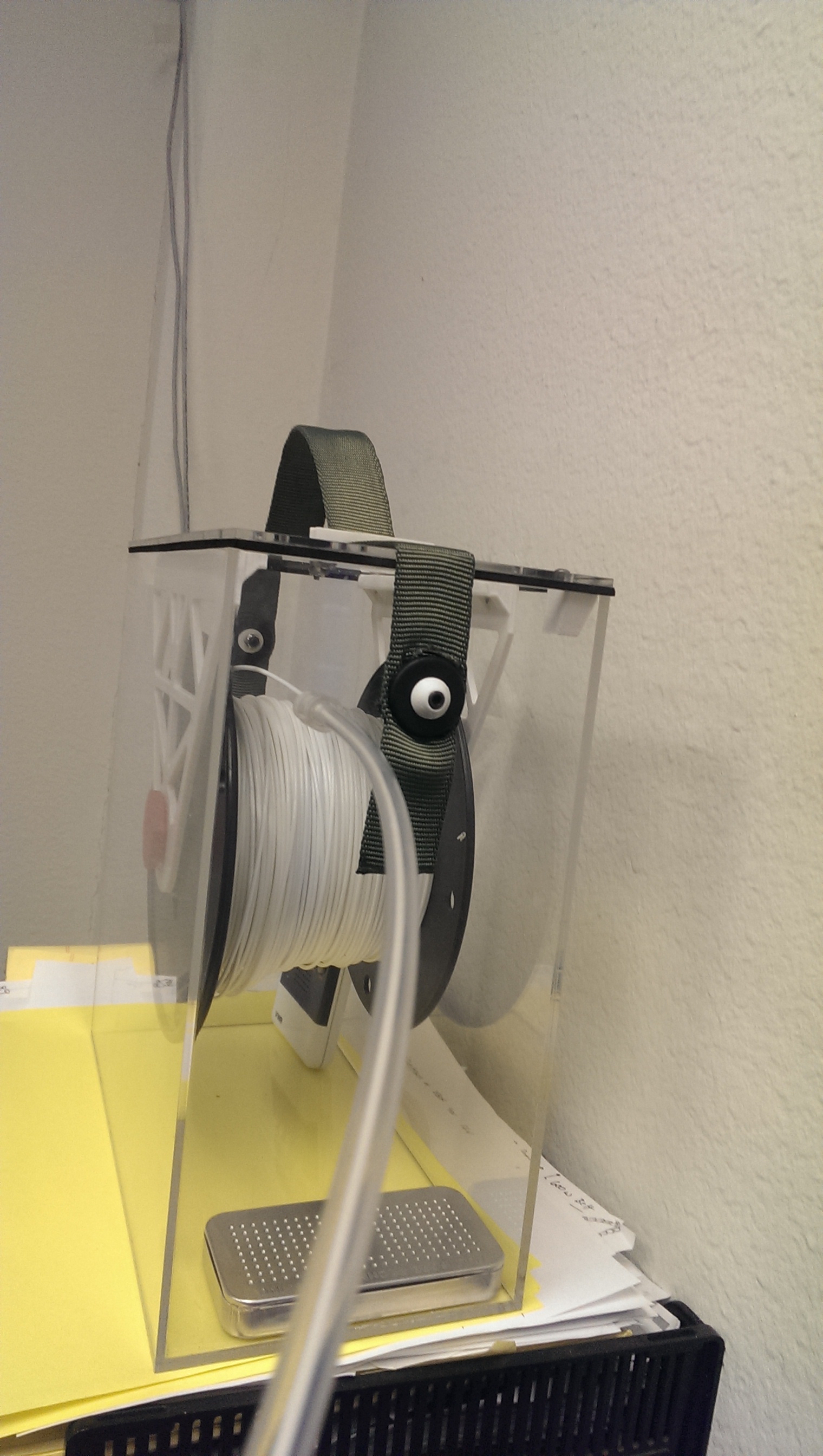

Pretty straightforward - acrylic box, sealed and flame polished, with a sealing gasket on the lid. It uses gravity and the weight of your spool to seal. We printed small registers and mounted them on the corners so that it seats properly when you drop your spool in the box. Nylon straps with rubber grommets mounted in them keep the box closed and give you a carrying handle. There's a sealing connector on the side that you can print out of or close back up when not printing. A 2ft section of tubing prevents any noticeable change in the humidity levels while printing. It will print upright (as pictured) or on its side. It'll handle 1.75 or 3mm filament. We've been printing with 1.75mm for about a month and never had a single issue with feeding. We've also given a couple boxes to a local printing company, and they've been using them for a few weeks with great results. It'll handle virtually any spool out there - we've tried the ultimaker stuff, matter hackers, taulman, and radioshack spools. All the parts are printable, and we'll probably post those on thingiverse some time this week.
It has a rechargeable desiccant pack in it, and we've been monitoring our relative humidity levels (rh%) for quite a while now. We've gotten boxes down to single digits with heat and desiccants, but we've found that it's a bit unnecessary. Once dried properly, keeping it in the box in the 15-25 rh% range (which really just depends on your room temp) will keep the filament properly dry as there is not enough moisture in the volume of air in the box at those levels to negatively affect your filament. You can see that the box pictured is currently at 18% Rh.

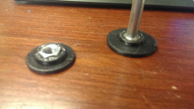

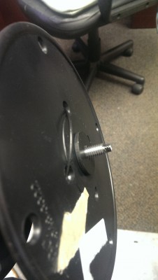

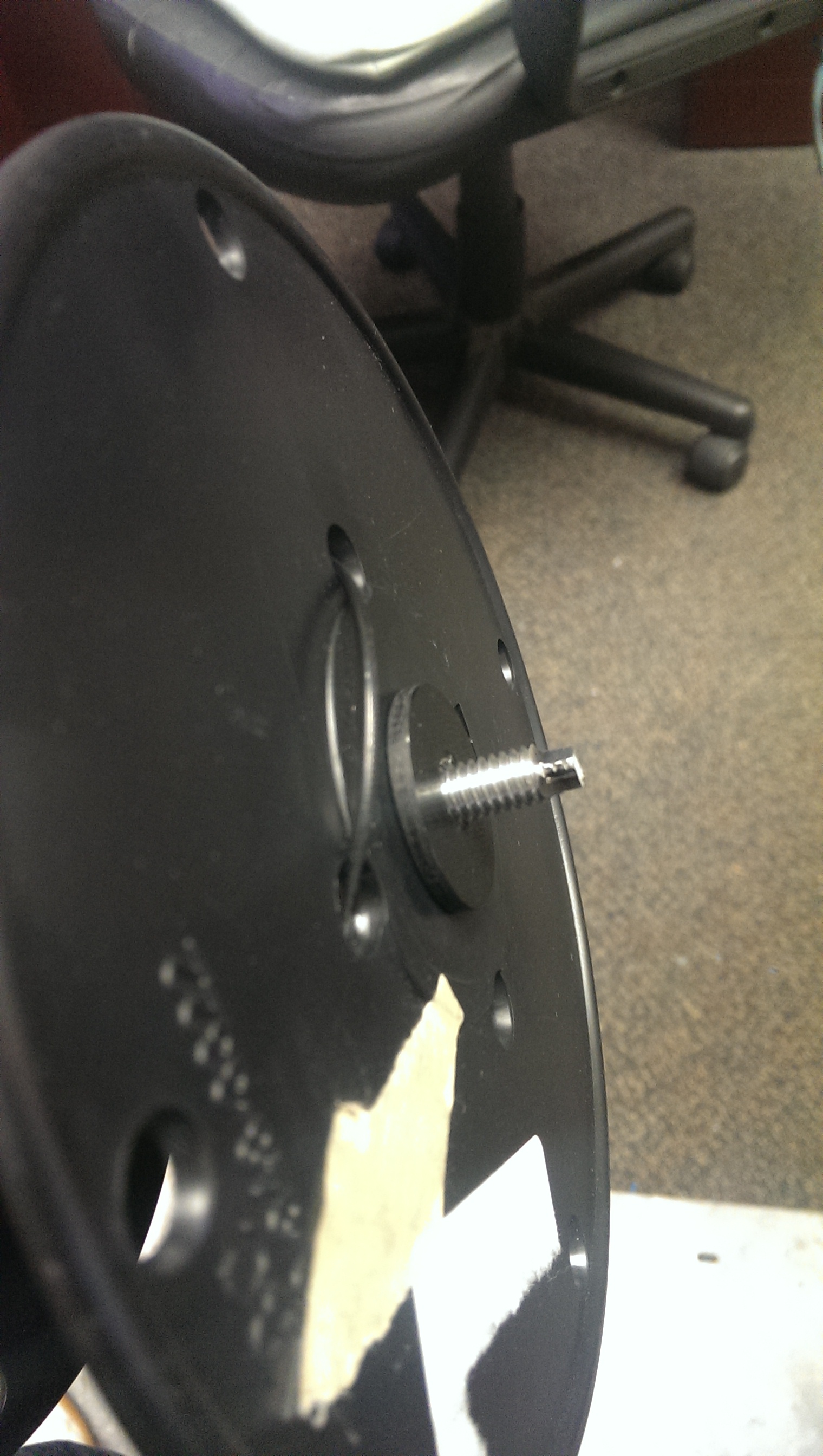

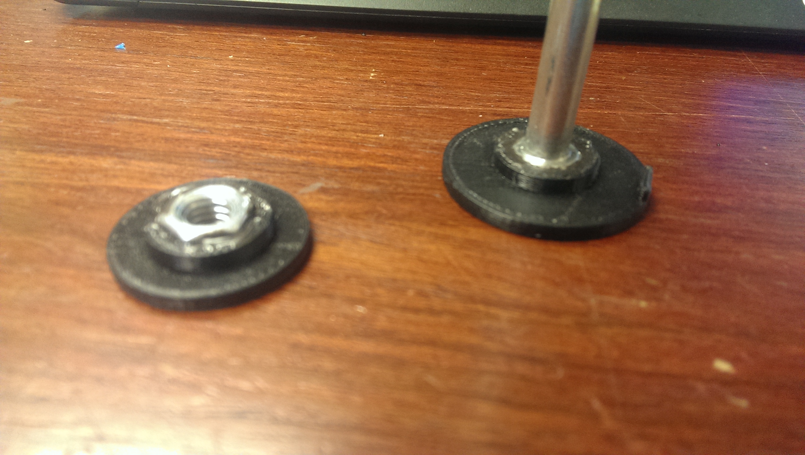

This is the first one I made for using MatterHackers' spools. I have one for Taulman and for Ultimachine spools as well. Basically just a shoulder bolt in a little flange that locks into the spool and centers it. I grinded a small part of the threads off the bolt so that it seats well in the drill chuck.
I put the filament on one of these
Rostock_Spool_holder_-_Nylon.STL
(46.37 KiB) Downloaded 427 times
that's mounted in a bench vice.
Empty spool on the drill, and you've got a super easy respooling setup.
I can post the files for the parts later if you want them.

Re: Filament Dry Box
Now it makes sense, I shouldn't need more files posted, I just needed the general approach to how you did it.
I can handle it now. Thanks, I'll give it a try in the next couple of days and then let you know about the box
