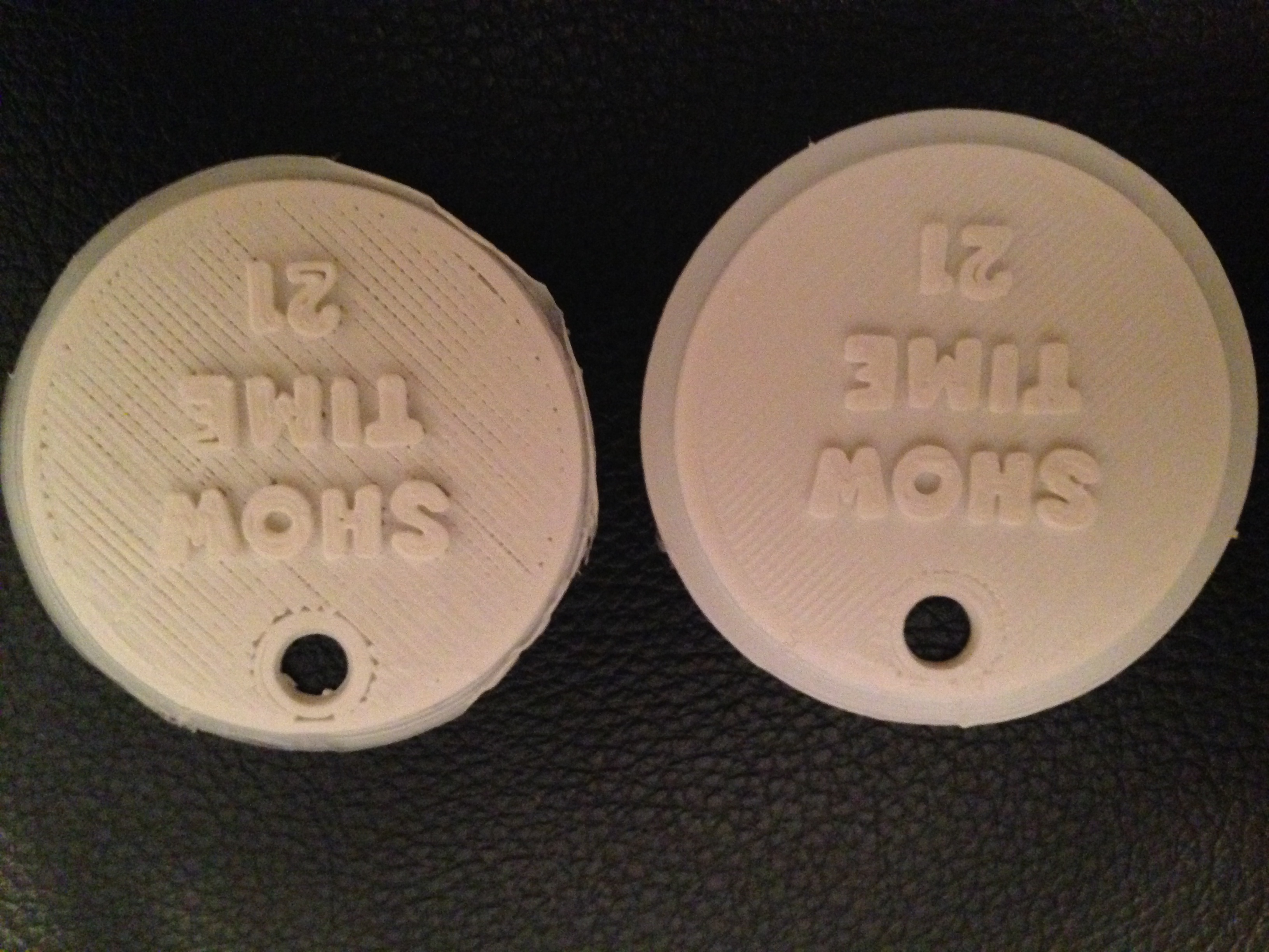

Here is an example of a print from Simplify3D vs. Slic3r.
These were printed back-to-back pretty much. Same ABS, same temperatures.
This is a fan shroud for the E3D hot-end (Guess what I've got coming in the mail :D ).
This first picture shows an issue on the Simplify3D print (left) with the first layer. Note that there are gaps:
[img]http://www.ironcreek.net/photos/_s/1024/Hobby/3D%20Printer/IMG_6079.JPG[/img]
(Click the image for a MUCH larger version)
