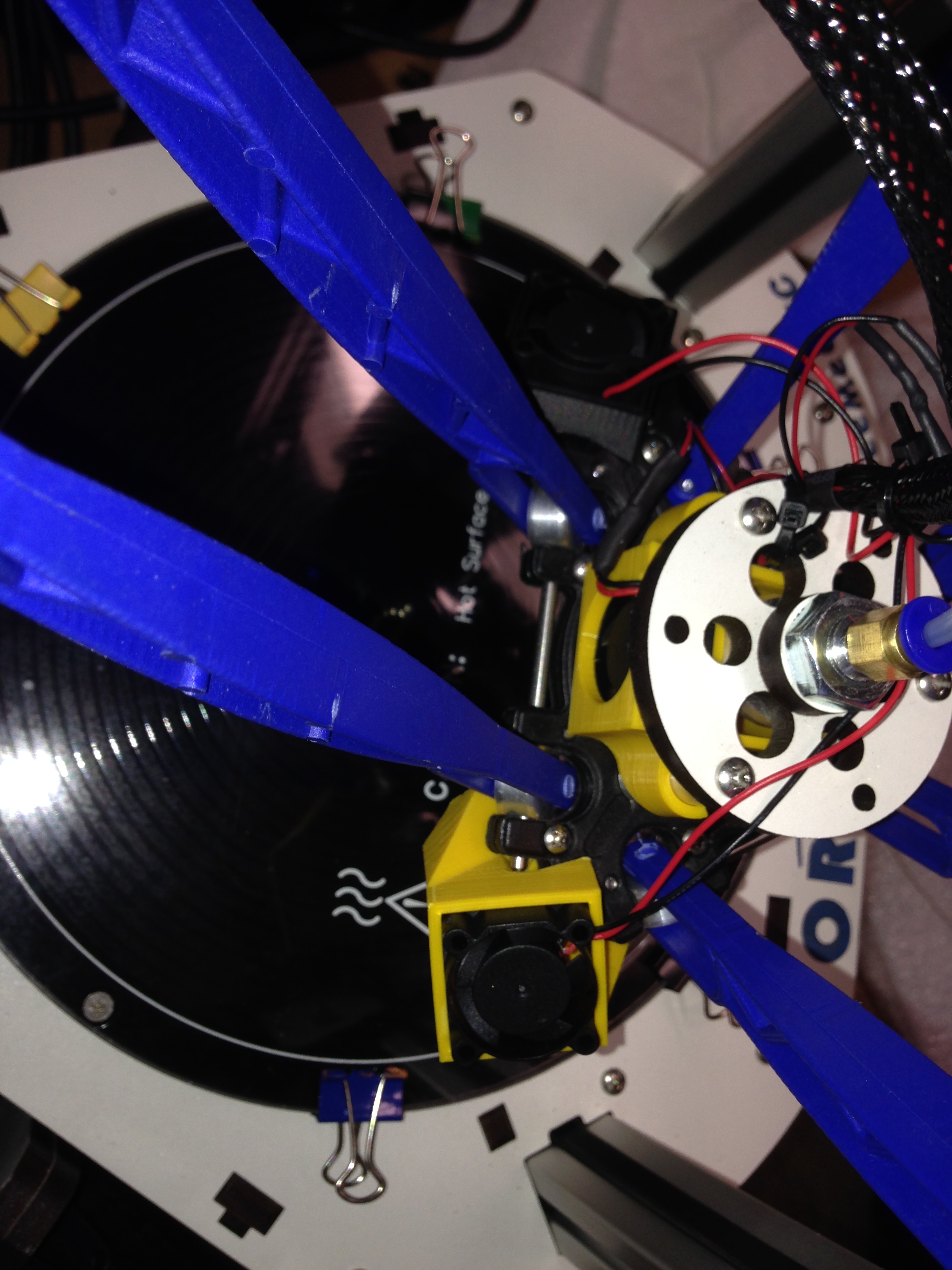

I am still struggling a bit myself with PLA on the Orion. I believe all Orions come with a Peek fan, which is mandatory for PLA printing. You also need cooling fans for small PLA parts or it will turn to mush. My preproduction Orion has a set of accessory wires in the wire bundle so it was easy for me to wire in some fans. I used this design by partdaddy http://repables.com/r/142/ I used two fans wired in parallel as was recommended to me.
So now cooling is fine, still having an issue with inconsistent extrusion (though I haven't had a ton of time lately to puzzle this out, might be something simple I need to change.)

Printed out partdaddy's fan and the fit is a bit tight. I used support material but I'm wondering if it sagged a bit as it won't fit. When I have some more time I'll have to figure something out.
