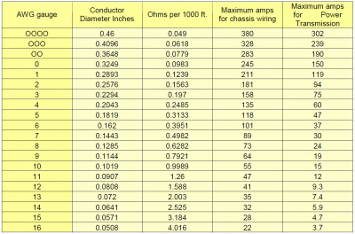

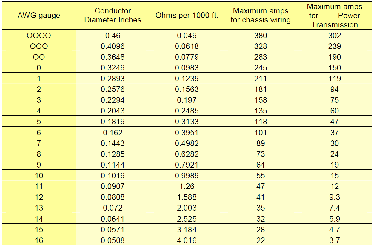

The standards for wire rate 14 guage at 5.9 amps.
http://www.keywolf.com/American_Wire_Gauge.php
The wire may not melt till 30, but the insulation will melt at much lower current,
then short out and ruin everything.
My actual question is: Is my heater bed bad?, although I'm way too long winded.
The manual says it has a resistance of 1.2 ohms, so would run at 10 amps, which I beleive 14 guage can stretch too and survive.
My unit is running at 20 amps.
thanks for your feedback.

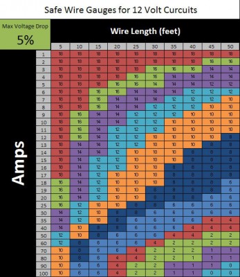

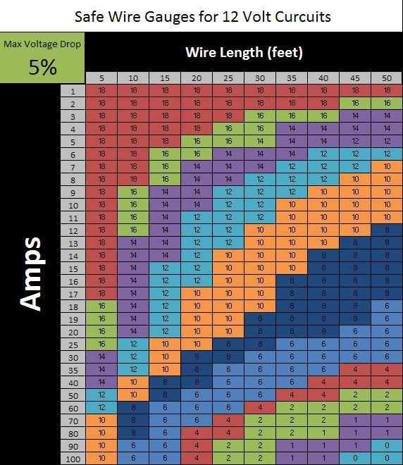

You're looking at a chart labeled for "power transmission", the first assumption of which is LONG wire runs, as in miles, not feet. If you look at the text at the bottom of the same page, you'll notice it mentions the NEC allows 14 AWG to be used for 20 amps in free-air applications, which is what you have. Not that the NEC even applies in this case, but it meets code.
Oops, I didn't link the right chart first try. This one is pretty nice:
[img]http://assets.bluesea.com/files/resourc ... hartlg.jpg[/img]
Now the question that just occurred to me. What's the size of the fuse on the Rambo, and why aren't you blowing it? I don't have a Rambo myself, so I may be ignorant here.

Here is a chart I got from the Internet which shows allowable current at different lengths of wire.
There is a difference between a wire that is running inside romex and one that is running free.
14 guage wire can carry 20 amps AS LONG AS IT IS KEPT REASONABLY SHORT. Look for yourselves
at the various charts available. Everyone wants to use the rules for house wiring and that is not a
fair way to determine ampacity.

5.9 amps for 14 gauge wire makes no sense unless they are using it for transmission lines that can be thousands of feet long.
They use 14 gauge wire in houses fused at 15 amps and those runs can be hundreds of feet. See the other posts.
Your heater bed is not bad.

Eric wrote:You're looking at a chart labeled for "power transmission", the first assumption of which is LONG wire runs, as in miles, not feet. If you look at the text at the bottom of the same page, you'll notice it mentions the NEC allows 14 AWG to be used for 20 amps in free-air applications, which is what you have. Not that the NEC even applies in this case, but it meets code.
Thanks! That is helpful.
However, power transmission means building wiring, not transmitting across states.
No one uses small wires to run power for miles.
House wiring does NOT allow 14 gauge romex to be used for a 20 amp circuit, at any length (Thats code).
As you point out, with free air the wires dissipate heat better than romex,
the extra insulation actually lowers the current capacity,
because it slows down the heat dissipation.
I have never come across a table that ok's 14 gauge for 20 amps at any length.
So, I do feel better.
