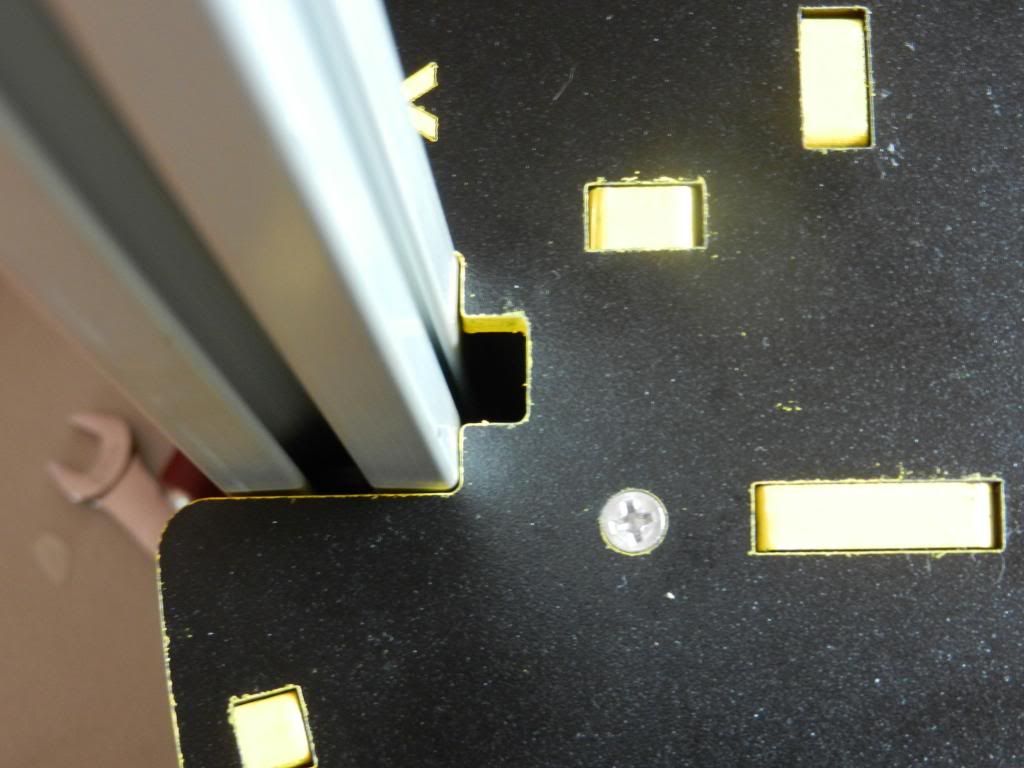

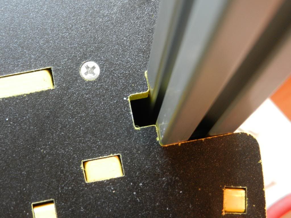

I'm just finishing installing and squaring my towers and I am finding it difficult, if not impossible, to get an even gap on the 3 legs at the base. Essentially, when square, the towers have no gap at all on 2 sides and only the slightest on the other. There seems to be no in-out movement available when they are loosened enough to move.
I'd appreciate it if some of you veterans would take a look at these pics and let me know if I need to keep trying to adjust this. I am tempted to call it good and move on.
X Tower:
[img]http://i243.photobucket.com/albums/ff27 ... ce5283.jpg[/img]
Y Tower:
[img]http://i243.photobucket.com/albums/ff27 ... 979dde.jpg[/img]
Z Tower:
[img]http://i243.photobucket.com/albums/ff27 ... e55391.jpg[/img]
X Tower:
Y Tower:
Z Tower:

This is looking pretty darn good to me personally.
Re: Advice needed
In my experience Gaps are the least of your worries. Concentrate on squareness. It helps to make sure each of the three pilars are equidistant from eachother, there is a fixture on thingaverse that can help.
Re: Advice needed
They look fine. What is important is that they are perfectly square to the base.
Re: Advice needed
This is what I use: http://www.thingiverse.com/thing:147456
