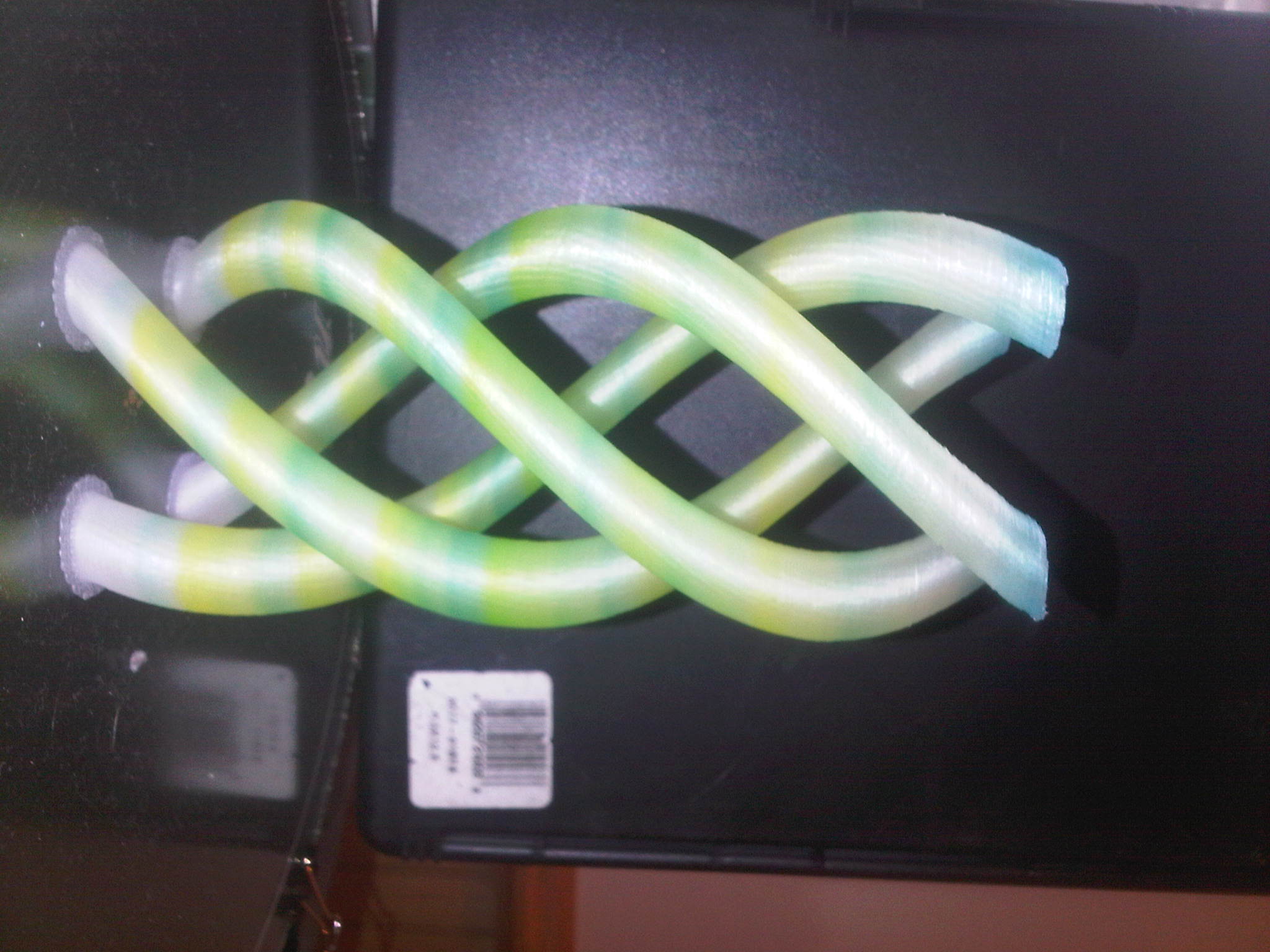

Had to go to work aboit 80% done @ 9
[img]https://fbcdn-photos-b-a.akamaihd.net/h ... 2095_n.jpg[/img]
arrg after printing successfully I get home this morning and after the bed cool they released from the bed and fell over and they look really good....... guess i will have to print so I am home before the bed cools to get a picture.
[img]https://scontent-b-dfw.xx.fbcdn.net/hph ... 2711_n.jpg[/img]
well next try was failure
[img]https://scontent-a-atl.xx.fbcdn.net/hph ... 5439_n.jpg[/img]
then we have completion
[img]https://scontent-b-atl.xx.fbcdn.net/hph ... 3007_n.jpg[/img]
[img]https://scontent-a-atl.xx.fbcdn.net/hph ... 7352_n.jpg[/img]
ABS
generated by Slic3r 1.0.0RC1 on 2013-11-20 at 15:01:16
; layer_height = .2
; perimeters = 2
; top_solid_layers = 5
; bottom_solid_layers = 5
; fill_density = 0
; perimeter_speed = 30
; infill_speed = 30
; travel_speed = 200
; nozzle_diameter = .5
; filament_diameter = 1.75
; extrusion_multiplier = 1.0
; perimeters extrusion width = 0.60mm
; infill extrusion width = 0.60mm
; solid infill extrusion width = 0.60mm
; top infill extrusion width = 0.60mm
; first layer extrusion width = 0.60mm
G21 ; set units to millimeters
M107
M190 S90 ; wait for bed temperature to be reached
M104 S218 ; set temperature
G28 ; home all axes
M109 S218 ; wait for temperature to be reached
G90 ; use absolute coordinates
G92 E0
M82 ; use absolute distances for extrusion
first layer
bed 90
hot end 218
other layer
bed 100
hot end 220

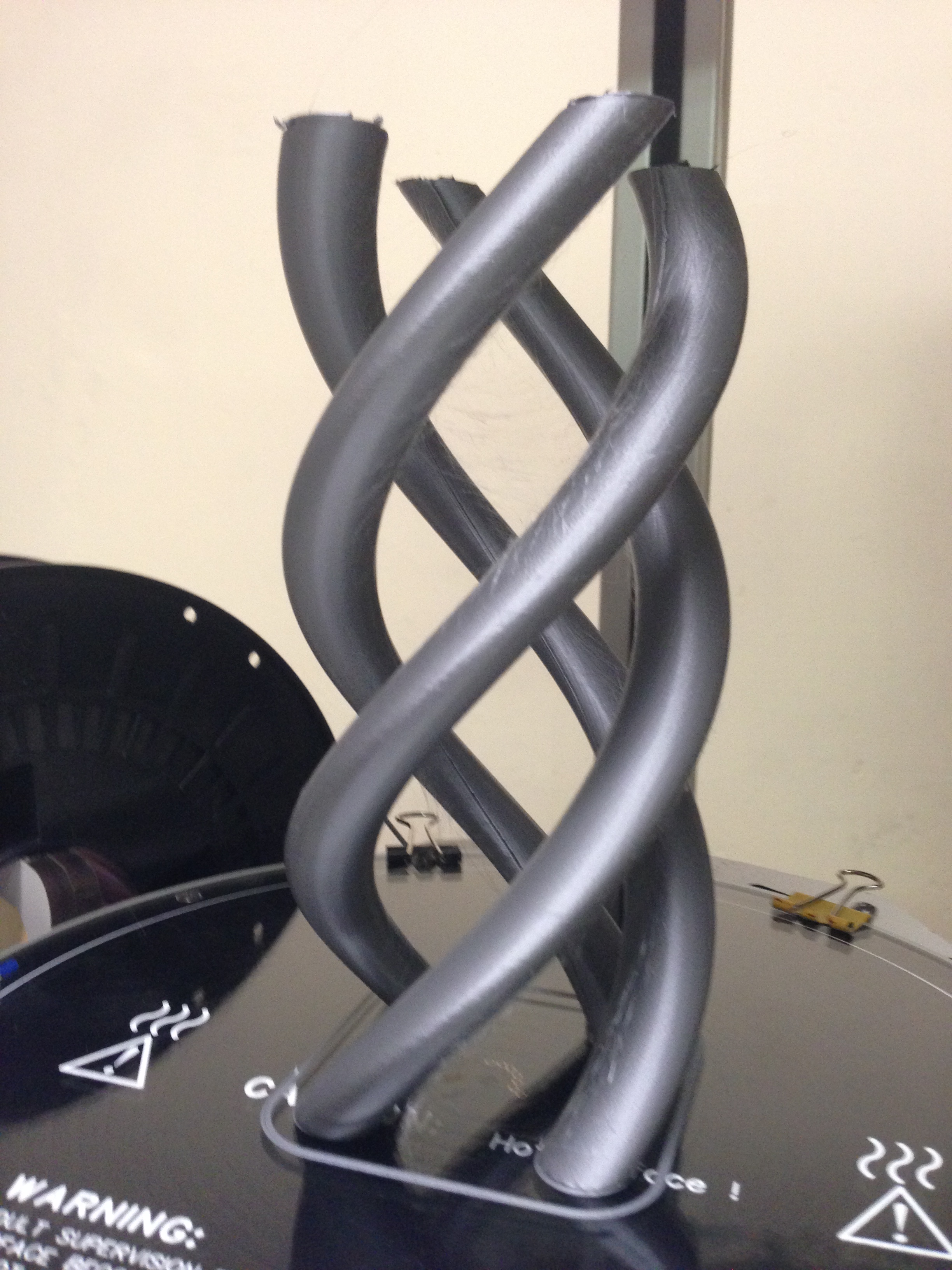

Post by bvandiepenbos »

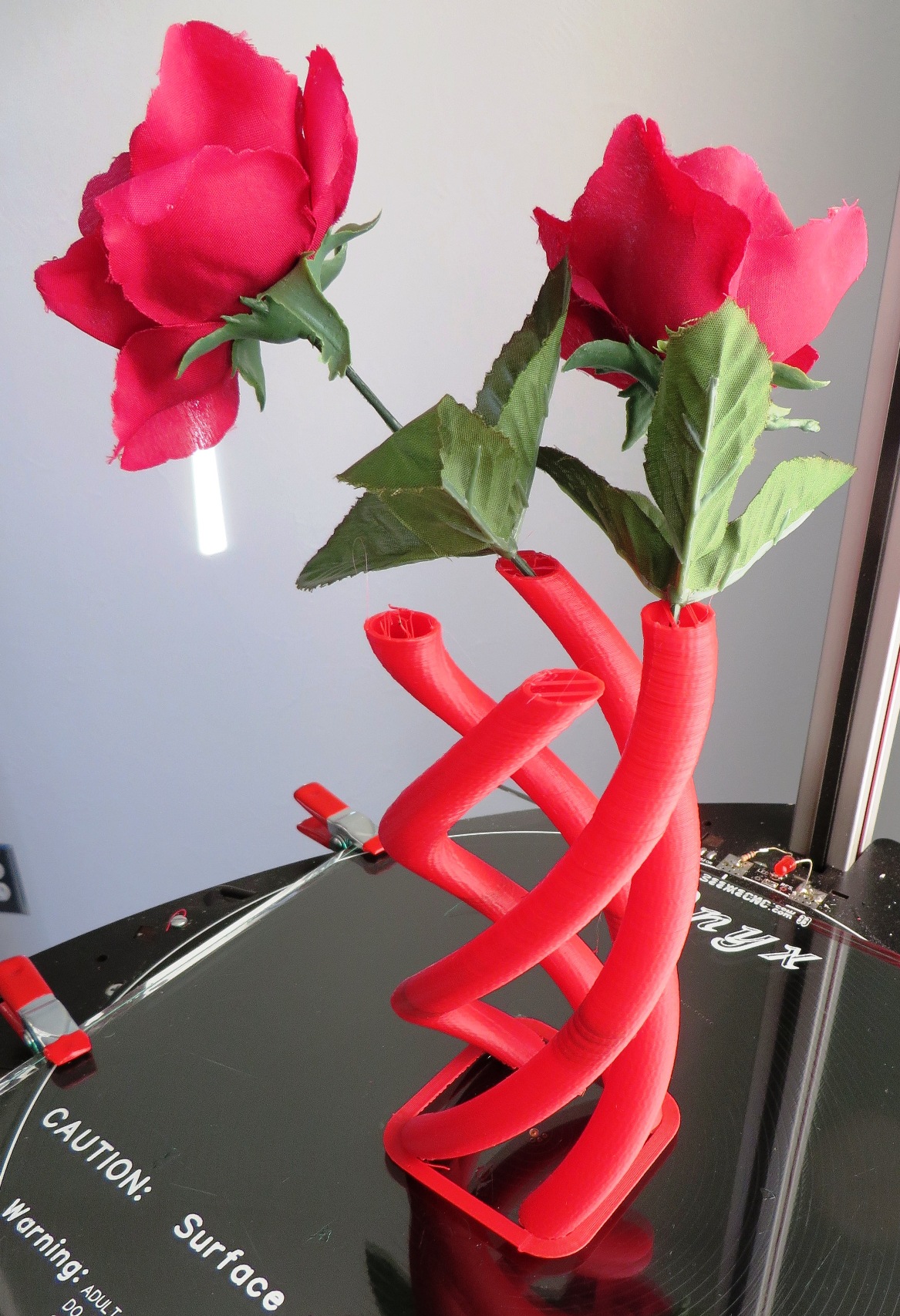

I wanted to use if for a unique vase for my wife.
Slic3r .9
ABS .2 layers, 3 perimeters, hollow
2 layer 10 loops skirt set at 0 space
slic3r .ini file attached and gcode in zip file
; generated by Slic3r 0.9.10b on 2013-11-12 at 21:45:07
; layer_height = .2
; perimeters = 3
; top_solid_layers = 0
; bottom_solid_layers = 4
; fill_density = 0
; perimeter_speed = 65
; infill_speed = 80
; travel_speed = 250
; nozzle_diameter = 0.35
; perimeters extrusion width = 0.47mm
; infill extrusion width = 0.47mm
; solid infill extrusion width = 0.47mm
; top infill extrusion width = 0.46mm
; support material extrusion width = 0.47mm
; first layer extrusion width = 0.49mm
M107
M190 S85 ; wait for bed temperature to be reached
M104 S215 ; set temperature
G28
G1 Z325 F7500.0
M109 S215 ; wait for temperature to be reached

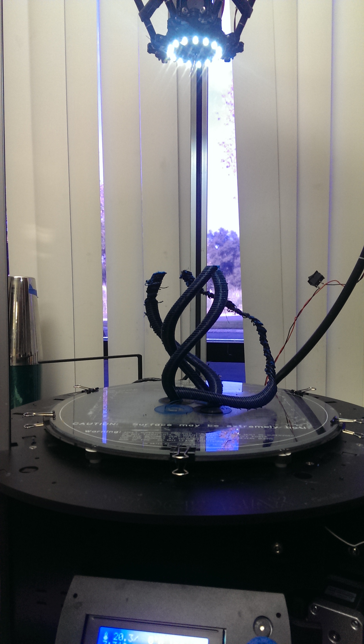

Post by cope413 »

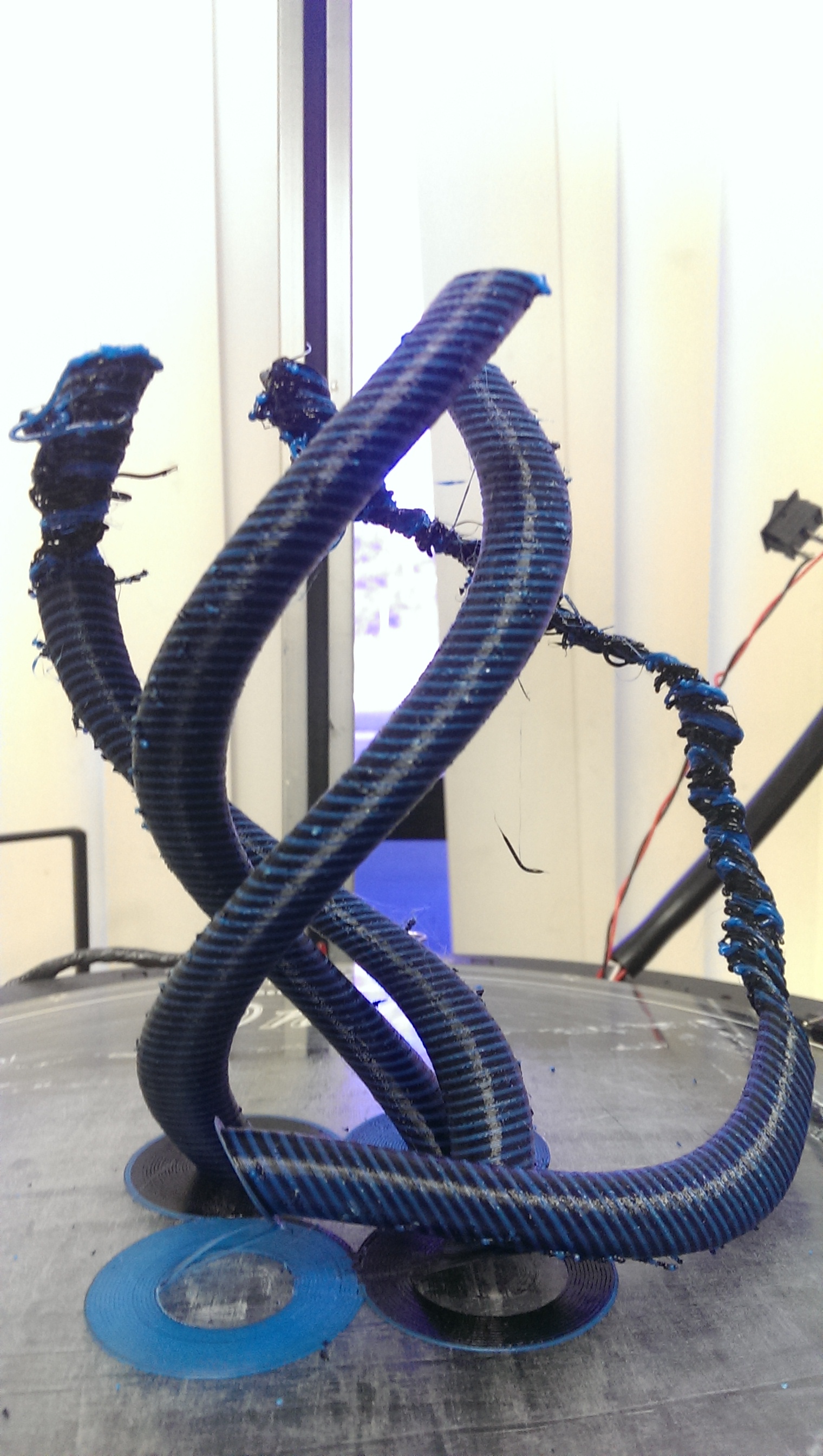

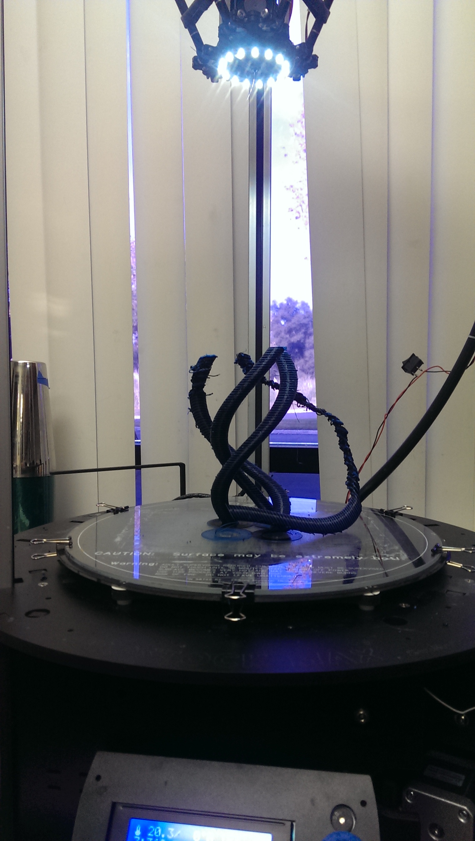

I'll go ahead and claim the filament now... haha
Even with the brim, 2 of the towers tipped over during the print, but somehow managed to keep printing. I'd bet this can't be replicated...
It's trimmer line that's been dyed.
.6 nozzle
.25 layers
3 perimeters
30% infill
Re: November Print Challenge
That would make a great Madusa's hairdo.

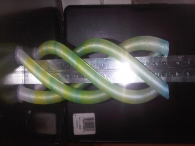

ok here goes 4th print at 1:45min till finished Puppy ran into computer and buffer wigged out no recovery possible.
5th print this morning and we Have a WINNER
Head 211 degrees
heated Bed 100, Glass plate Auquanet hairspray ( weird issue ran perfect till 45min left then dropped to 93 no reason but thank the 3d gremlins didn't attack)
Clear ABS ( colored Sharpies at irregular spacing to give effects seen)
No Fan
Dead on 150mm winner
LIFETWISTSYOUUP_LOWRES kiss clr grid.gcode
g-code
(6.74 MiB) Downloaded 609 times
have mini video of it finishing last 3min but dont know how to upload that??

Wildideas, have you seen any issues with the coloring affecting layer sticking? And what kind of marker are you using?
wildideas1
Posts: 99
Joined: Wed Jun 06, 2012 3:59 pm
Post by wildideas1 »
no issues with stick at all i have used sharpie and other permanent markers from my wife creative memories stuff

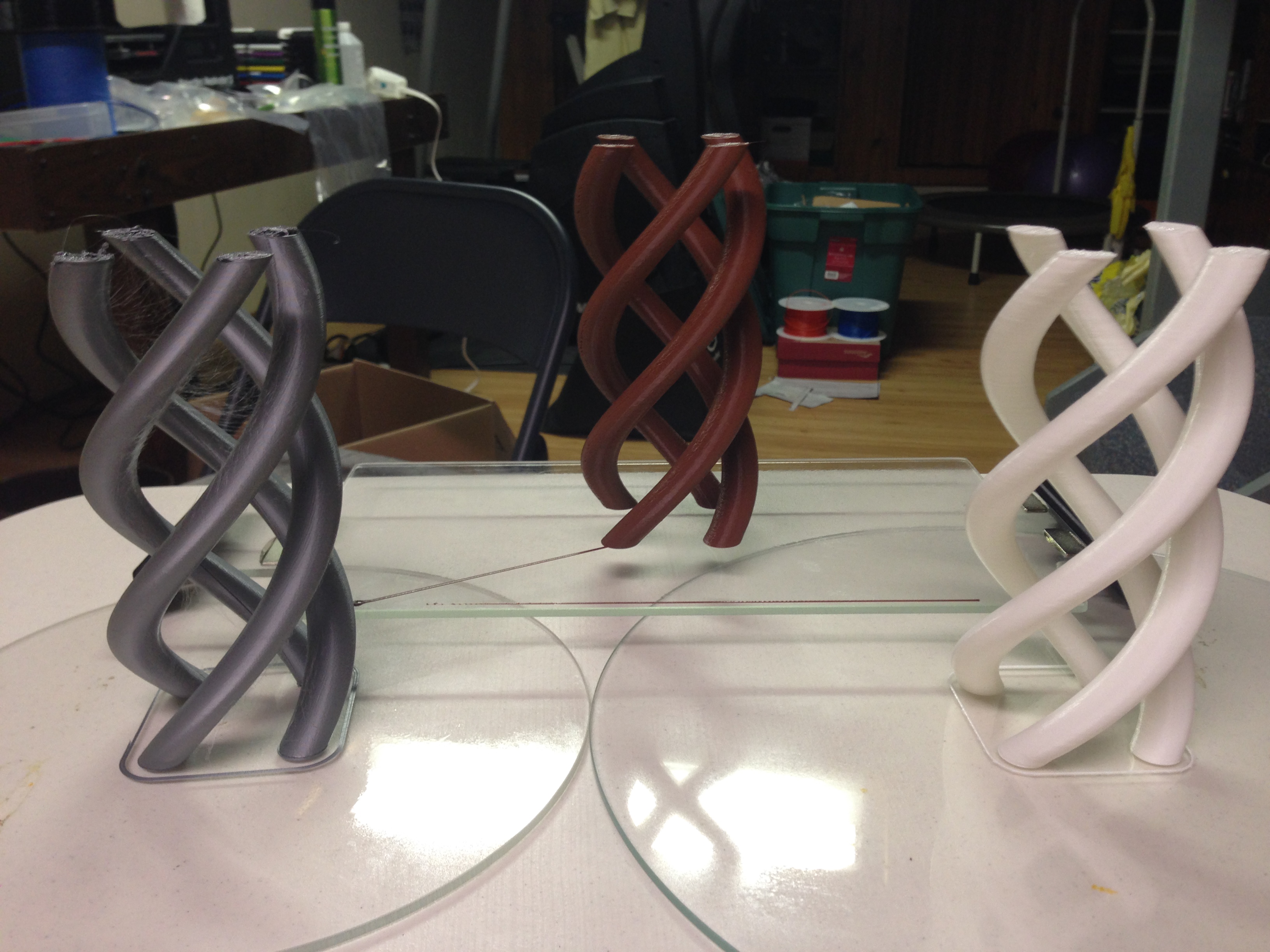

Decided to put all my printers to the test.
First up, the Orion.
I used a newer soft PLA from Printed Solid. It is a bit expensive but I like it a lot. I am still having issues printed standard PLA on my Orion but this soft PLA worked without issue.
Used Garnier Fructis extreme hold on the build plate (not heated)
.2 layer, one perimeter, no infill.
I made the mistake (on all 3) of not printing as a vase and the top fill nearly took down the print at the last minute, but it held.

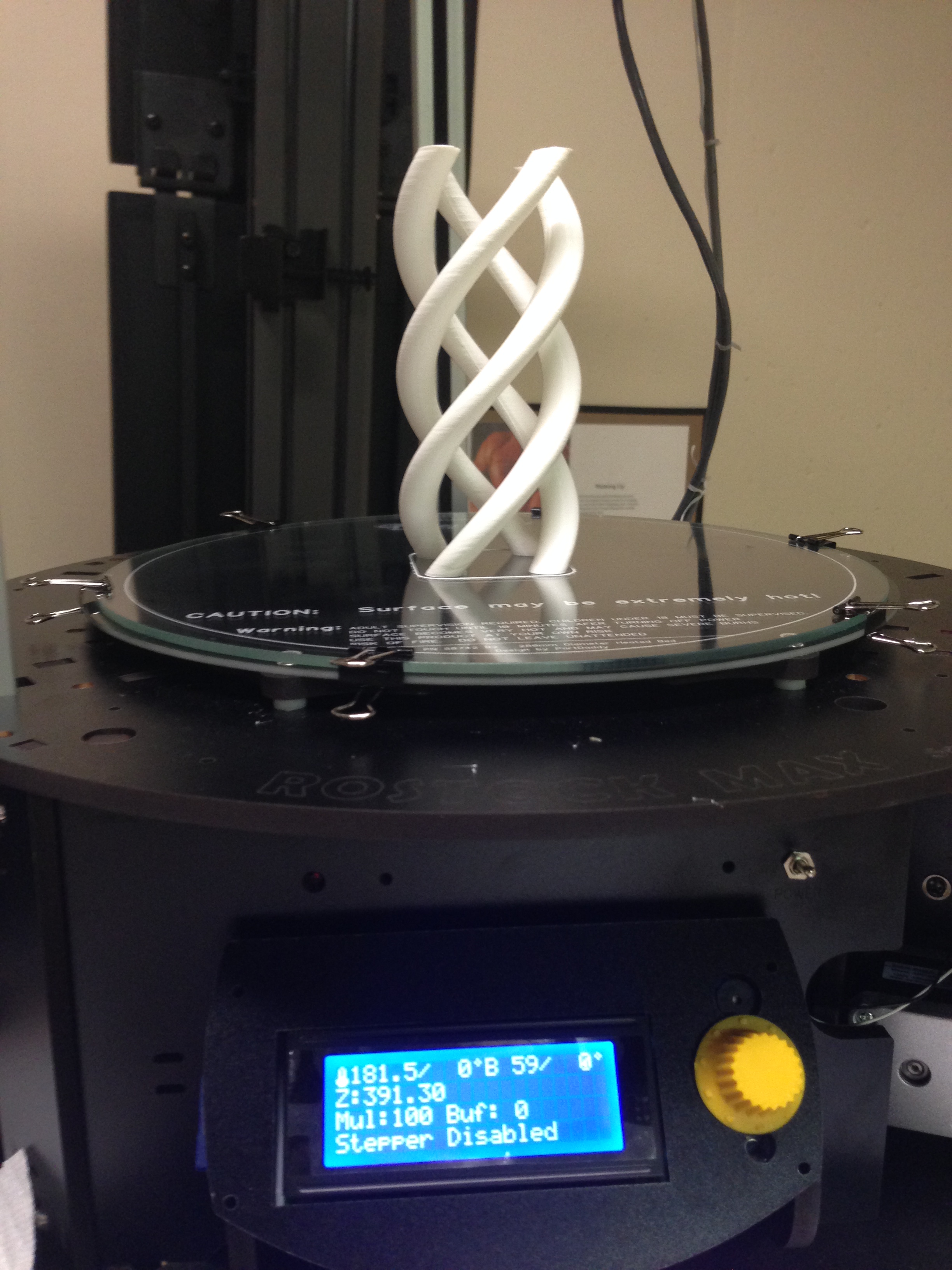

Next up the "Miracle Max" (name to be explained in another post)
Ultimachine white PLA
.2 layer, one perimeter, no infill, bed 60C, with Garnier Fructis
Couldn't be happier with this print. I did my first print ever on this machine on Saturday and on Tuesday to put this out was beyond expectations. Had the same issue as the Orion with nearly knocking the print off on the roof at the end.

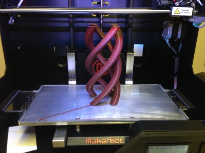

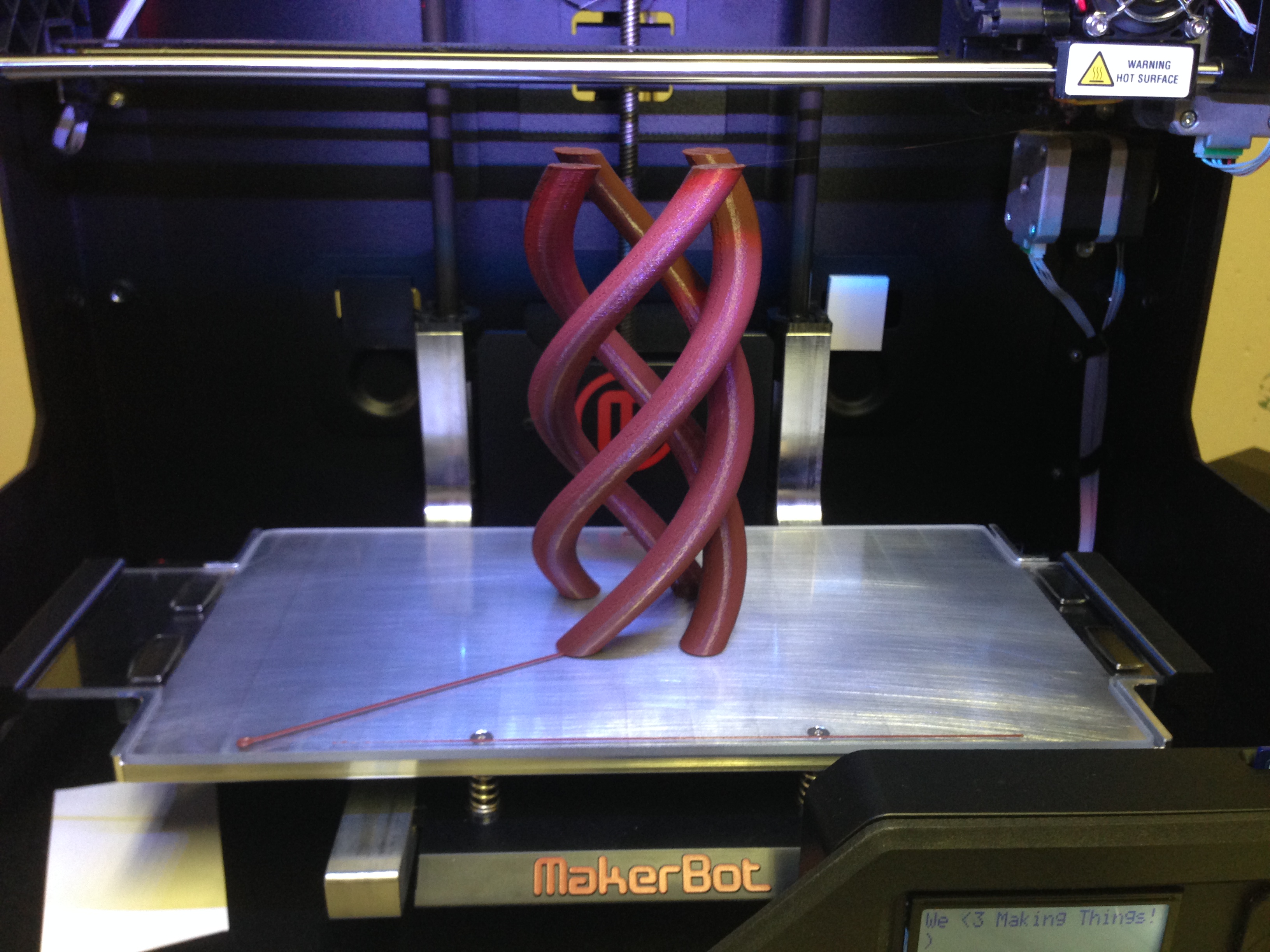

Finally, just for sake of comparison and not an official entry, on my "Printer that must not be named"
Ultimachine brown pla, same stuff I used for my dragon clock http://www.thingiverse.com/thing:184736
As the testament to the holding power on the Garnier Fructis I took this photo the next morning.
jmpreuss wrote:It is their colorfabb pla/pha filament. "soft" may be a bit generous to describe it, it is a bit more flexible than just straight pla.
And thank you for not naming that machine called MAKERBOT. You forgot to cover the nameplate.
We just hope the picture does not give us a virus or something. :)
