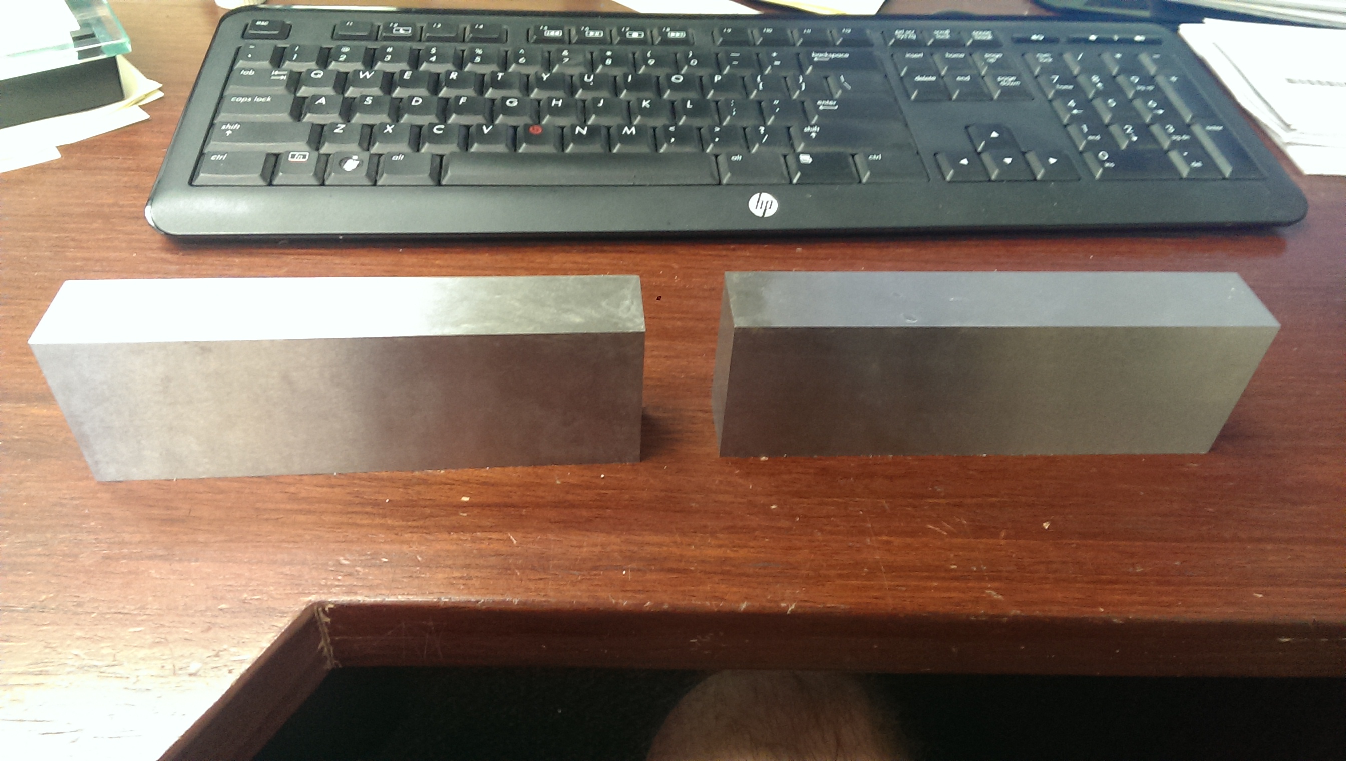

If you really want to test whether or not your machine is level and there is no doming, you should use a machinist's parallel or 2 (with no greater than .00002in/in variance), and trace your hotend along that. No cheating and keeping your finger on the on/off switch either. Just set the gcode and let it go.
I got the parallels... not sure if I have the balls (or the calibration) to do it yet
Re: Auto Level - Auto Calibration Talk
I know I wouldn't have it in me to drag a metal nozzle across a machinist's parallel. Then again I don't think I need to worry about ever acquiring one I could do that to.
