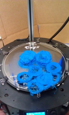

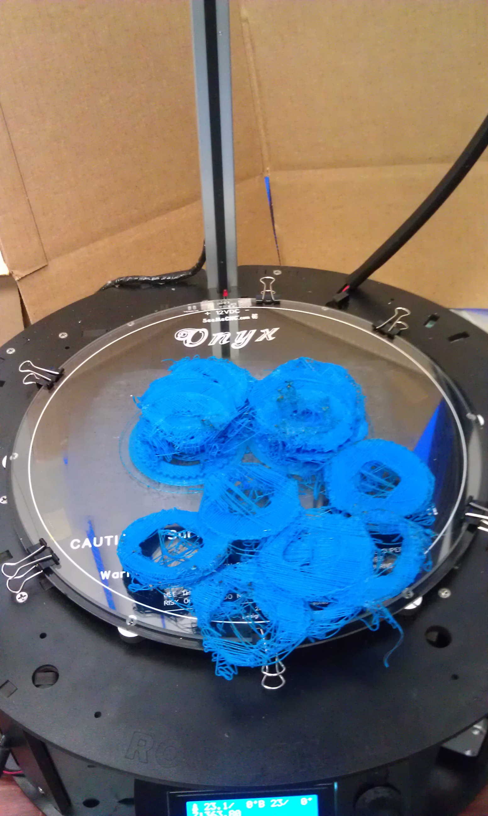

My first Nylon fail!
It was a good one... I think it was caused by a tangle in the spool that caused belt skips but then released and kept printing...
Looked pretty fun when I came in this morning.
Not really even that mad

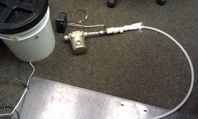

Also, dry it, dry it, dry it!
I went a little overkill with my dryer box, but I had fun with it...
5 gallon bucket with a gamma seal lid. Got my hands on a super mist separator and a heated compressed air coupler. Hooked it up to a PID with a thermocouple. PTC inlet into the bucket, 1 way valve out of the bucket that releases at about 20psi.
A bed of about 1 inch of rechargeable desiccant at the bottom of the bucket. Spool of nylon sits on the desiccant.
Set the thermocouple to 200F for the alarm, and I pump the ultra dry, hot air into the bucket for an hour or 2.
If anyone knows of a more awesome way to dry filament, I'm all ears

Any source for the 5 gallon bucket with the Gamma seal lid? I've never seen those before.cope413 wrote:Also, dry it, dry it, dry it!
What about air leaks where the handle penetrates the bucket?

Home depot -
http://www.homedepot.com/p/Leaktite-5-G ... kSK4YYm18E
Handle doesn't go into the bucket, it's got a molded block on the outside that the handle pops into.
I don't want to experiment past 20psi - no need. Filament dries really fast

Oh and I jb welded all the inlets that I installed. Pretty much the most awesome 5 gallon bucket I've ever seen.
I told my wife that I was spending last weekend on my drying chamber... she walked out to the garage after about 5 hours and said, "I thought you said you were working on a drying chamber. That looks like a bucket. What are you doing?"

Had to adjust my pressure down to 12psi...
It lasted a few sessions at 20, but eventually the lid popped off - couldn't handle the pressure. Had to replace it because it bent the tabs on the lid and it won't seal well anymore.
A couple observations from my drying trials...
1) While it may take 18 hours to fully saturate with moisture, 3-4 hours in 40-50% humidity is enough to negatively affect print quality
2) Well dried filament is smaller (duh) than wet filament - I had to adjust my flow rate up a bit to correct for it.
I'm in love with this nylon. It's awesome stuff.

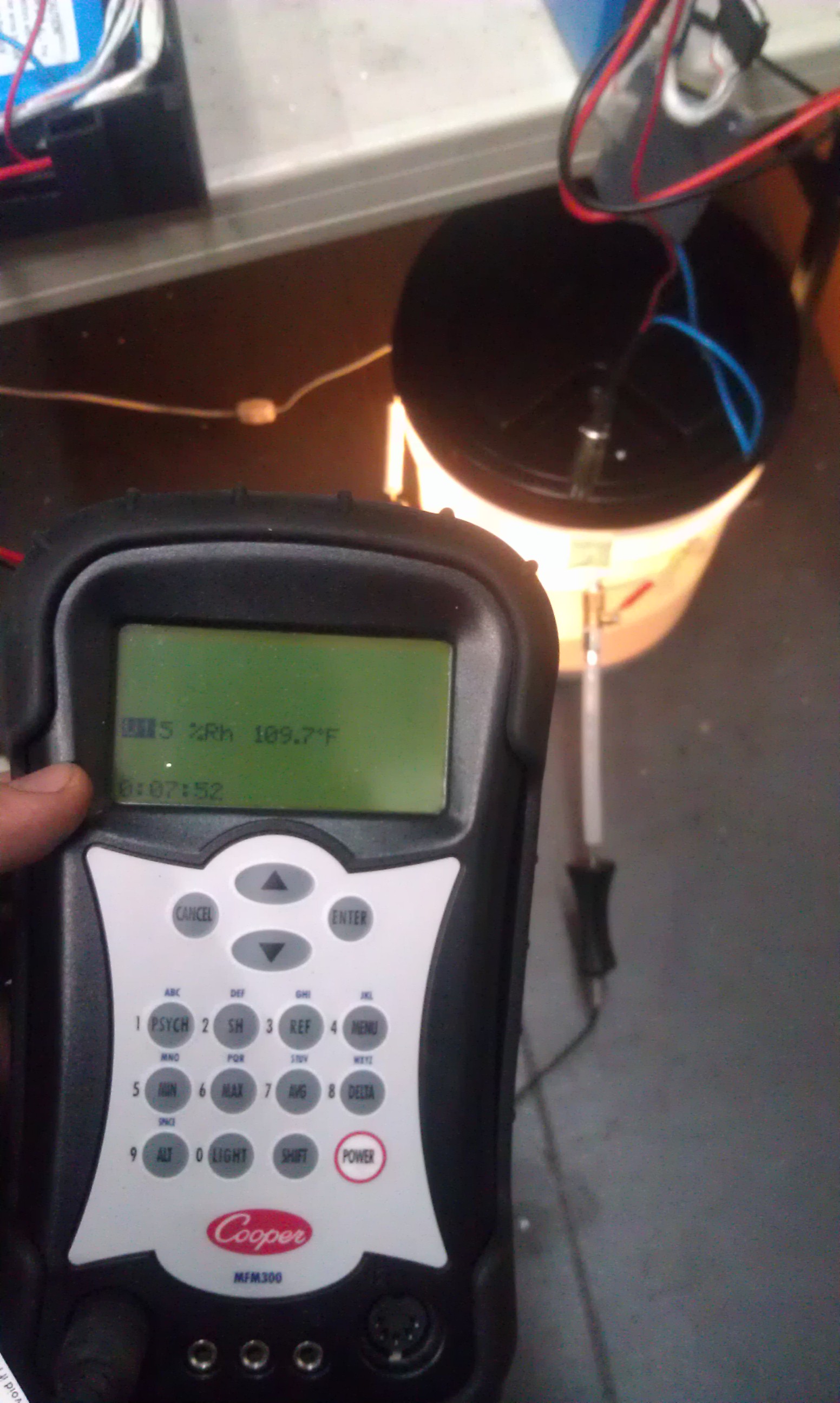

I got my hands on a nifty piece of equipment last week when I got my dryer up and running.
Been running some tests on filament moisture levels and here's what I've found...
I tested 4 different filament samples.
All filament was thoroughly dried by baking in an oven for 18 hours at 185F.
Control sample was left out in the open air for 72 hours
Sample 1 - airtight bucket with desiccant, no heat - 72 hours
Sample 2 - airtight bucket with desiccant, 40w incandescent bulb - 72 hours
Sample 3 - airtight bucket with desiccant, heated and compressed air flow through the bucket at 3psi, 40w incandescent bulb. PID controlled compressed air heater set to 130F - once up to temp, air would kick on every 30-40minutes or so and would take about 6-8 minutes to turn back off.
My shop's average relative humidity over the past week was 44.6%.
I measured the Rh% of each bucket, and then immediately printed a cal-cube with it.
Control Sample:
Rh% 44.6
When left out for, the trimmer line still prints, but it gives prints a very different finish. It's actually kind of cool, but it's noticeably different. I didn't noticed any major issues with layer adhesion, but I definitely got "pops" which left some uneven spots. There was also a fair amount of blobs on corners, and on small radii I noticed a lot of stringing. Nothing that ruined the usability of a print, but definitely not ideal.
Sample 1:
Rh% 31.4
It printed cleaner than the stuff left out in the open, but not a whole lot. There was less blobbing on retracts, but still stringing and "pops" while printing.
Sample 2:
Rh% 18.3
Printed very clean for the first 30-40 layers. Beautiful. No popping, no blobs - just perfect. Started to get messier as it went. I surmise that the outside of the spool dried thoroughly and the filament on the inside winding didn't/
Sample 3:
Rh% 4.8
Perfect print. When I print with this stuff, I never want to print with any other filament again. Great appearance, prints like butter, and amazing strength. Great bridging ability, and excellent surface finish.
Preliminary conclusions:
Nylon absorbs a LOT of water if you let it. There's likely a sweet spot between my Dryer Bucket of Justice and Awesomeness and the simple bulb-in-a-bucket. While I'm thrilled with my results, it's not really practical. I suspect that keeping Rh around 15% with some heat will produce the same results if the filament is allowed to dry for longer periods of time. Ideally, the filament would feed from the bucket to the extruder without being exposed to the air.
I'll post some pics of the prints when I get my SLR and booth set up. Tough to show the differences in surface texture with my phone.
