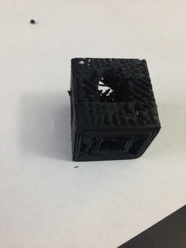

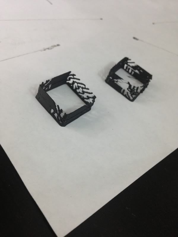

Needing someone to give me pointers just tried some calibration cube prints on the Mac side now I'm getting bad prints.
[img]http://i292.photobucket.com/albums/mm22 ... d7a821.jpg[/img]
[img]http://i292.photobucket.com/albums/mm22 ... 03c271.jpg[/img]
Or should I say worse than before still have not got it right after three months smh

For that print what is your print speeds, print temp, layer height and nozzle diameter?
If everything is working right (extruder isn't gunked up, no blockage/partial jams, etc) then off hand it looks like you are printing too fast at too low a layer height and possibly without enough heat depending on your material.

Lordbinky,
I believe I have the standards set in the guide.
Print speed is:
100
[img]http://i292.photobucket.com/albums/mm22/tc3jg/ScreenShot2013-09-01at73740PM_zps25f9b64c.png[/img]
Printing ABS-
EXtruder temp is 225
Heated bed temp is 100
Layer height is below
[img]http://i292.photobucket.com/albums/mm22/tc3jg/ScreenShot2013-09-01at73431PM_zpse91f00ce.png[/img]
Nozzle is the stock nozzle size. I believe its .5
I dont think there is any blockage. If I just use the command extrude when it is warmed up the filament comes out smooth.
Print speed is:
100
Printing ABS-

ok guys and gals I think I got it fixed....

Awesome. So did find what was wrong and did you do anything to fix it or did it just clear up?
Re: Host Crashing
I think it was seeing my filament size as 3nm when it's bout 1.75
