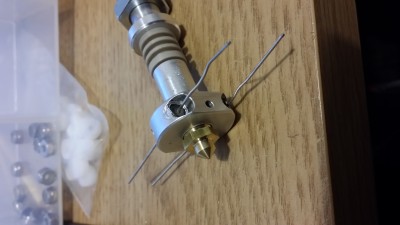

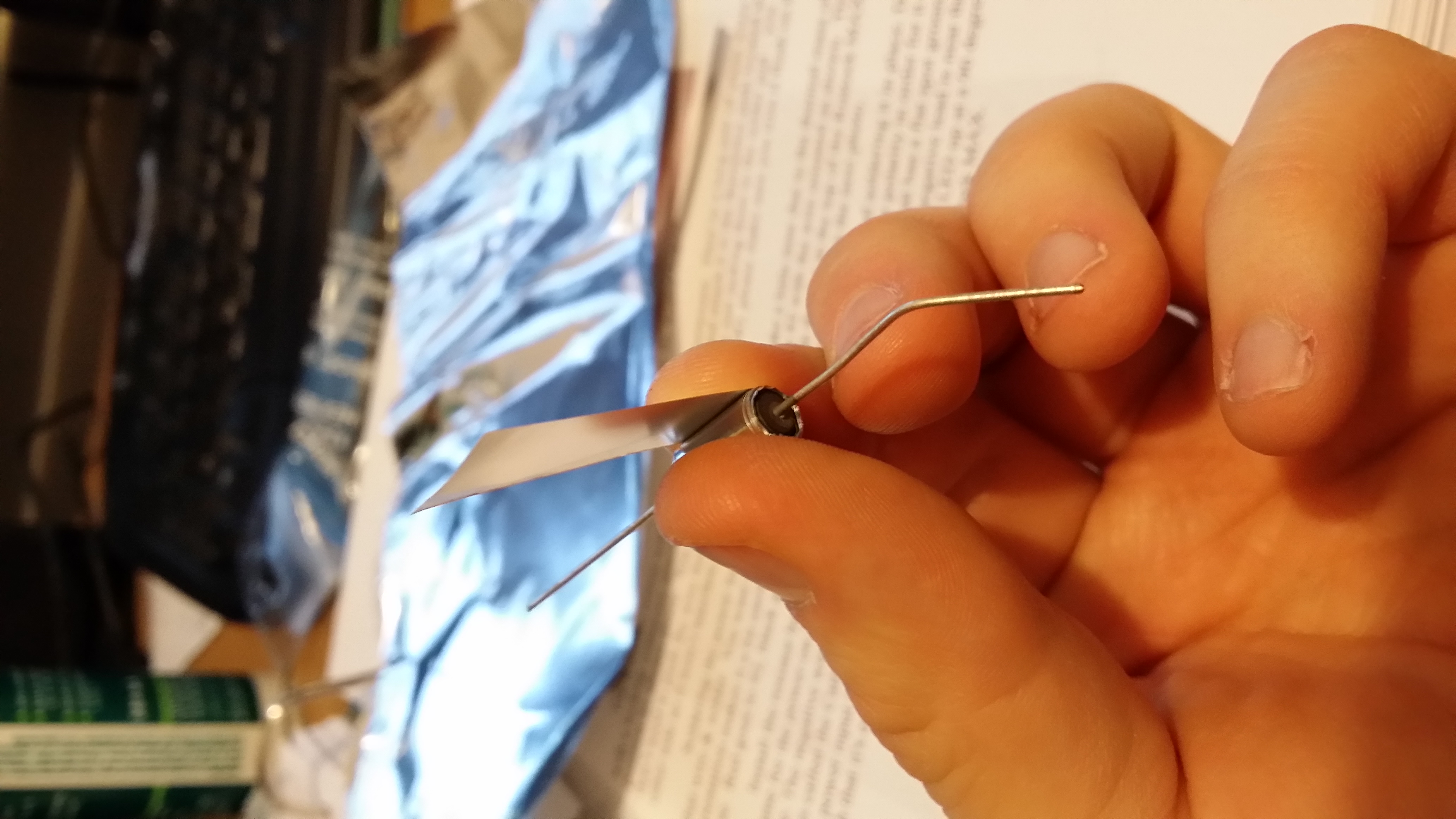

Hey Update my resistors arrived in the mail recently, and I just want to know, what is the best technique for wrapping the aluminum foil around the resistors to prevent shorts?
Also what is a good ammount should i totally cover the thing in foil or just put a little.
Any good suggestions to make sure the foil doesnt accidentally contact the resistor ends if they move out of place from heating?
What is the most optimum way of doing this that is safe?

When Seemecnc builds the Orion, they do not use foil, they embed the resistor in a thick coating of the Copper colored RTV making sure that the resistor is complete embedded without any air pockets. Seems to work well for them in the
building of the Orion. Foil is a bear to get right for the reasons you mention. The other option would be to eliminate the resistors and use a 12V ceramic heating cartridge on one side only.

Covered the resistors in RTV I was pretty thorough still got smoke bubbling up from the hot end though, I think the variety of RTV i am using is not ideal. (its silicon based)
I am considering just using a heater, is there a particular type of heater that you can recommend, i can most likely order it from where i live, also what is the best way of setting it up?
I am also considering going ahead with the foil anyway, i have an idea for covering up the resistors relatively safely to make sure no shorts occur. Basically just folding foil around them then putting a bit of RTV to hold it in place.
I am weighing my choices between searching for a heater or simply trying things with foil, what do you recommend.

Just do it with foil. Just wrap a thin strip around the resistor tightly but just make sure you don't touch the wire ends, that's all.
Like so:

I used a 6mm X 20mm, 40W, 12VDC Heater Cartridge. Mine came from eBay but there ar lots on Chinese Sources. I also used a 3mm screw in thermistor from eBay.
Still have to wrap but there are no wires to short.

I actually did this but my resistors ended up getting singed around the edges, where the resistors are open, not sure if i am doing something wrong, but i did exactly as was pictures and i still got wisps of smoke.
Not sure whats going on,maybe i didnt wrap them tight enough i will try this again.

Still seal up the ends with REV. You want to keep the heat in. When I first build mine, the hot end smoked a bit for me too. Not sure if it was the oils from machining or what, but it went away within about 30 seconds. If your actual resistors are smoking.... I'd be looking at getting a heat cartridge on order.
