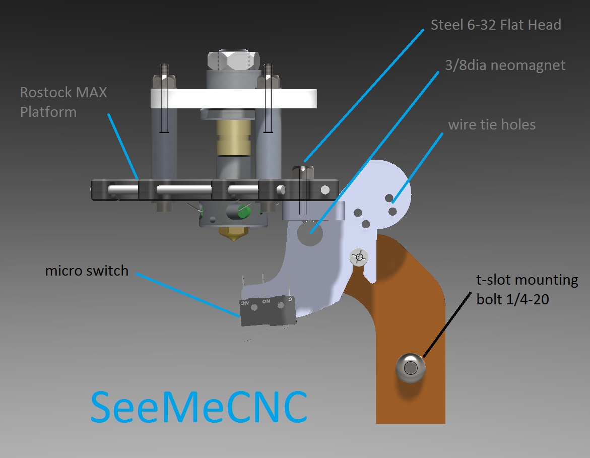

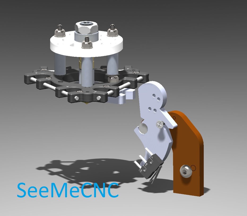

Here's an experimental magnetically detachable probe for the Rostock MAX. DXF files also on our SeeMeCNC GITHUB.
MagProbeSideView
MagProbeSideView
EZProbe by PartDaddy
BOM:
1-3/8 dia x 3/16" thick neo magnet
1-6-32 x 3/4"L ferrous steel flat head machine screw
1-6-32 x 1"L flat head machine screw
2-6-32 stainless nylon lock nut
1-1/4-20 x 1/2"L button head
1-10-32 x 3/16"L ferrous steel set screw (grub screw)
1-t-nut for t-slot rail
1-limit switch (micro switch)
1 each of the three laser cut wood parts 1/4" thick
The 6-32 x 3/4 ferrous flat head screw is used to attach the "Probe Guide" to the platform of the R-MAX. It also attracts the magnet on the "EZProbe". Next, the 10-32 x 3/16"L ferrous steel set screw (grub screw) is inserted into the "Probe Mount" and attracts the neo magnet when you return the "EZ Probe". The hooked portion of the "EZProbe" catches the 6-32 x 1" flat head. The bevel on the 6-32 x 1 flat head also helps guide the probe when it is returned.
The "Probe Mount" is attached to the Z axis (rear vertical rail). Adjust the tightness of the 6-32 x 3/4"L ferrous steel flat head to adjust how well the "EZProbe" fits when magnetically held in place. I programmed the probe to pick up, touch the indicator, and return the probe many times. Using an indicator, I measured a repeatability of .002".

Steve, can you talk about how you see this working? How it gets integrated electronically?
The only thing I can assume is that it is a measuring / leveling device - and that's quite a bit easier than the laser switch I did - maybe.
How does it hook up to the rambo or does it?
Do you have a video you can post?
I'd really like to see how this all works!

The probe has a limit switch type connection to the RAMBo. The wires are not attached yet to the probe shown in the video. I was planning on using a piece of PTFE tube stuck into a hole which would be drilled beside the probe. Picture two wires coming out of the end of the PFTE tubing (like a whip) and leading down to the probe.
The software to integrate this has not been written yet. The algorithm will probe 4 points. One at each tower and one in the center. While the three tower points define a plane, the center point will allow for spherical calculations, like center point and radius. The software stores the new values and begins your print.
This should eliminate the need manually set the z height as well as eliminate the need to manually set the delta radius offset. Basically, this saves you a bunch of time. And if the machine is moved from place to place, you can quickly auto-calibrate and start printing.

The only nitpick I have about the design is the requirement that you have to take the top off the machine in order to install the probe rest.
You could solve that by using a smaller diameter bolt that would allow the proper sized t-nut to fit in the extrusion slot and rotate a bit in order to catch the interior sides of the tower. You could also clip it to the tower in a similar fashion to how I'm mounting the wire guide.
I can't wait to get one cut. :)

geneb wrote:The only nitpick I have about the design is the requirement that you have to take the top off the machine in order to install the probe rest.
I don't know if I'd want to use a clip - seems like you wouldn't want any chance of it moving position once its installed and setup in firmware, or whereever the coordinates for its location will be stored. Your idea about the smaller t-nut is solid, though. Taking the top off doesn't strike me as the most efficient way to install it.
Or, could you not use one or two of the preexisting holes in the bottom platform and skip attaching it to the tower altogether?

Re: EZ Probe Attachment for Rostock MAX
The problem I see at the moment is that the mount that goes on the effector interferes with how I mount the LED light rings I use. :(
geneb wrote:The problem I see at the moment is that the mount that goes on the effector interferes with how I mount the LED light rings I use. :(
You're right and that is going to affect a lot of people. We'll have to come up with a work-around for that one.

I didn't manage to get pics of the light ring mount, but I changed it to two wire ties this evening. The issue is that the auto-probe blocks where I had one of my clips attached, so I punted and went back to tie wraps. :)
I was able to come up with a method of tweaking Steve's design a bit to allow it to co-exist with the light ring.
Here's a series of pictures:
http://www.geneb.org/rostock-max/probe
The first one shows Steve's original parts on the left, my mods on the right.
Instead of the probe guide being attached to the bottom of the effector platform, I extended it a bit and mounted it to the top surface. Works great.
