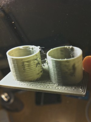

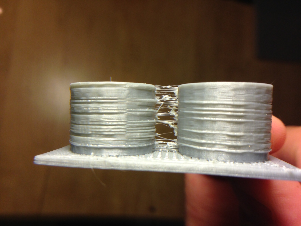

I have been printing a double cylinder on a platform and I can't seem to get the cylinders with consistent layers. What do the walls of my cylinders tell me about my setup?
Re: Best object to calibrate for optimal settings?
Also, I am sure my hot end tip is aligned with my bed. I have the height perfect between the bed and hot end and I have run the 3 scripts, one for each axis and adjusted my cheapskate screws. I have done this several times and even bought another .05 hot end tip because I thought the other might be off. I notice this effect most of all on the first layer obviously. What is going on here? I will say that I have not done the DELTA_RADIUS adjustments at all...
It appears that the walls of my cylinders (1mm thick) are too thin for the Rostock Max to print. 2mm walls print better. I obviously still have retraction issues.
I've printed about 80 single wall (.60mm) tea light holders that contradict that statement.
Regardless, you've got other problems than just retraction. It looks to me like the flow rate is wrong - have you properly calibrated the EZStruder? 92.65 is a good starting point, but you may have to adjust from there. (A red flag on the flow rate is how the perimeters of the flat platform have a HUGE gap between each perimeter. It should appear to be one solid block of plastic).

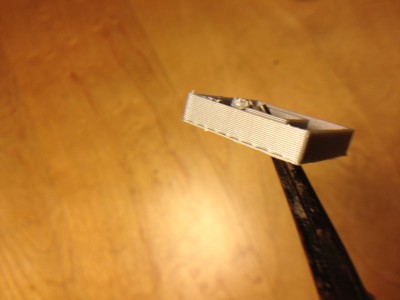

The flow rate is the rate at which the hot end extrudes filament. You're basically under-extruding. This means that the extruder is delivering less filament per extrusion command than the slicing software thinks it is.

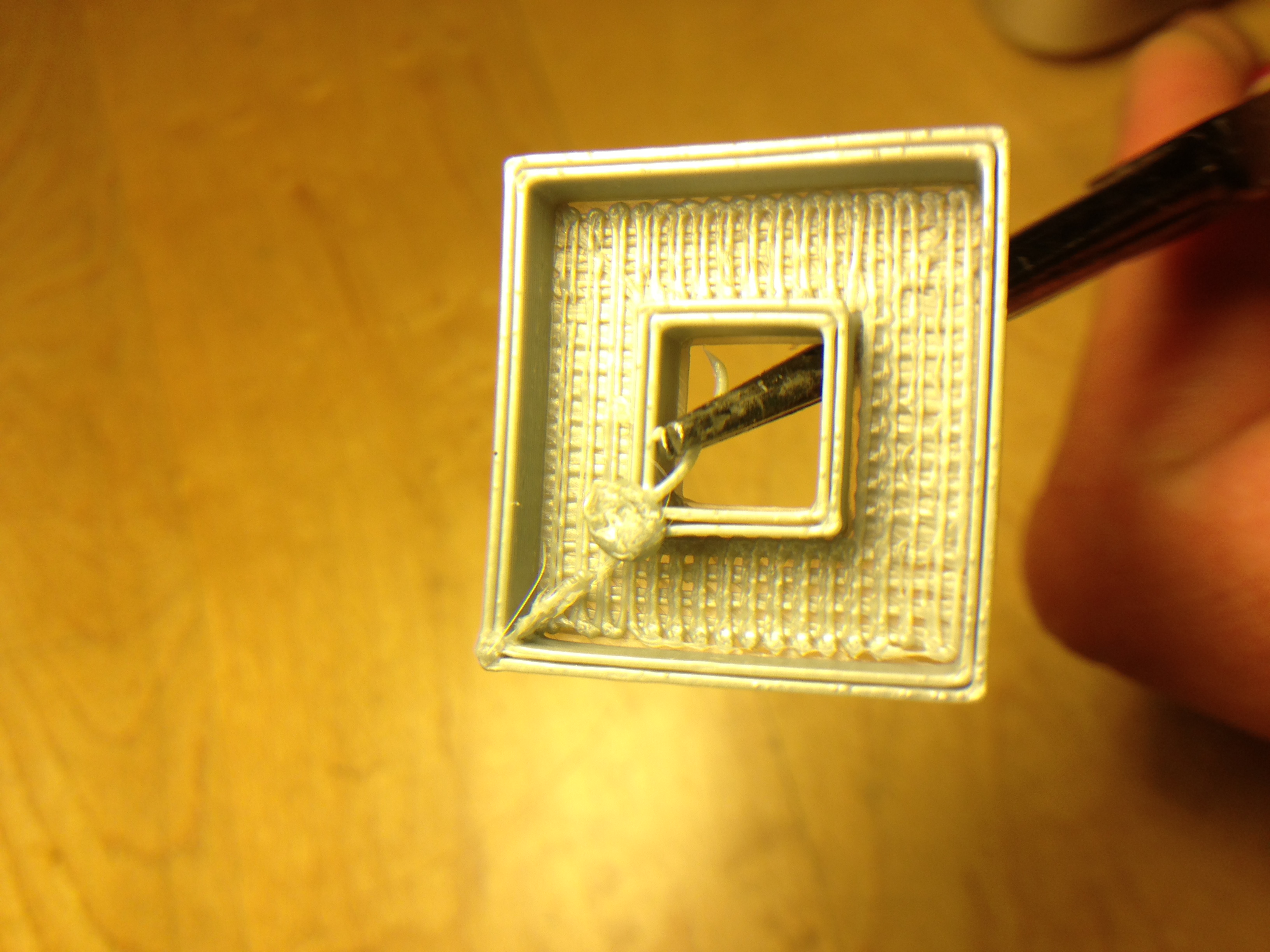

Print the hollow cube and cancel the print after 10 layers or so and post a top-down photo of it here.
Alright I will do that. Just so I'm printing out the right hollow cube, can you provide me a link for it?
It's the "calibration cube" that I list in the assembly guide.

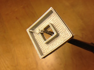

Oh the Skeinforge Bridge Calibration Cube. Yes, I'm noticing the perimeters aren't as one solid piece like you said. So where is the flowrate setting? The slider on the manual control tab of repitier?

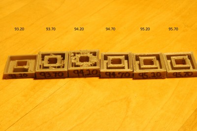

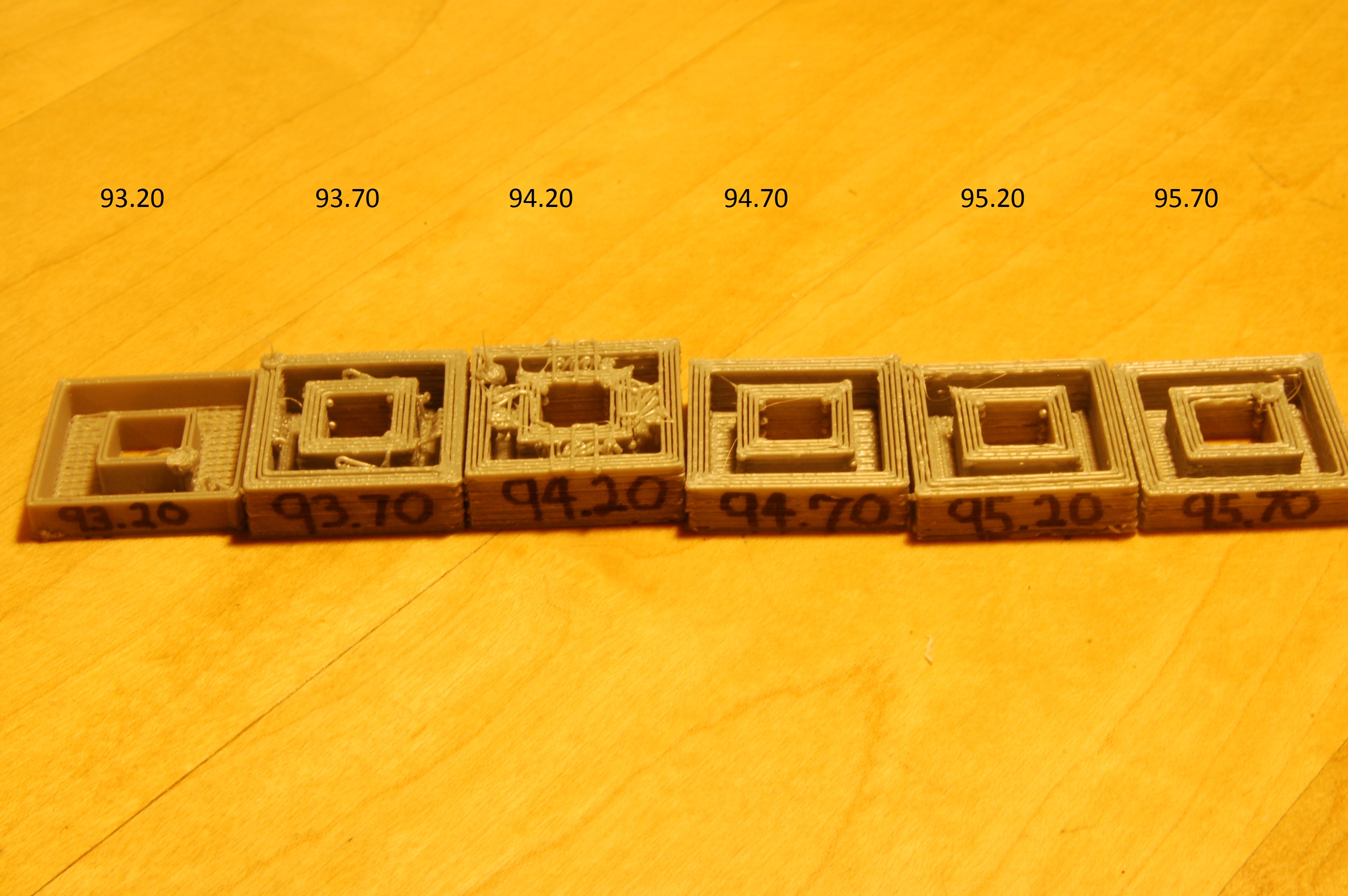

Try tweaking your extruder steps per mm setting. The "default" is 92.64 (if memory serves). Bump it up by .5 and see how it goes. Tweak it until you're getting perimeters that actually meet.
Ok I'm testing bumping the extruder step up .5. Thanks for your time.

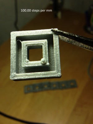

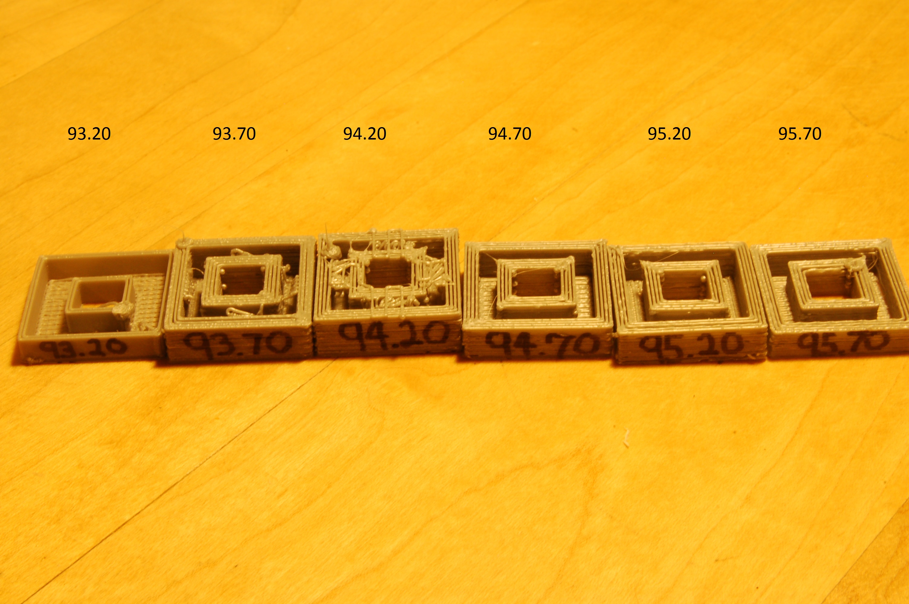

As far as my perimeters not making contact with eachother-I've been doing what geneb suggested and here are my results. I have 7 prints here. I'm incrimenting my Ext. steps in my EEPROM configuration .50 on each print starting from 93.20 on the far left to 95.70 on the far right. And the last picture is of me bumping it up to 100.

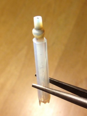

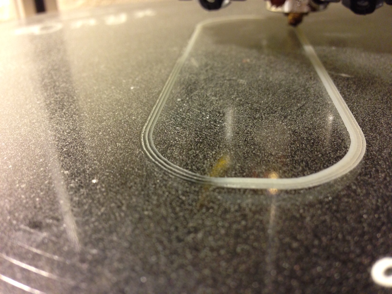

Just wanted to follow up here with my findings. The clacking noise and the thin perimeter issues I was experiencing were definitely related. As I took my hotend apart I noticed a bulge in the high temp tubing.
The first couple weeks of my issue I thought the bulge was normal and it served as a "stop" for the high temp tubing as it protrudes into the brass tip. I had never taken the hot end apart before so I never knew what it was supposed to look like. I decided to post a picture of it and ask if it was normal and Geneb pointed out that it was definitely not normal.
So the clacking was from the high temp tubing constricting filament flow which forced the expect ruder stepper to skip as it was trying as hard as it could to push through the obstruction. The small perimeters not touching together on their sides was do to the reduced flow rate provided by the constriction as well. The final symptom was me having to throttle down my federate slider to 80 or even 70 to stop the clacking and create better perimeters. I was avoiding the real problem which was the bulge in the high temp tubing in the hot end itself.
Overheating the PEEK on my first couple of days with the Rostock while calibrating it is the reason my high temp tubing developed the bulge. I did this by stretching my hot end thermistor wiring just enough so that the thermistor wasn't in contact with the hot end. I couldn't see this disconnect because of the High temp RTV applied to the area. As the hot end heated up with little or no feedback from the thermistor, it melted the PEEK an deformed the tubing inside.
