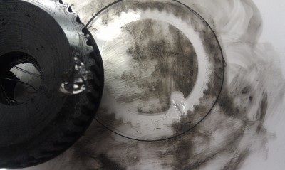

So I have pretty good first layer adhesion, but this is ridiculous...
Left a print over night (6 hour print) - looks absolutely beautiful.
Lifted the print up - didn't need any scraper, it just lifted right off - and a chunk of the boro glass was stuck to the part.
120 bed temp with some juice.
Seems like this shouldn't happen...
Thoughts?
Thoughts?

Looks to me like the result of a defect in the glass. That may happen with regular annealed glass, but shouldn't happen with borosilicate glass.

I would be curious if anyone else runs their bed temperature that hot and have experienced failure of the glass.
The glass should be able to withstand 120 Centigrade but this failure makes me wonder, is this just an isolated
case or not?
case or not?

Re: This isn't supposed to happen, right?
I put it at 120 because only the very center of the glass is at 120.
Even 1 inch away from the center and it drops to 112-115. A few inches from the center and it drops to 100 or lower.

Also, the safe working temp of boro glass is well above 200C...
I use plain 1/4" glass with hairspray.
I have had pieces of glass come up with print IF I use to much hairspray. Normally no problems.
I use 75c
I don't think it was high temp, just to good of a bond with the abs juice.
give hairspray or white glue stick a try.
hopefully you can use the other side of that expensive piece of glass!
that's why I use the cheap 1/4" glass from the glass shop... no big deal if it breaks.
I don't even bother getting it cut round, a 10-1/2" square works just fine for me.
I use 75c
I don't think the glass is going to work anymore. The crack goes all the way through, so I have a feeling it will break completely if it's heated up again, or has any sort of pressure on it. I may be able to use it for PLA, but I don't print much other than ABS.
John just said they would replace it, so that's excellent.
I normally use PET tape with juice, but I wanted to print last night and didn't want to wait for the PET to cure... I guess I will continue my PET using ways.
I've tried hairspray, but for the 2 prints I make that we sell to customers, it's not strong enough to prevent warping/curling.
Haven't tried glue, but haven't really felt the need to use anything else.
In related news, I just came across some 3/16" and 1/8" glass refrigerator shelves. They're labeled as "tempered", but that could really mean a lot of different things.
They are large and flat, and if I can properly cut them, they would seem to be excellent build plates.
Anyone know how to test if they're able to handle thermal expansion without heating them up?
Tempered glass should be ok thermally but you can't cut it. As soon as the surface is broken by cutting or chipping it, the whole piece will "explode" into small pieces. It's manufactured under high stress for safety. Any break will release all the stress catastrophically reducing it to small bits. The small bits will not be very sharp and it will not produce long shards that could stab someone. I found that out the hard way while sandblasting a design into a piece of tempered shower door glass. Everything was going great until I got just a little too deep with the etch and BANG! Buckets full of small glass confetti. That was fun.

I've seen glass plates do that, especially with ABS juice. But it's likely a result of a small defect in the glass. What probably happens is that as the part cools and shrinks, the weaker glass breaks rather than releasing the print.
Standard window and mirror glass was not engineered to handle thermal stresses. The borosilicate/high temple glasses are explicitly designed for this. Last year I posted in my build thread the shattered glass build plate that occurred on heating. A piece of glass the size of a matchbook hit the wall. If it had gone the other way, it would have hit me. Please be careful with glass that is not designated for hot applications.
