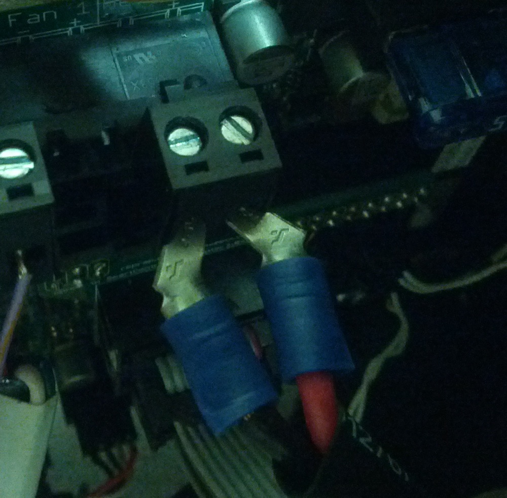

My new question is how to connect the 12ga wire to the rambo. The rambo connectors/slots are just too small to accept 12ga wire (how annoying).
Eaglezsoar - I saw in another thread that you used 10ga wire for your heated bed. How did you make the transition from thick wire to rambo?

In my installation, I used a very short pigtail of 14ga and the XT60 connector to connect the heated bed to the RAMBo. I really wish Ultimachine hadn't changed out the connector design. The new ones they use aren't nearly as useful as the originals...

MDMD wrote:My new question is how to connect the 12ga wire to the rambo. The rambo connectors/slots are just too small to accept 12ga wire (how annoying).
I crimped and soldered spade lug connectors to 14 gage wire, clipped one of the two prongs, and it makes an excellent connection with the Rambo board. You could probably do the same thing with 12 gage.
spade lug connector.jpg (6.21 KiB) Viewed 17205 times
Now I understand the bed connectors have changed on the Rambo and I haven't seen the new version and if it will work with this setup.
