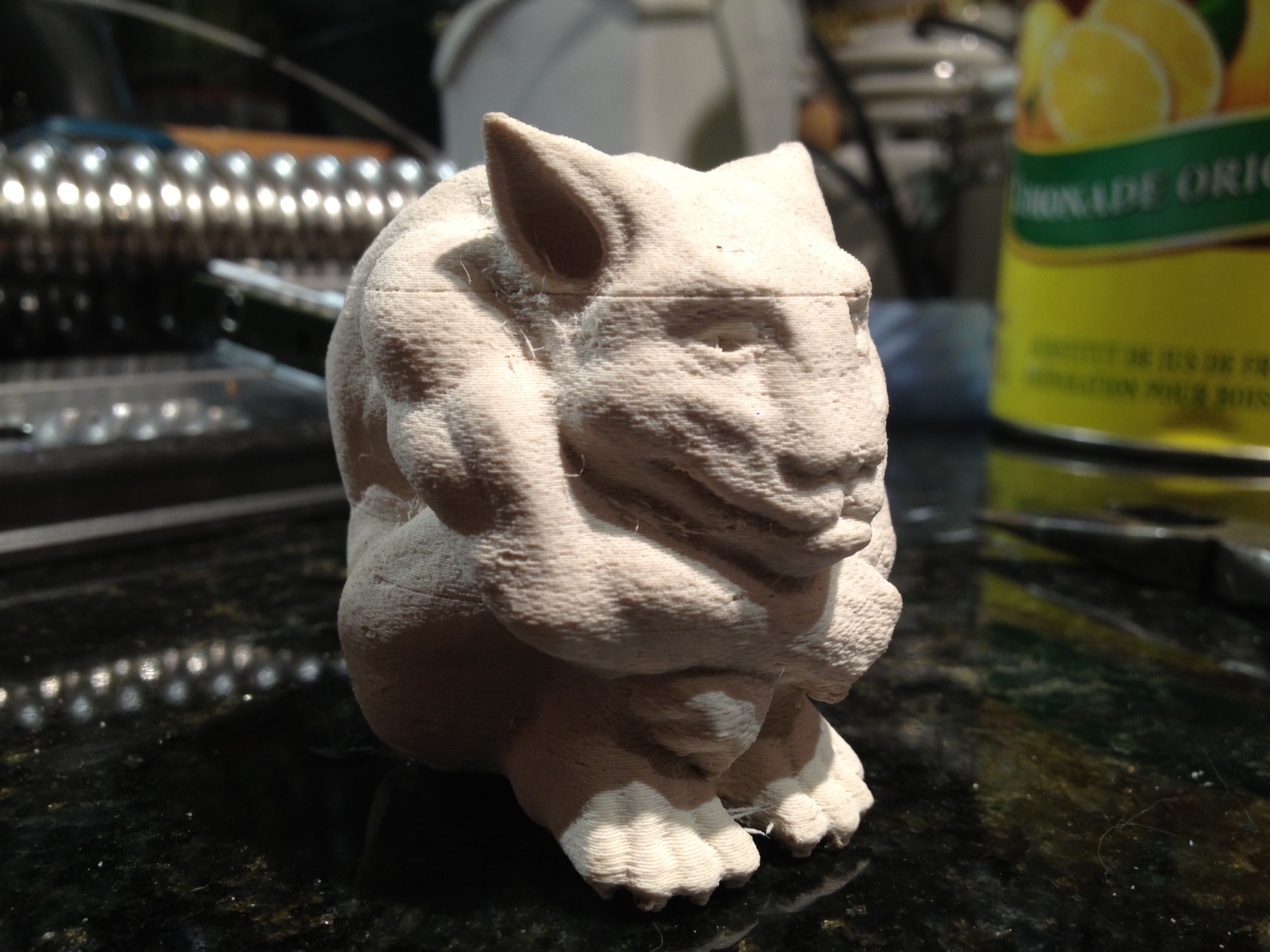

Has one bad layer as you can see, but I was lucky enough to catch it and re-feed the broken filament during the print.

Re: LayBrick sandstone like filament, my experiences.
Flateric wrote:Has one bad layer as you can see, but I was lucky enough to catch it and re-feed the broken filament during the print.
Just call it "sandstone", and no one will comment on the line.
