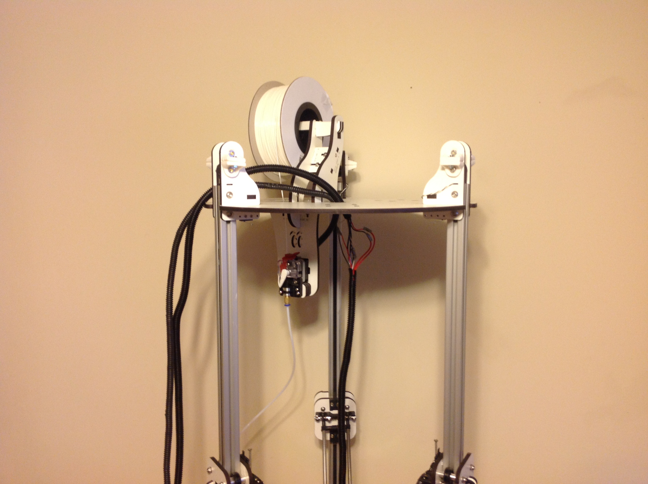

I bought the top mount EZstruder kit with my new Rostock, and I can't find assembly instructions for it anywhere. Anyone?

Well, I managed to get it together (wasn't too difficult really) by looking at other pictures. I realize that these are kits, but some type of instruction should be available from them. Moving on...

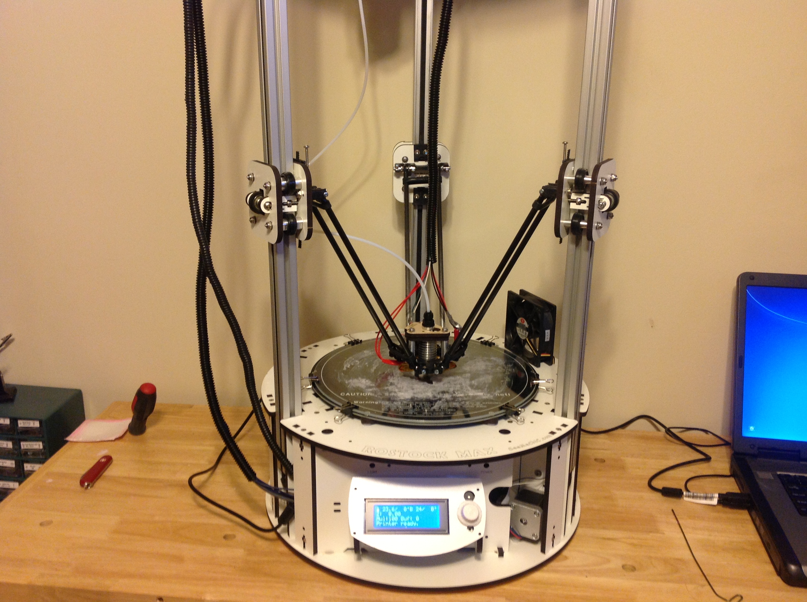

This is exactly what I needed. Thanks. Now what about the heater/fan/temp wires going to the hotend? No longer braced against the Bowden tube, they move around a lot, and that's no good. It will probably work-harden the wires and either break them or hose up one of the solder joints. What is everyone doing for a strain relief?

I haven't seen how they're mounted yet to the hot end... But I would think that they should/could still be bound to the bowden tube, at least the last few inches of it (if not the whole length after a short distance from the extruder) to stabilize it from movement while the head is moving to protect the solder joints and connection on the effector platform as you stated. If you only bind it to the last few inches before the platform, make sure you leave enough cable so it can read all the way to the bottom and the farthest sides of the build plate! If you don't, then it will most likey cause some serious issues when the head tried to move out there and break a connection, possibly the thermistor and lead to meltdown...

626Pilot wrote:This is exactly what I needed. Thanks. Now what about the heater/fan/temp wires going to the hotend? No longer braced against the Bowden tube, they move around a lot, and that's no good. It will probably work-harden the wires and either break them or hose up one of the solder joints. What is everyone doing for a strain relief?
Here's how I did mine after installing the ez-struder:

See http://forum.seemecnc.com/viewtopic.php ... 0&start=30 for how I routed the wiring.

Just FYI - I've got photos taken for the install, but I'm waiting for a hardware BOM from John before I write it up. I grabbed what I had on hand to assemble mine, so it likely won't match what you guys get. I also have a method of doing routing for the wiring that you guys may or may not like. :)

The top mount filament holder is a huge improvement over the original design. My filament used to bind itself up because the old axle design caused too much friction, but I've ran through quite a few meters since installing it and it hasn't fouled itself up even once. Together with the EZStruder, this is a great mod!
