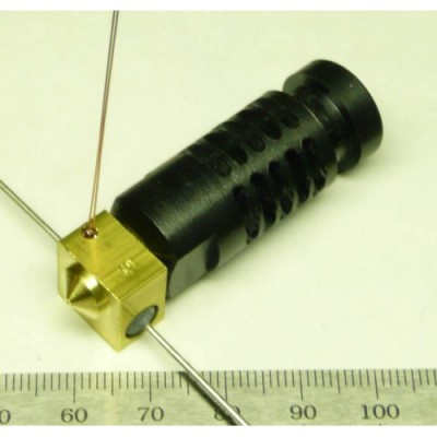

Also, what is easiest to work with PLA or ABS?

I have enclosed a picture of the j-head hotend. They have been around for a long time and are used in many home brew printers and some kits.
They excel at printing with PLA because a fan is placed to blow on the plastic part with the slots to keep that section cool. Note the groove at the
very top of the j-head. This is what is used to mount the j-head and the part that fits this groove is called a groove mount. Each hotend has its own
characteristics and one is not necessary better than another although some do seem to excel at printing various filaments. The latest hotends are made
from metal and have none of the plastic Peek that can melt if your hotend gets over 240 centigrade. The all metal hotends have there share of problems
also but they are the newest kid on the block and they will work out the "bugs". These all metal hotends are fast becoming the defacto standard for
3D printers and will become the hotend of the future. As you can see each hotend brings solutions and problems unique to itself and there is no such
thing as a perfect hotend. You will want to experiment with the different ones. A recommended j-head comes from hotends.com. The all metal hotends
come from various places but most on this Forum seem to buy the E3D hotend which is shipped from England at this time. I hoped that I answered some
of your questions about the j-head hotend and the other types on the market.
