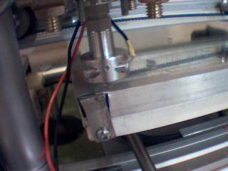

hi all just wondering the correct way to wire up end stops, not to sure if it is one in the middle and one on the edge or skip the middle pin and just the out side pins. got some out of a printer and there all ready wired to middle and out side any were i can find info thanks.

There are three leads, it's the outer two.

just so i get this right the end stops are for setting zero point?

Yes! Each time G28 is issued, each of the arms raise up to trigger the switch. This is the absolute measurement on each axis to the bed. The RAMBO firmware stores that and uses that as the base for arm movement.
BTW, they are not polar - so just wire them. The switch is only closing a circuit.

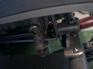

ok so i got the end stops set at the edge of my glass and down to as close to the glass as needed or is it the other way around as far way as it can. since iam not doing the rostook max printer doing a lotof converting of info lol post some pic of what i did see if i got this ass back words

thi is were i put it to for end stops

Remember guys, Spart is building a cartesian printer, not a rostock delta. Endstop wiring may be different from geneb's manual.
Our rostock endstops are certainly not near the print bed like yours spart.

It can if youre relying on it to stop the head from crashing through the glass bed.
I'm just saying that spart might want to consult other sources too for endstop wiring help. I know seemecnc also has the H1 cartesians but the forums is starting to get rostock-heavy.
And our rostock switches are wired NC, normally closed
So hitting the switches will actually open the circuit.

i got it all done, if it don't work back to the drawing board lol, going to do some more looking around saw a couple guys on you tube wiring it the same way, but for as in close to the glass i will set it up high till i see what it dose for stopping space set it from there i set it up on a adjustable stick idea so got room to move. this is more like a mandle printer i think that's the model so many out there will run into something
