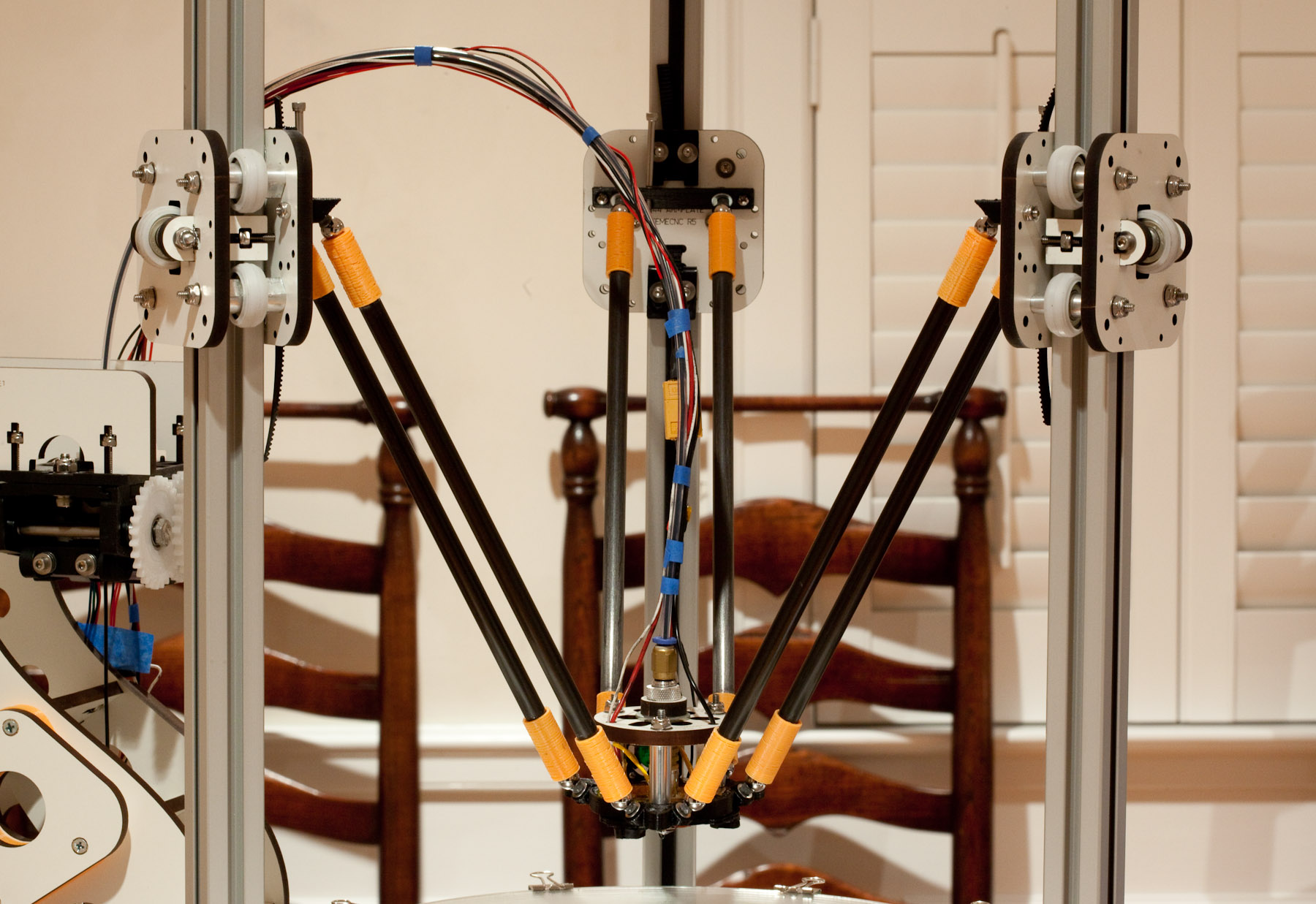

With both fans pointed at the plastic exiting the nozzle (even at 25% speed). The hotend is unable to stay hot and very quickly looses heat. I didn't use any RTV on this rebuild (about my 6th rebuild of this frustrating hotend).
What is a good way to insulate this hotend? I'd still deciding which other hotend I'm going to replace this one with (E3D or J-Head probably), but I imagine it will have "staying hot" issues as well. I've had this printer printing since January and I still am not satisfied with the prints I'm getting. I'm not trying to complain, because I actually really enjoy tinkering with it, but at some point I'd like to actually begin printing things other than just useless junk (although the fan brackets shown in the picture were designed and printed by me :)).
As always, I appreciate all the help I get from this forum.

Wrap the hot end in high-temp silicone tape. It'll insulate it from the air flow. You may also want to dial down the speed on the fans - they don't need to be run at 100%. (I run mine at 15%).
Re: Best way to insulate Steve's hotend from cooling fans
I like to use a strip insulation that wraps around the hotend and is secured with Kapton.
I get it at McMaster-Carrs at this link: http://www.mcmaster.com/#9379K91
It is 1/2" thick by 1" wide X 12 feet. It is close to $10 + shipping but works well and other
alternatives aren't easy to find.

I do have some foil and kapton tape on the top of steve's heater block, but it's clearly not enough. I have tried redoing the PID Autotune with the peek fan on. Currently, it hovers smoothly about 1 degree below the set temp. I just set it a bit higher than I really want it.
I might also mention that when the effector is near the Z tower, the magnets in Xnaron's magnetic arms get close to my peek fan and slow the fan down ... resulting in some fluctuation in the holding temp.
