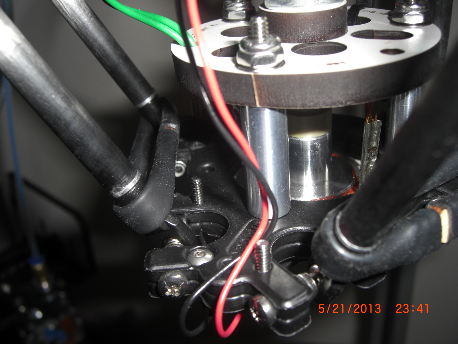

I installed my Trick Laser CF arms last week and my prints went from ok to great. I printed out the N64 logo in Red ABS at 0.2mm layer height at 30mm/s at 230C. I couldn't believe the quality. I'm very glad I ordered them. They installed in seconds too. Turn key operation.

Hey cambo, what all do you have wired to your hot-end? Is that 3rd set of wires for a fan or LED's?
Re: Carbon Fiber arms from Trick Laser
Jimustanguitar wrote:Hey cambo, what all do you have wired to your hot-end? Is that 3rd set of wires for a fan or LED's?
for my led ring and fans http://forum.seemecnc.com/viewtopic.php ... 270#p10128

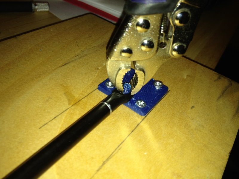

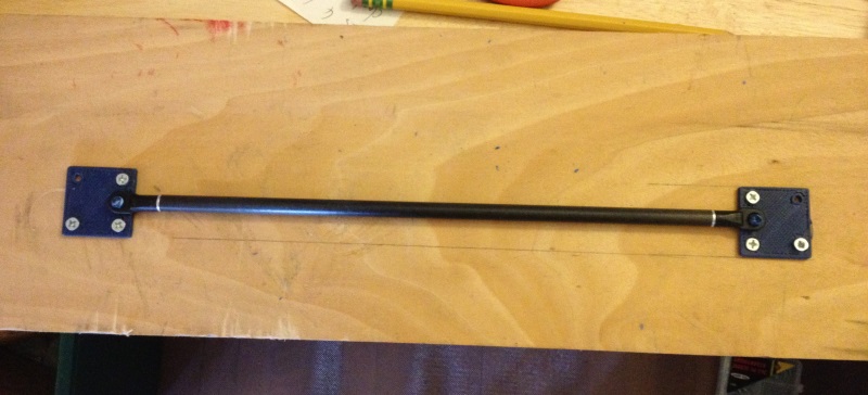

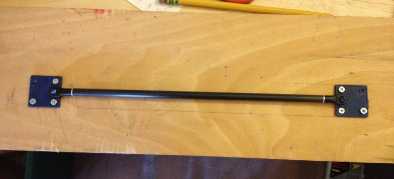

I couldn't wait the 2 weeks to get the arms pre-assembled, so I went ahead and risked building them myself. I used epoxy (instead of superglue) to attach the ends to the rods, and that worked perfectly...although the ends did rotate and slide freely for me, unlike 626Pilot. Maybe the superglue sets up too quickly? In any case, a jig is a requirement to get the ends properly aligned. I printed up some "pegs" to hold the ends up off a board while the epoxy set up.
In case anyone wants the STL, here it is. I used a vice grip to hold the rod ends down against the jig while they cured.
So far these rods do have some play in them, but I ordered mine before Trick Laser offered the zero-lash straps. I'll probably order them up soon. Prints are definitely better now.

626pilot. If you heat the ends slowly and carefully you should be able to un-bond the ends and try again. Go slow with pliers to pull the end apart as hyou slowly heat the end.
If using a super glue if you use too little it will set faster and not have enough time to assemble. The more you apply even if some sqeuzes out you will have time to assemble and wipe excess off before it cures. Use a synthetic man made fabric to wipe off excess. Not paper towel or cotton it will make a mess. You will still need to work fast but have time. Or use a 2 part epoxy then you have time to assemble just leave in a fixture to hold overnight with the epoxy.
Also, Acetone will dissolve superglue. You could try soaking the end of the rod in it for a while.
Not sure what plastic the ends are made out of the Acetone might melt the ends or effect the ball joint.
Acetone will also leach and eat the carbon fiber's resine that it is bonded together with ruining it, do not soak your carbon in acetone, it's end up looking like a paintbrush on the end.

The difficulty I had is, I think, that the instructions say to "glue" when they should say to use "loc-tite." The immediate seizing happened with superglue, but it didn't happen with loc-tite. It takes awhile to set, whereas superglue is deliberately designed to set as quickly as possible.
Re: Heating the rod ends to dissolve the glue. The rod ends have plastic and you have to heat that stuff over 400 degrees to get it to come loose. I wouldn't recommend it.
The ends are a plastic. But you can unscrew them from the aluminum insert. use a some other threaded bolt to screw in to the aluminum insert.n heat carefully while pulling the insert out.
