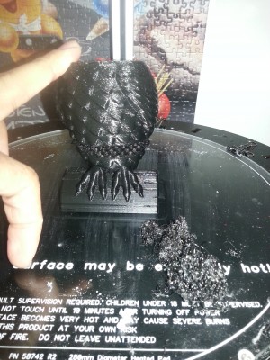

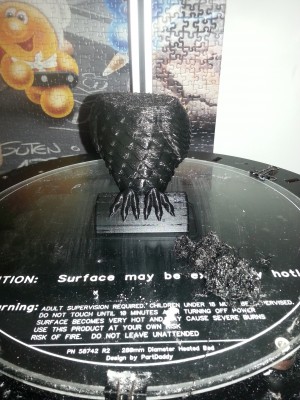

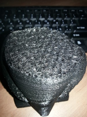

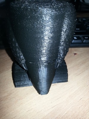

well, i should post in in fail
it was bad and didn't finish....
