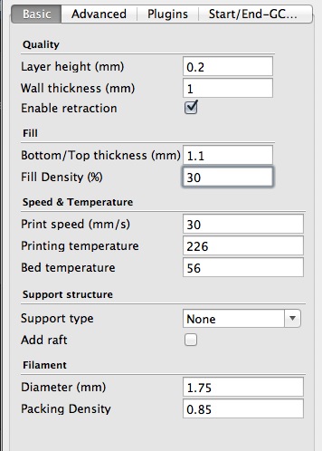

I would like to try Cura, Does anyone have a configuration file for a stock Rostock to share?
Any tips or advice would be nice.
Sounds like to would be better for a bowden extruder with the retraction.....

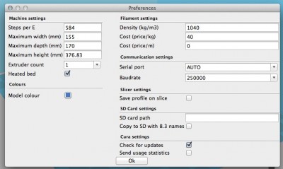

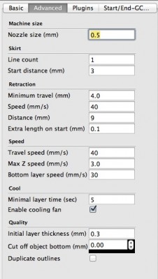

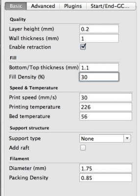

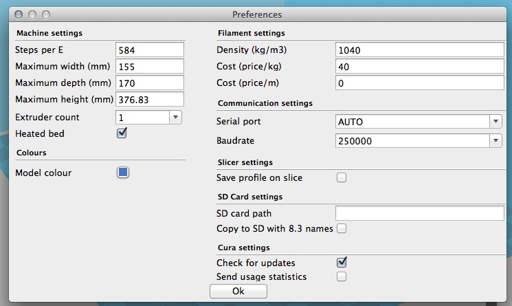

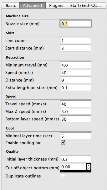

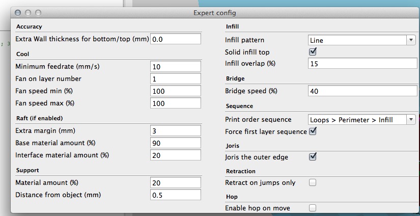

Hey Bill I'm using Cura for some prints, noticed some things don't print as well as Slicer but most others will.
Here are screenshots of the majority of settings.
I have the original square bed so those settings would be different if you have the Onyx bed
Hope it helps!
cheers

thank you so much,
Is that the temp for pla or abs?
Bill

I tried it and it shows the part on the edge of the table? How do I move it to the center?
Bill

When you download/install Cura, did you click on the option to have the center of the bed at 0,0,0?

I clanged it to 0 and that worked, thanks!
My last issue is that when the print begins, it starts with a retraction that starves the nozzle for much of the first layer....

here is the cura profile from seemecnc, this was taken from the rosoft link.
cura seemecnc profile.ini
(2.67 KiB) Downloaded 343 times
this is my current profile i've been testing, use at your own risk
rostock cura profile.ini
(2.98 KiB) Downloaded 352 times
