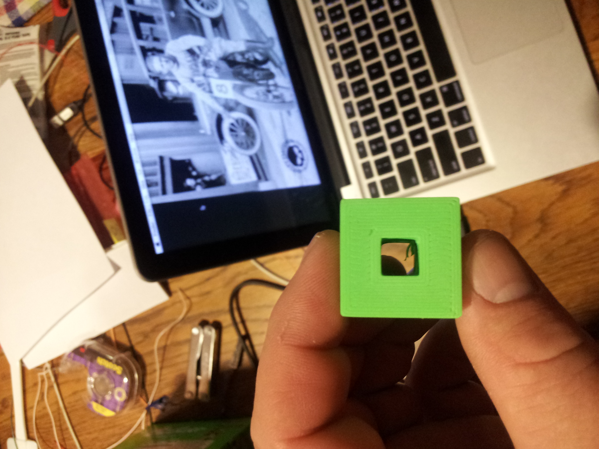

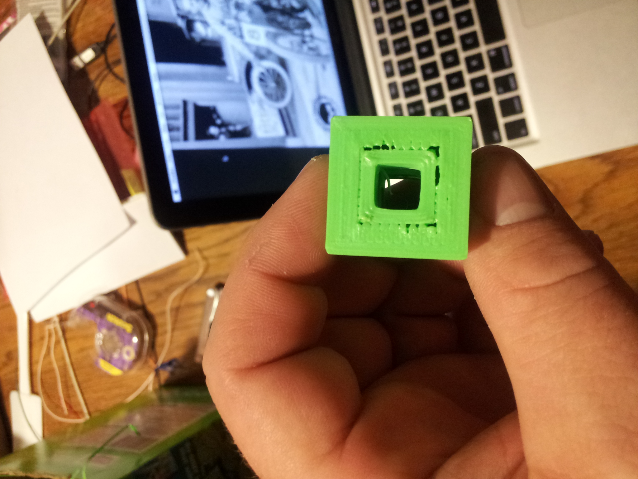

I have reworked all of my arms and ujoints. Everything is smooth and my rostock is much more quiet that it was before the adjustment. I'm still getting some gapping on the top. It seems to start happening after the bridge. I can see that the infiltration layers are not going over to touch the center square.
When others print out the cube with hole, do you print it solid or with infill? I have been doing 20% infill but I will try a solid one tonight.
Any other ideas on what could cause this gapping?

I was adjusting slicer settings, and I noticed that when I had the extrusion width set to .55mm there was a visible gap in the 3d model showing each layer. I played around with the extrusion size, and when I set it to .5, the gap went away. I'm running a test print right now with the setting. So far, it looks spot on. I know that in the extruder calibration thread it was suggesting to set the width to .55mm. Has anyone else seen this issue?

Either your steps per e or filament diameter is off if changing the nozzle width/extrusion width fills/opens a part up, especially when it's only a .05 difference.

I will check that tonight. I'm pretty sure my steps are correct based on my testing. It is worth it to check either way. Thx

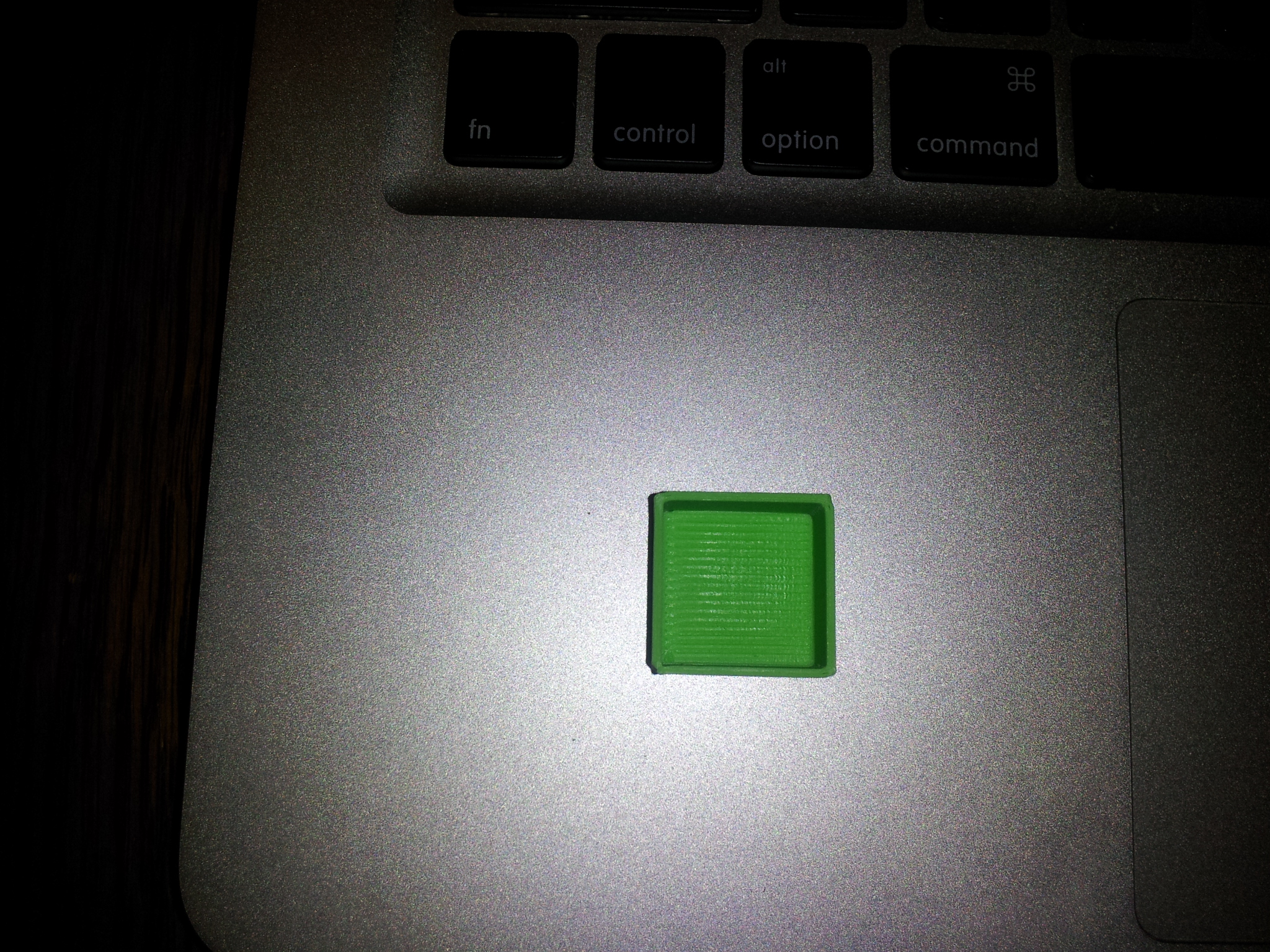

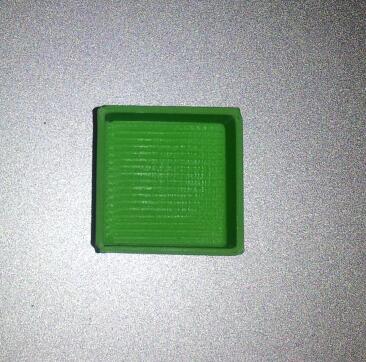

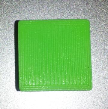

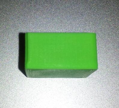

I checked and my steps are right on. I decided to do another small, think wall print. I created this 20mm x 20 mm x 10mm cube with 1mm floor and a 1mm wall. It is almost spot on. I need to do a little adjustments, but if I can't get it any closer, I can live with the results.
bottom view
bottom view
2013-04-19 19.35.06-1.jpg (25.97 KiB) Viewed 5767 times
Side view
Side view
2013-04-19 19.34.48-1.jpg (31.55 KiB) Viewed 5767 times
zoomed out for some scale of how small this is on my lap top

top view
top view
2013-04-19 19.34.20-1.jpg (32.02 KiB) Viewed 5767 times
