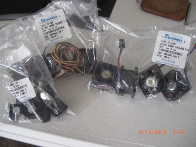

Is there any link (Amazon prime would be great, but couldn't find any) for the 25mm fans? I had to use a 40mm because I didn't find any after a bit of searching (didn't look too hard, but did check my usual sites).
@MorbidSlowBurn good call on the fan placement, hadn't thought about that

allelectronics.com. these are 5v but are cheaper than most i've seen http://www.allelectronics.com/make-a-st ... FAN/1.html
these guys have some really great prices for fans and such.. i bought a buck load of items from them..

What is the flow rate on those? And how "thick" are they? I am using 25mm x 25mm x 10mm thick. Nice and small with lots of flow at 2.4 CFM.

mhackney wrote:What is the flow rate on those? And how "thick" are they? I am using 25mm x 25mm x 10mm thick. Nice and small with lots of flow at 2.4 CFM.
Delta Electronics # AFB02505HHB. 5Vdc, 0.23A. 25 x 25 x 15mm. DC brushless ball bearing fan. 13,000RPM. 29.5dBA. 4.06 CFM. Two 50mm leads with 2-conductor female connector, 0.1" centers. UL, CSA, CE, VDE.
Re: What's all this hoopla about fans?
That's a nice fan. Have to pick some of those up.
