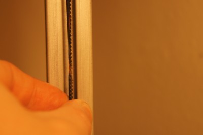

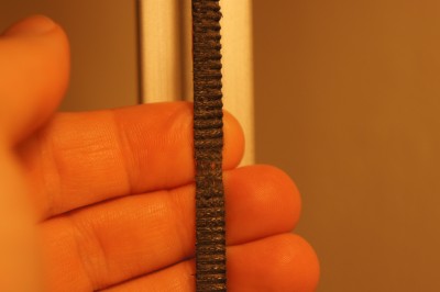

I decided to inspect the belts on my Rostock Max today. I've had my printer up and running for about 2 or 3 weeks. I've probably printed about 20 to 30 hours.
Look what I found on the X belt! The other belts were chewed but this one was the worst.
I've been using these belts on my cartesians and they last for years.
I've read other users were having their belts prematurely wear and I believe the suspected cause was the sharp pinion gears.
I will replace them but I want to make sure it does not happen again. Is it the pinion gear? Do we have a replacement option if so?

I'm pretty sure the issue is having the head meet significant resistance and the drive pulleys eating the belt.
Almost all the failures seem to be about 1/3 of the way up on the front side of the pillars when the head is homed, that's more or less on the pulley with the head on the bed. Which to me implies pulley eating belt when head meets resistance, if it were just sharp teeth on the pulley I think you'd see more consistent wear.
Ideally you'd want the motor to stall in that scenario, but with the long belts and shallow teeth I think it's difficult to tune them to that level.

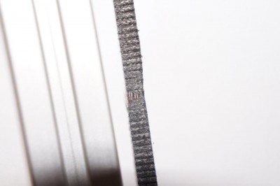

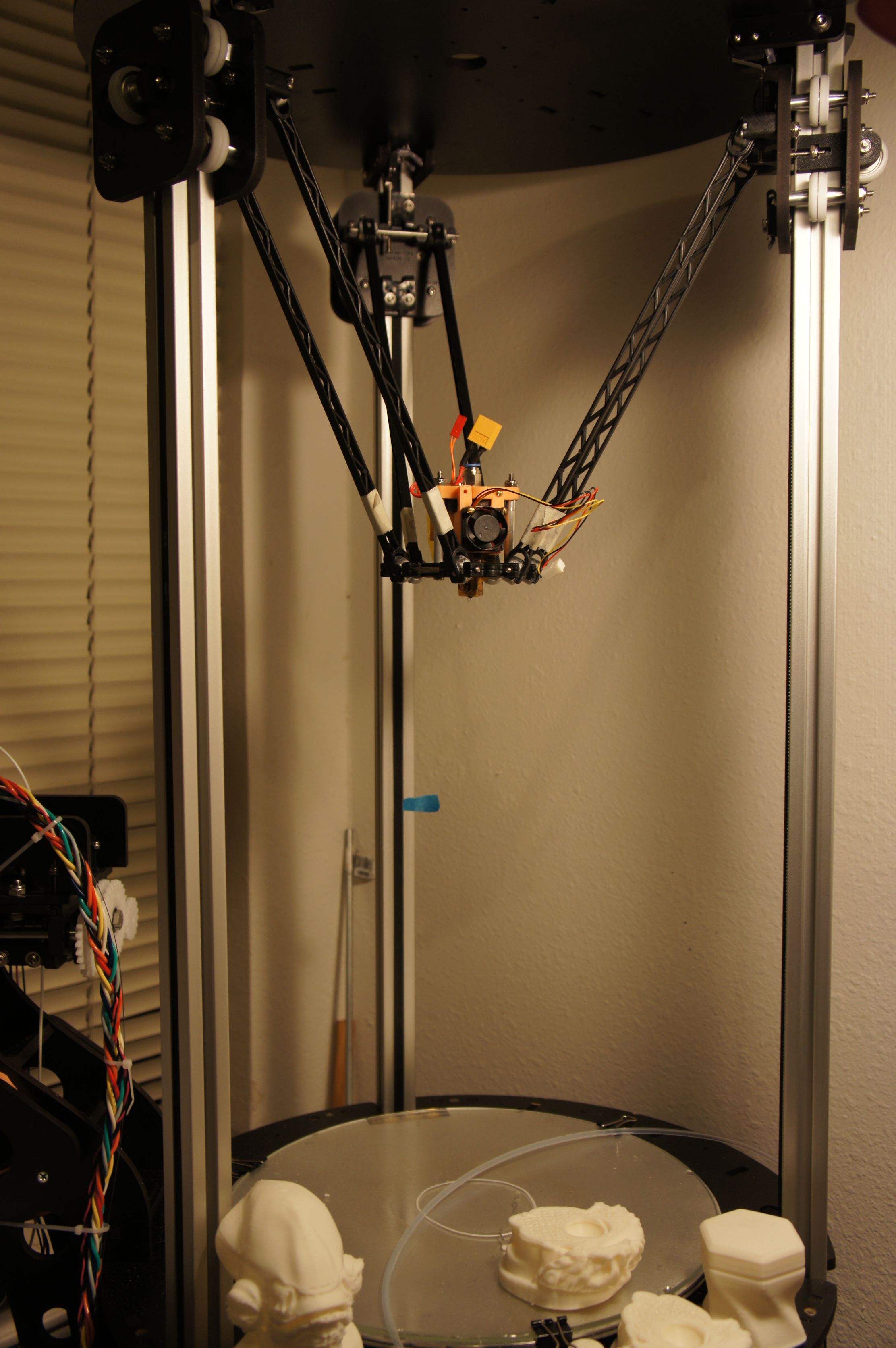

Here's a measurement of where mine is chewed. On the Z-Tower a stretches between 16 and 16 3/8" below the U-Joint centerline.
(that's not my fingers thru the belt, just the reinforcement) (Belt is chewed at the blue tape mark. And a sneak peek at my Budashnozzle mount)

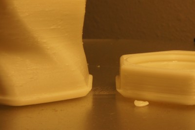

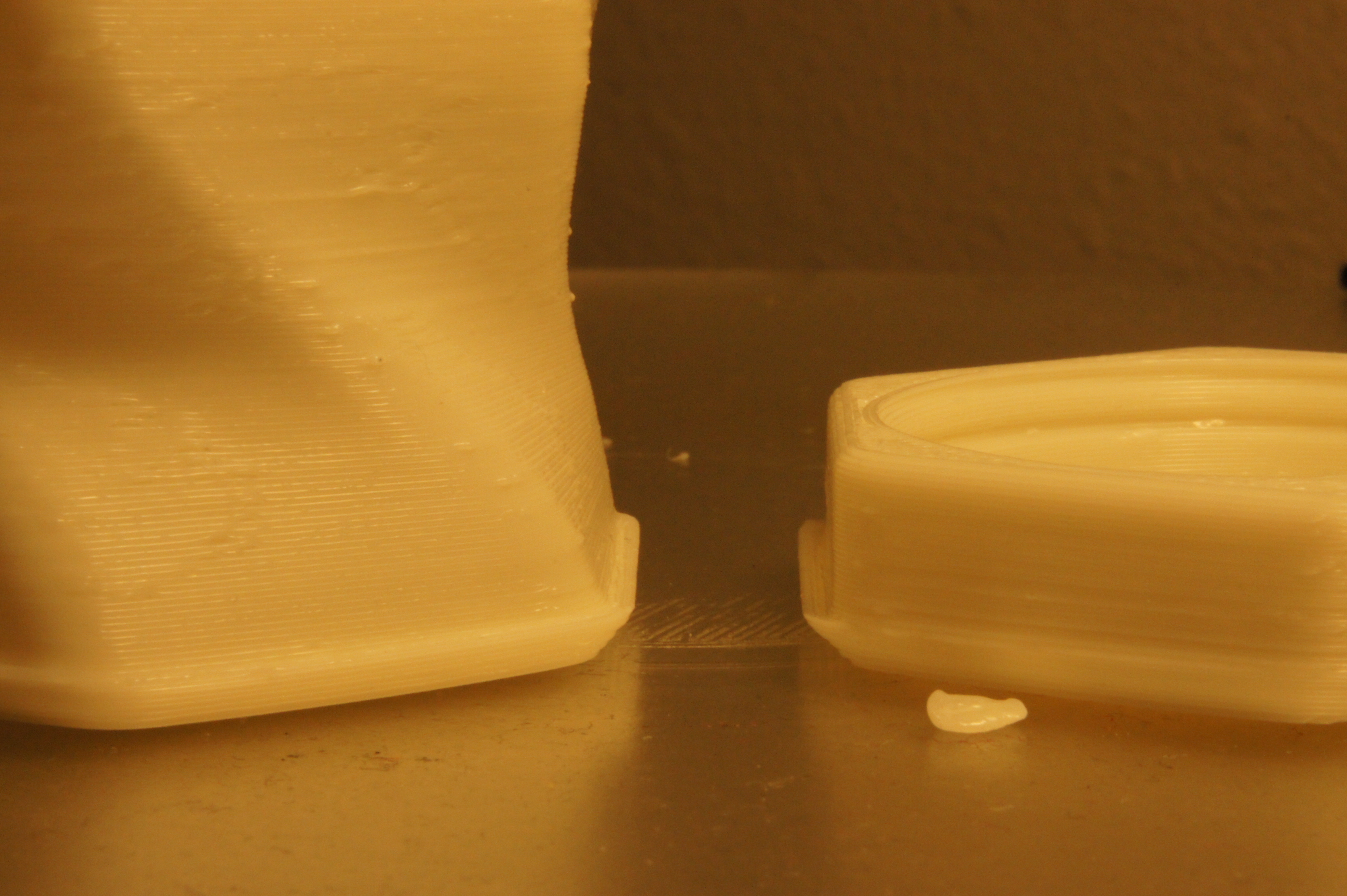

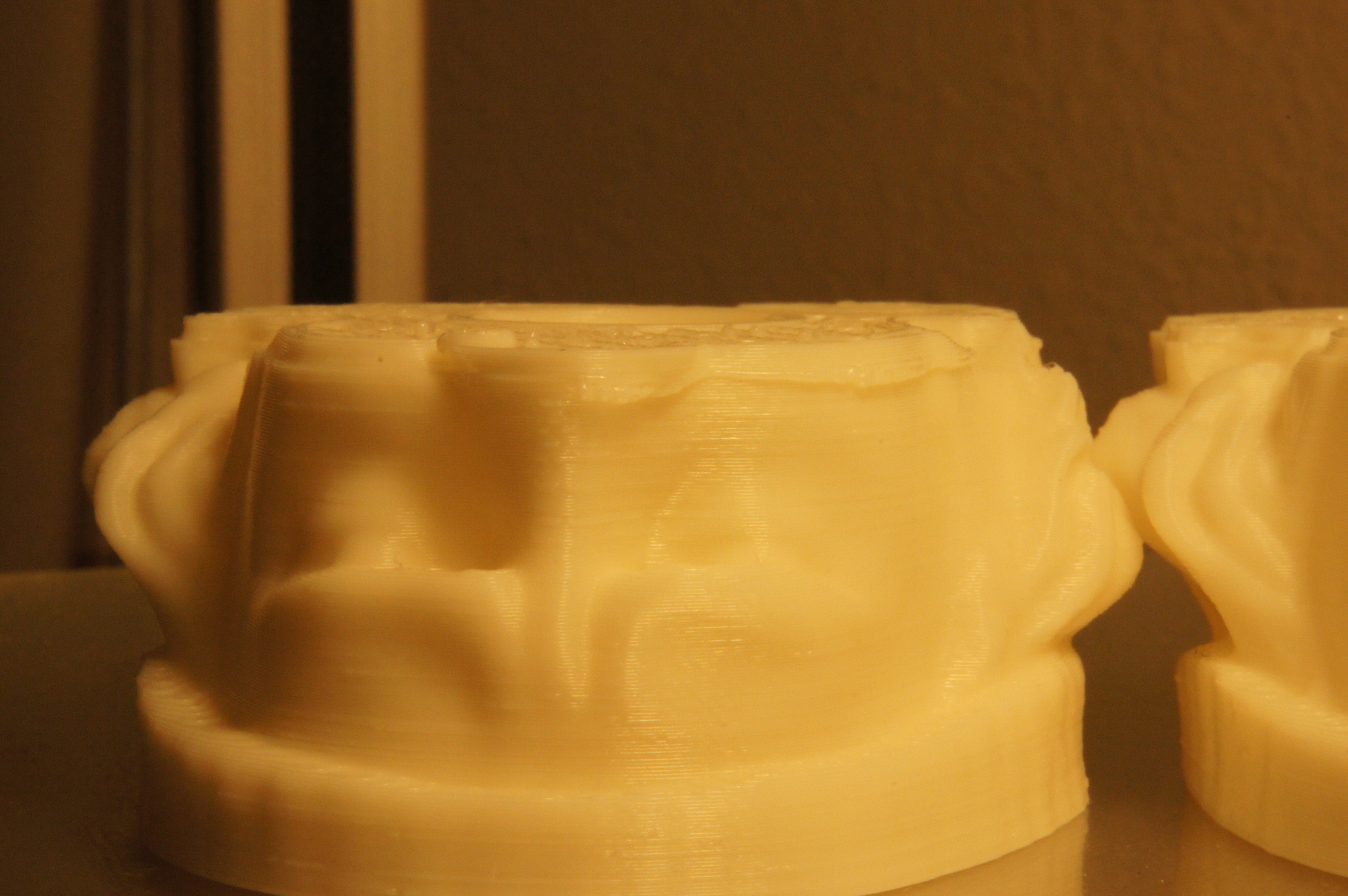

Here's what it did to some of my prints.
First one I noticed something was wrong and thought my hotend was loose but it wasn't.
The slip occurred at 3.3mm high.
KISS, 0.35mm layer height, 50mm/s all around, white ABS @ 230, 1hr 15min. Needs a little more retract. http://www.thingiverse.com/thing:12278 And a Cheech bobble head. Both times at 29.25mm high.
Slic3r, 0.2mm layer height, 20mm/s outer perimeter, 40mm/s perimeter, 65mm/s infill, 25% fill. Still needs a little more retract.

Yeah that's pretty much where the wear usually is. try positioning the head on the table and move it away from the affected pillar, until the wear patch is on the gear.
If a pillar calibration point is high, then as the head moves in the area opposite it can rub on the bed which can lead to the pulley eating the belt.
Plastic pulleys would be less prone to do that.
