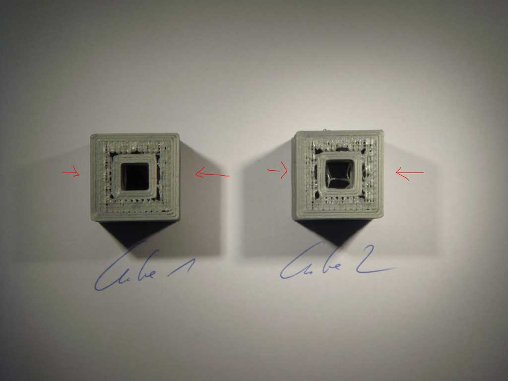

Hi!
I just finished my Rostock Max some days ago and started with printing the Skeinforge Bridge Calibration Cube as recommended in the assembly manual. Apart from some slight gaps in the infill the machine seemed to work fine. But when I did a close inspection of the finished cube I found, that the view from above is out of square (it acutally looks almost like a parallelogram; I found that it is approximately 3-4 degrees out of right angle) and the four columns are approximately 0.5mm displaced. So I disassembled the whole carriage, reworked all the delta arm joints so that everything moves without friction. Then I printed the cube again - and the result was even worse. The second cube is even more out of square.
I did both prints with Repetier-Host V0.84 and Slic3r V0.9.8. All settings as recommended in the assembly manual. And I use the firmware from this page: https://github.com/johnoly99/Marlin-for ... kmax-rambo
Has anyone an idea what could cause this problem?
Thanks,
Sigi

Pictures would be real helpful to see what the print looks like.

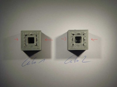

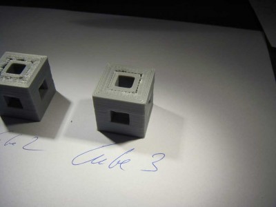

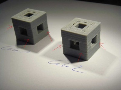

Here are the pictures:
The only difference in printing was the speed. First print was 15mm/sec and second 30mm/sec.

First off, see how that infill doesn't reach the inner walls. It absolutely looks like you have the delta arm blues. You need to remove your arms one by one and find the sticky spot and sand it down. You may have more than one. I only found 1 sticky arm on my printer, but it made a world of difference when I found it. Of course out of the 6 arms, it was the 5th arm I checked (on the Z rail) that was pretty stiff, I knew right away I found my issue.
Go back, try finding the sticky arm, fix it, and try printing some other calibration cubes. I suggest after fixing the arm (and printing a new test cube) - work on single wall calibration cubes next - make sure a single wall thickness is around 0.55 mm, if you get 1mm like me - you might have some settings in Slic3r (which aren't well covered without reading a lot of posts on the forums).
It can be daunting, but once you've gotten this printer calibrated, it's actually much nicer than other printers I've used since you don't need to constantly level the bed. (Or even worse - my replicator at work requires bed-leveling every time I switch between PLA and ABS because the bed's arms sag over 1mm at 90c!).
Good Luck!

The fact the Skew is dependent on speed implies it's probably a sticky arm.
The friction is causing the head to lag behind the requested position, the faster you move the more it lags.

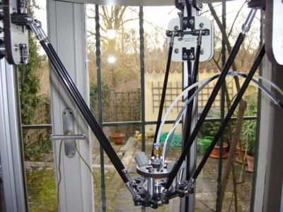

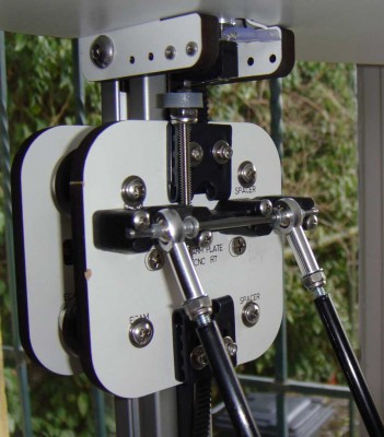

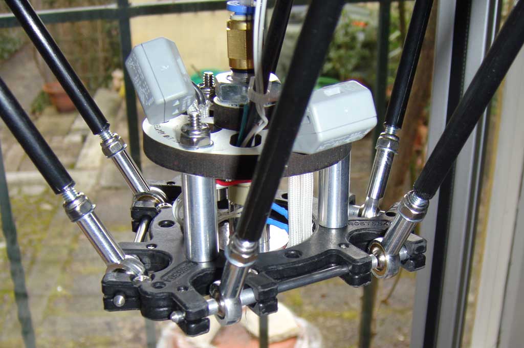

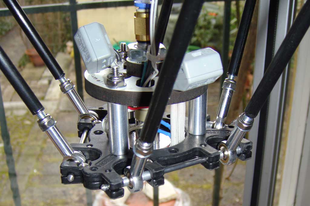

To finally get rid of the delta arm blues I built some new delta arms with ball bearrings and carbon fiber lamitate pipes. The spacers are made from aluminium pipes. So now I definitely have no more friction in any direction.
(You can also see improvements on the end stop adjustment screws so that they actuate the switches more reliably. I have attached the .stl file.)
To show if the effort was worth it, I will print the calibration cube again and post pictures asap, right now I am fighting with the LCD screen. :evil:

I got all the parts at our local model building store:
http://shop.lindinger.at/product_info.p ... anguage=en
The rest is a 3 mm steel wire, an aluminium pipe that fits over the steel wire to make the spacers, a 4 mm carbon fiber laminate tube, 12 pieces (45 mm each) of 4 mm threaded bar that I glued into the carbon fiber pipe with epoxy glue, some m4 nylon lock nuts nuts and 3 hours time.

This is exactly what I wanted to do to mine.
How much slop is there in the system now (if any). My experience with those type of joint is they tend to have a little slop in them.
How is it working?

The slop is less than 0.5 mm. This could probably be improved by putting some varnish on the 3 mm steel wire so that the ball connectors fit even more tightly and you can preselect the ball connectors (I have two that have a minimal slop.).

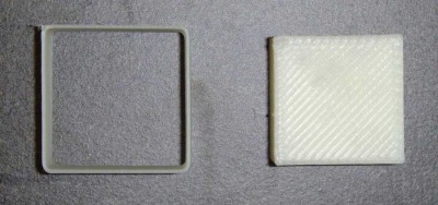

Here are my latest calibration prints. The wall is 0.54mm with a 0.5 nozzle and the infill on top of the cube also reaches the perimeters now.
Here is what I did:
1. I changed to Polygonhell's firmware. Much smoother movement of the stepper motors.
2. I used Cura for slicing.
3. I used a fan for cooling the print. That is how I got the walls straight.
