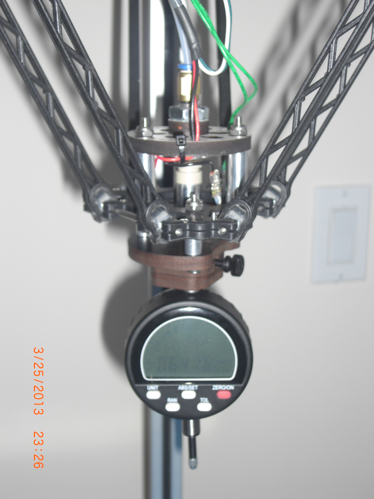

by cambo3d
if you had a dial indicator on the end, you could see as the platform moves where there are high or low spots.
something like i did here. but I did it manually. I'll try that script when i get my machine back together.

I have one of these I am about to modify for use.
The spring the forces the plunger down was easily removed.
There are 3 screws on the far side of the photo that hold the blue part on.
Gently lever the blue part up, and remove the internal spring.
I just have to cut the 'C' part and make a mount for this to attach on the 'carriage'
http://www.harborfreight.com/digital-th ... 66319.html
[img]http://www.harborfreight.com/media/cata ... _16276.jpg[/img]
