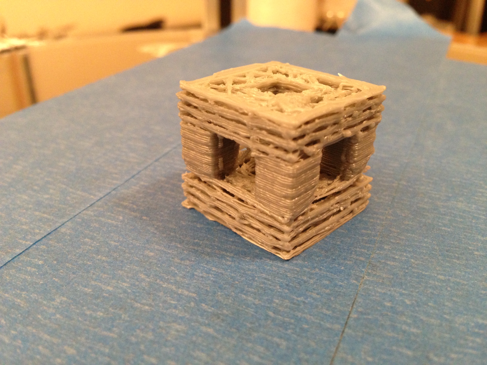

Thanks for your help, I'll dedicate the first print to you!
Re: New Printer Software help
no thanks , i know what first prints look like... lol =P
