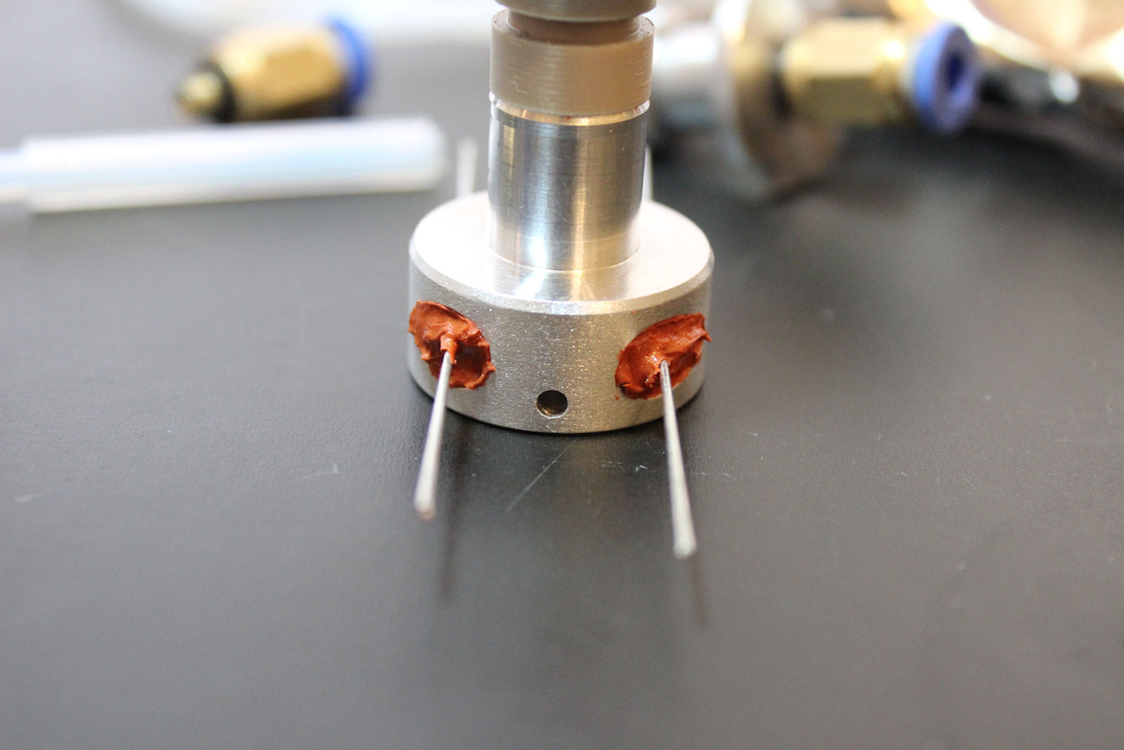

I am in the midst of assembling the hot end for my Rostock MAX and my "perfectionism" has slowed progress to a crawl. In the assembly guide "geneb" indicates that the thermistor should be installed in one of the holes perpendicular to a heating resistor. That would be this location (see middle of photo):
Two things occur to me. In this location the thermistor's mounting is very precarious; it's going to take a lot of RTV/Kapton tape to hold the thermistor in place. More importantly (I think?) the thermistor will be measuring the temperature of the heating resistor, not the hot end.

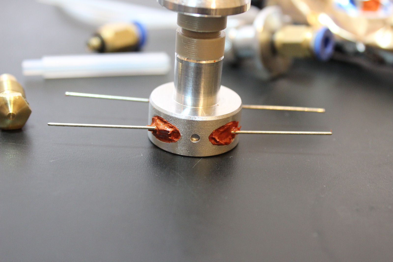

There is another hole in the hot end where the thermistor can be mounted (see middle of photo):
This hole is much deeper (>5mm) and will easily accommodate the thermistor with PTFE tubing on its leads. The depth of the hole is such that the thermistor will contact a surface about 1mm from the threads on the nozzle. This allows the thermistor to meter the temperature of the nozzle almost directly (a more reliable measure of the temperature of the nozzle). With a nice dab of RTV the thermistor will mount very securely. I'm inclined to mount the thermistor in this second location.
Am I missing something?

I hadn't noticed this before you mentioned this. I thought the holes were the same depth and its too late for me to check mine since I already mounted my thermistor. I just picked a hole and mounted it.
I would think the one closer the brass nozzle would give you a more accurate reading of the nozzle temp. Like you say
edit: I just realized the other hole your talking about in your first picture ( that looks like a machining error or maybe a different version) . I dont have this on my hotend.
The one in your last picture is where i mounted mine. I have two of these holes, one on each side.

The holes that intersect the bores for the resistors is a relief hole. It allows air and silicone to escape from the bores as you insert the resistors. At the build event, it was suggested to inject the silicone into these side holes to insure there were no voids. These new openings are a relatively new addition suggested by Eric (?) to reduce the possibility of hot spots due to trapped air pockets.
The larger deeper hole is for the thermistor.

21.10 – The thermistor is installed in one of the two small holes drilled perpendicular to the resistor chambers on the Hot End. Fill one with RTV and press the thermistor in to place as shown below. Make sure you’ve let the RTV cure at least one hour before moving on to the next step.
One of the hot ends I received with my order (I bought a dual extruder kit) has a single deep hole drilled "parallel" to the two heating resistor bores (see second photo, above). It has holes drilled "perpendicular" to the heating resistor bores (see first photo, above) - that's two "perpendicular" holes. When I read geneb's assembly guide guess which holes I thought he was referring to...

When I mounted my thermistor I used the hole that intersected the resistor. I am on the fence of which would be more accurate. The one next to the resistor will relay the temp of the resistor back to the Rambo quickly. This would result in a stable temperture in the hot end and if you are concerned about melting the PEEK you could limit the max extruder temp easily. Downside to this is if one resistor fails you may be reading the side that is bad therefore the cold side of the hot end.
On the other hand using the deeper hole next to the nozzle gives an accurate reading of the nozzle. This could suffer from some slight thermal lag of the temperature of the resistors (probably not significant as the mass of the hot end is relatively small). If thermal lag occurred between the resistor and thermistor, based on the amount of thermal lag this could result in the extruder over heating. I am not sure of the programming of the firmware but I think the autotune feature is supposed to account for some of this lag.

Also, I opted to use the deeper thermistor hole parallel to the resistors. I felt this gave me a better mounting point to install the thermistor and guaranteeing that it wouldn't come out or short as easily. The holes perpendicular to the resistors didn't seem deep enough for mounting.
