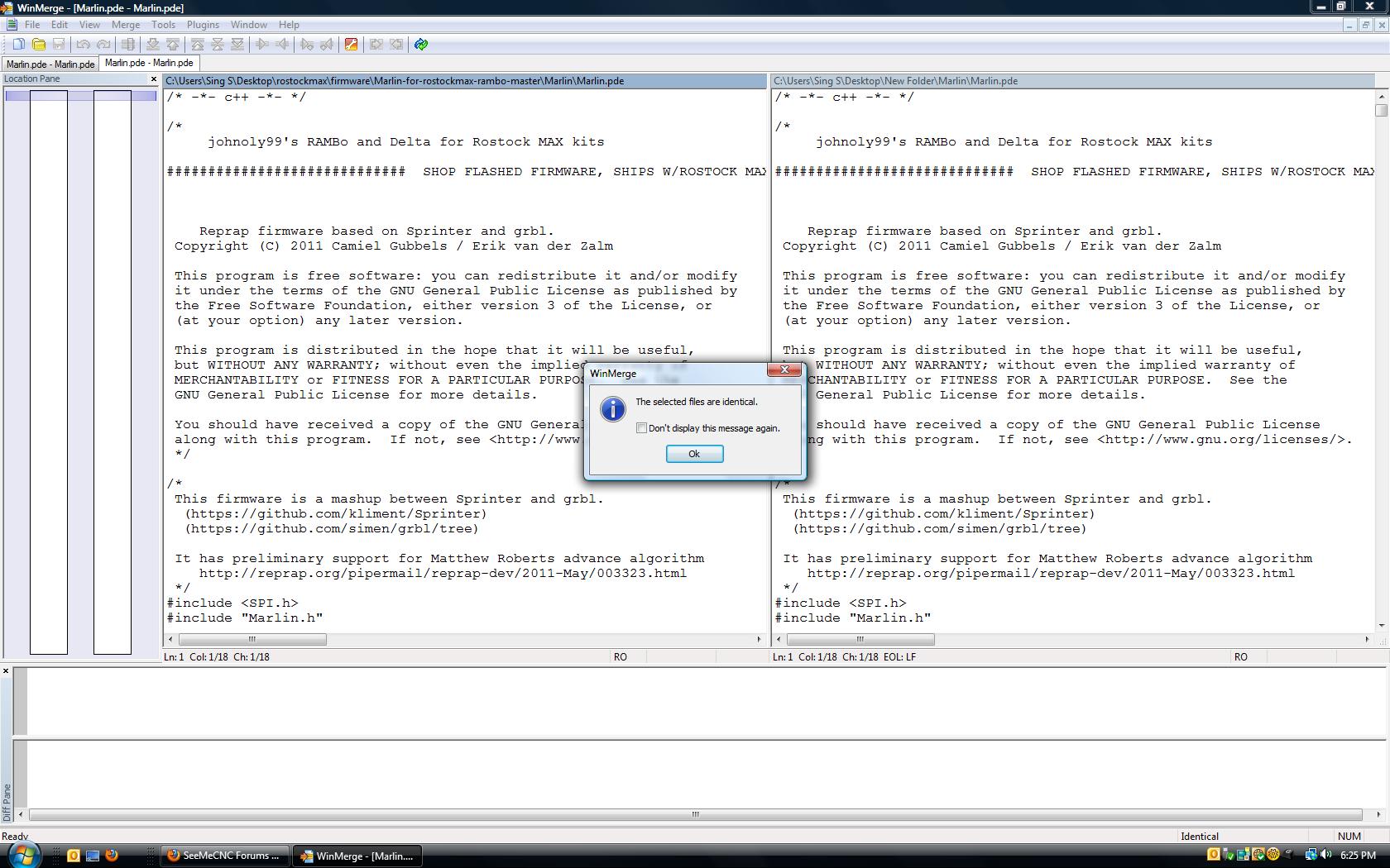

Hey bill,

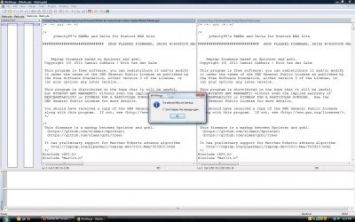

I compared yours to mine using winmerge, the both our firmwares are exactly the same at least for the marlin pde. Although I have not powered up my board yet. I'll check the other files required files for the lcd to work.
I wonder if the problem lies in the adapter board or wiring.
have you tried maybe swapping the connectors around, John says it wont hurt the board,

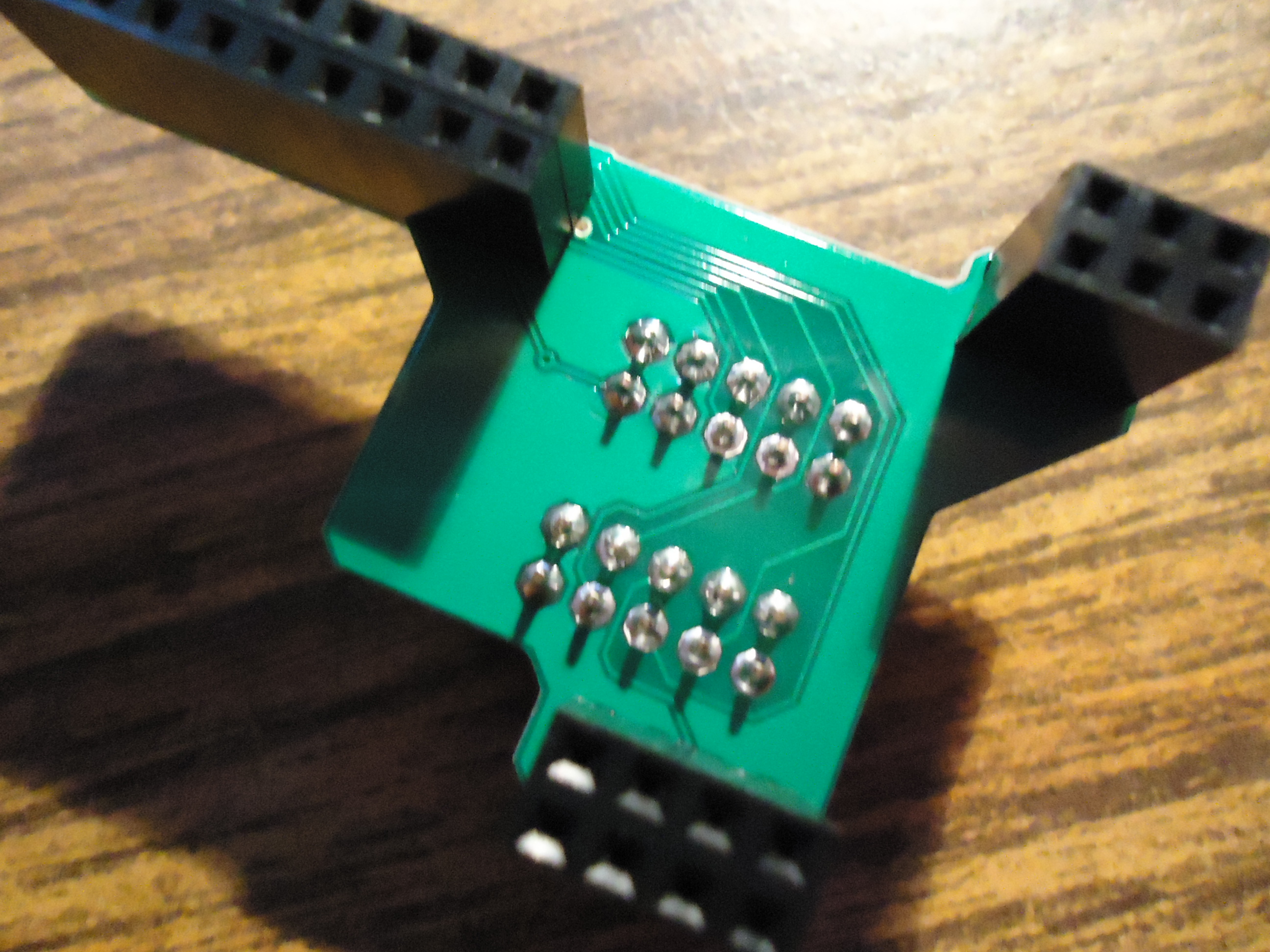

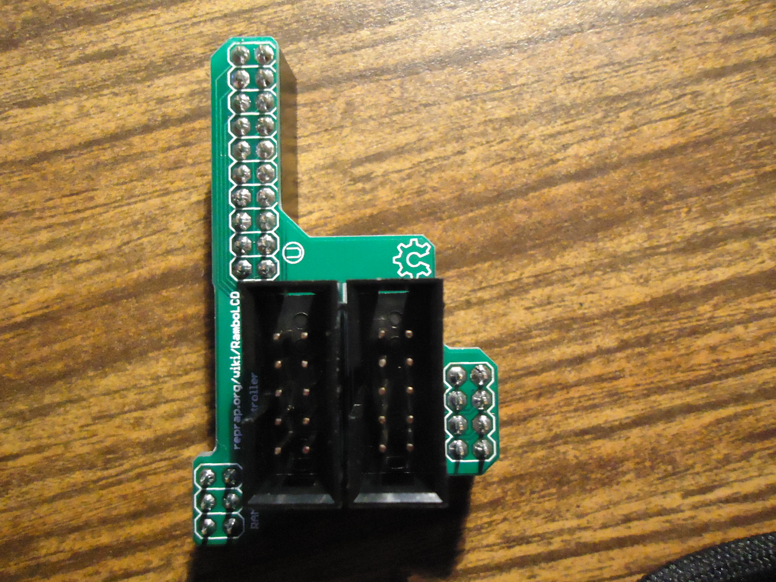

can you post a picture of your adapter board?

Here are the pictures of the adapter, John Olley soldered it himself and it looks perfect to me, I have tried to switch the cables but the screen won't come up at all that way...
I sent the file to John himself but he hasn't replied back yet.
Thank you for taking the time to look at the file and I would love for you to try it when you can....
Bill

then its got to be the firmware, that photo matches my board also. If john is using this board and its working, he should be able to give us firmware to use it.
If yours isn't working, mine probably wont work either but imma give the firmware another look.

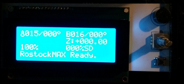

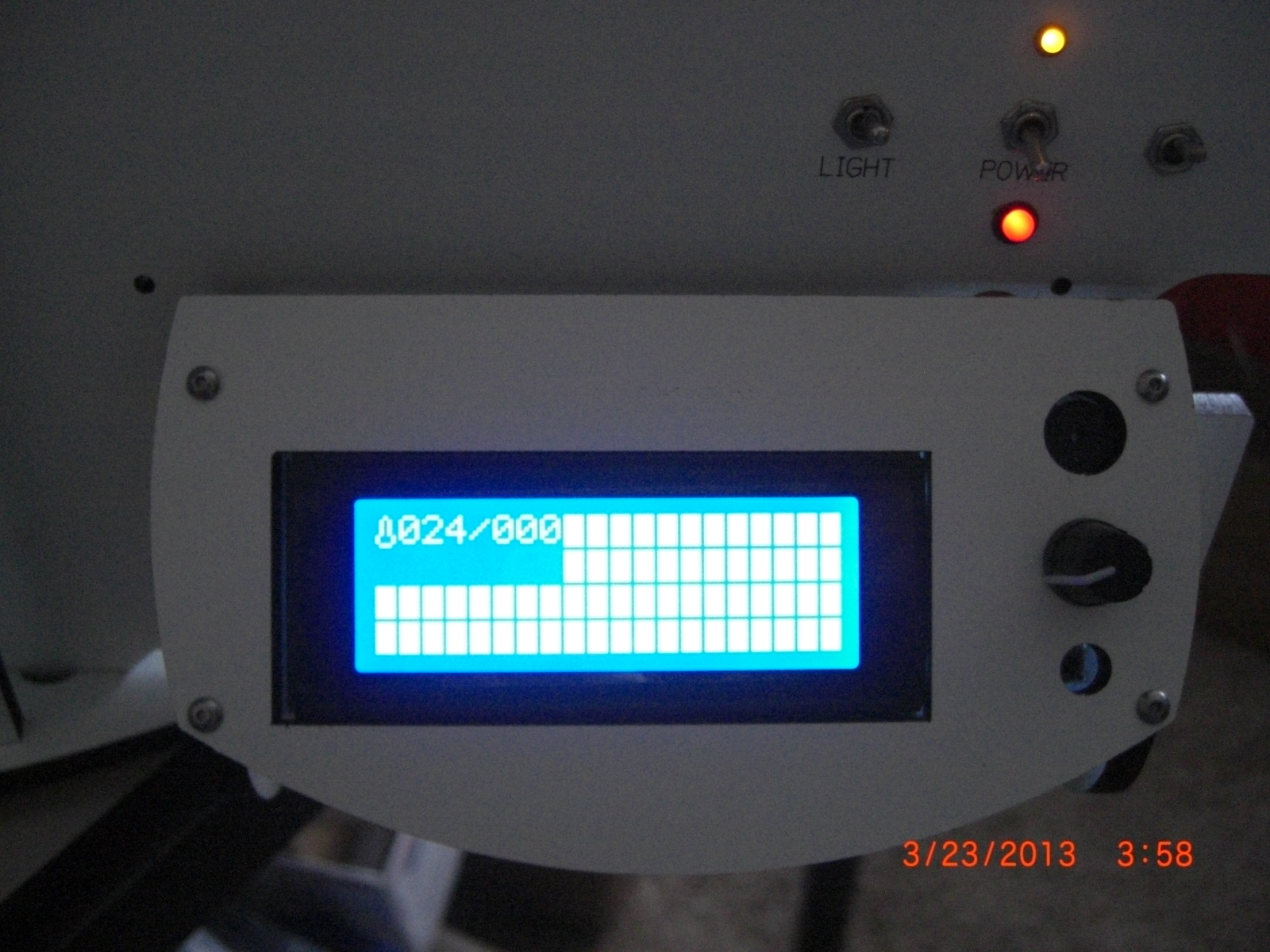

well just did a power up test and my lcd screen does the same as yours, just shows boxes.
I'm going to try it with a different arduino, arduino 22
cambo3d
Posts: 1057
Location: Florida
Re: LCD screen not coming up after successful flash
Post by cambo3d »

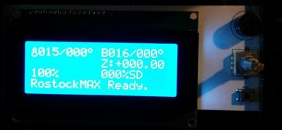

so i uploaded the firmware with both arduino 22, then tried arduino 23, I get the screen to show some letters, but i'm still getting boxes also
is this normal?
this is what the rambolcd wiki picture shows

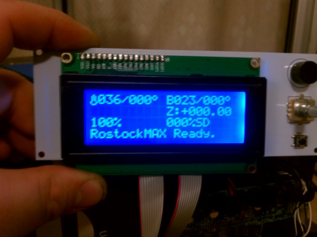

I have an original Rambo from the indiegogo lot. have an early LCD too that didn't come with the rambo adapter.
I made up the lead as per the geneB LCD manual, and then made the same changes to the Marlin firmware to enable the LCD. It worked first time, compiled with arduino 23.

Might be a bad LCD, I have a 4x20 LCD I bought elsewhere that won't display anything on the bottom line, the LCD is just a serial device, normally I'd expect if you get anything displayed it would all work.
cambo3d
Posts: 1057
Location: Florida
Post by cambo3d »
I'm sending it back to seemecnc, for a replacement.

Post by cambo3d »
yep i got it working, it was a bad lcd, verified with a known good lcd. http://forum.seemecnc.com/viewtopic.php ... &start=160
