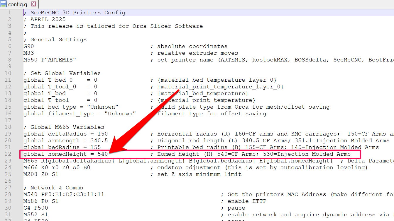

Here's the firmware on the SeeMeCNC github. Any SeeMeCNC Duet2 controlled printer will work with the ARTEMIS firmware files. The Artemis firmware files are the only files I will be updating. BOSSdelta, RostockMAX v4, etc., users need to open the config.g and edit the printer height for their machine.
SeeMeCNC Github New Firmware
The following picture shows where to change the height, the printer radius, and other settings that need to match your printer model & arms (molded or carbon fiber).
edit homed height variable.png (86.14 KiB) Viewed 53248 times

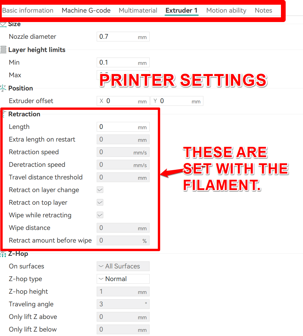

Pressure Advance DOES NOT BELONG in the firmware config.g. This is because different filament types & nozzle sizes have different compressibility (hysteresis) and require different values for each combination. We can have the same roll of PETG and change from a 0.4 nozzle having 1.2 pressure advance to a 0.7 nozzle which requires about 0.5 pressure advance. It was just this morning, I decided to zero "printer settings" and stick with all of the setting overrides for the filament and nozzle combination. Please give feedback if you have a different idea, just maintain your sanity when trying different things. :)
Printer settings
Filament settings
