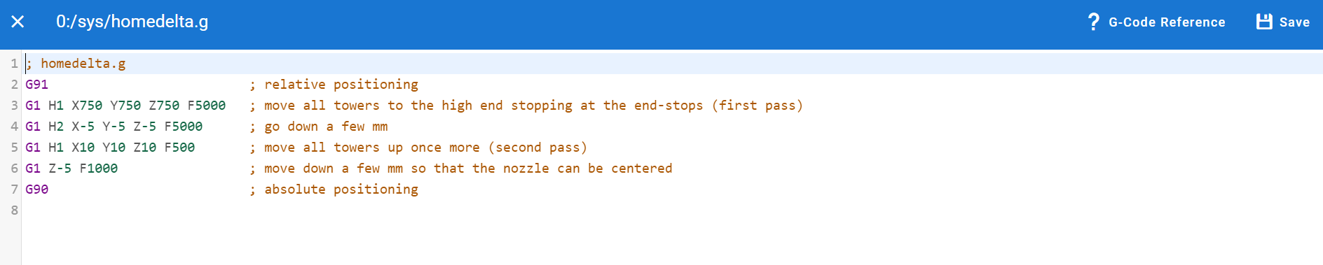

Delta calibration should be G32, not G35.
Can you post the contents of your homedelta.g file?
tnx.
tnx.

Re: BOSS Delta 300 - One Belt stops functioning
Hi gene - see below:
; homedelta.g
G91 ; relative positioning
G1 H1 X750 Y750 Z750 F5000 ; move all towers to the high end stopping at the end-stops (first pass)
G1 H2 X-5 Y-5 Z-5 F5000 ; go down a few mm
G1 H1 X10 Y10 Z10 F500 ; move all towers up once more (second pass)
G1 Z-5 F1000 ; move down a few mm so that the nozzle can be centered
G90 ; absolute positioning
Also attached a screenshot.
The calibration is G32, my mistake. I run it from the dashboard on the Duet Wifi Control under "Compensation & Calibration"

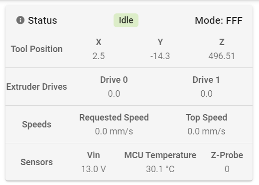

I also noticed the X/Y aren't at 0 after homing. Not sure if that is having anything to do with the issue.
- Capture.PNG (20.42 KiB) Viewed 18390 times
The X & Y values are kind of high - on my Boss 300, they're both at 0.4.
I would try deleting your config-override.g file and then re-run the calibration. If you still have the problem, post your config.g file and I'll see if I can spot an issue with it.
