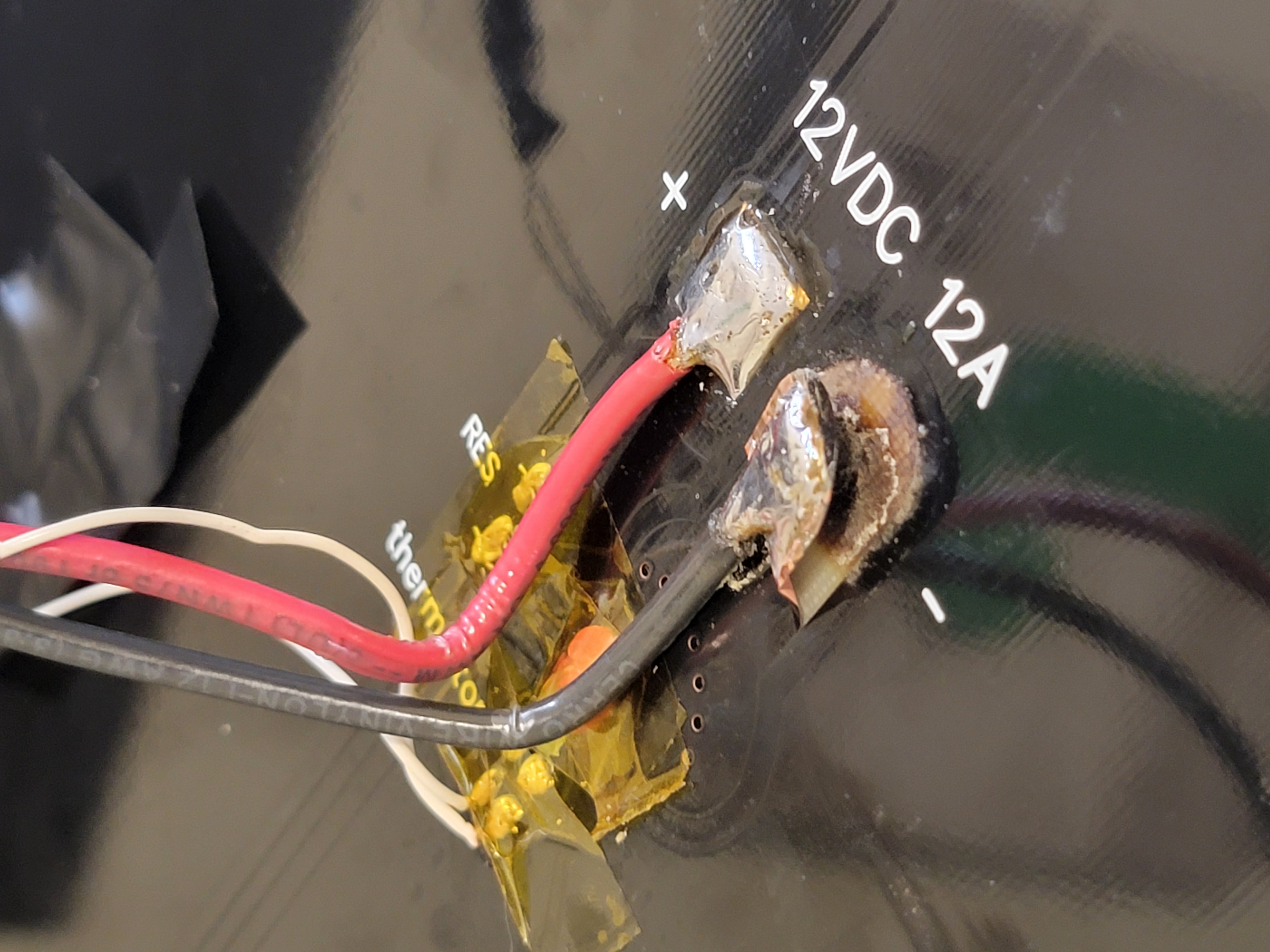

Hi, Ive had my V2 since 2015, its been a wonderful time together, but lately im having an issue i cant solve. If the bed gets a current put to it ( to preheat) the software crashes. This is not random, it happens every time. the fuses on the RAMBo are fine, the wiring is not decaying. I recently updated the firmware from SEEMECNC's repository, and have a bone stock EEPROM.
Any Ideas?
Is my board tater'd?

I would attach a voltmeter to the power supply and then try heating the bed. I suspect the power supply isn't capable of putting out enough power (or the heated bed or its wiring is shorted) and the power sag causes the controller to crash.

Hi. Thanks for the reply. It was indeed a broken curcuit at the bottom of the heated bed. Is it possible to buy a replacement for the onyx rev7?
Re: Rostock Max V2 Preheat Causes Software Crash
I would send an email to support. I'd be surprised if they didn't have one or two on hand.
