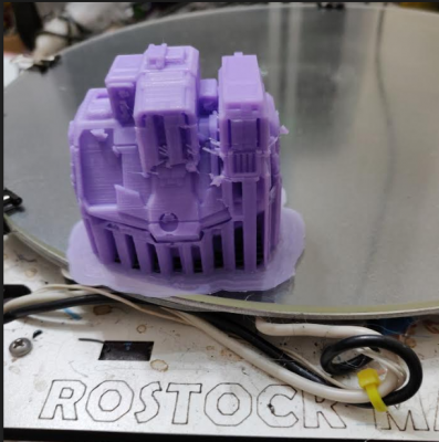

Hi there, I have an issue with layer shifting with my Rostock Max V2. I have researched this issue for weeks without much in the way of results. Little changes here and there and still bad results.
About a quarter inch from the plate, things shift to the left. I messed with the belts and it seems a little better, but the problem persists. It seems like there is a little wobble in my most recent print until suddenly it straight up separates.
Rostock Max V2
Heat: 196 / 70 PLA
Print Speeds: 45ms, 150mm/s travel (tried to fix by lowering this from 200)
Belt tension: no idea how to measure but I easily fit my thumb between the belt and tower
Motor Curent: 140, 140, 140, 130 (default)
All joints seem pretty tight. Hot End secured.
Motor type: not sure but says Automation Technology KL17H... on sticker.
Will post a picture in a moment.

Re: Layer Shifting
Try bumping your motor currents up a bit. Here's how:

Re: Layer Shifting
Thanks for the advice. Wasn't sure if that was what I should do. Set it to the 155, 155, 155, 165 values which I believe is where it should have always been. I can try bumping slightly more, because it seems to be 'better'. The result of the change is that it is a little wigglier all the way up, but not nearly as extreme a shift.

Re: Layer Shifting
165 also has layer shifting. I'm wondering if the 32 Jerk and 1800/3000 accelerations need to change.

Re: Layer Shifting
Well I tried lowering the acceleration and jerk and it seems to be about the same. At around the same height, things shift pretty hard then it straightens again. So I tested the towers, moved the effector around and figured that one tower was a little tight, one a little loose. I reset to Z position, which was oddly a bit low, but I figured it had to do with moving things by hand. Homed the printer and started printing. For the second time in a week, my printer head dug into my PEI and tore it up pretty badly. Not sure why that keeps happening. So I was pretty sure shifting would be better this time, and boom. I think it's time to throw in the towel and admit I just don't have this kind of skill. It seems so easy but I will likely be better off with an 'out of box' solution like the FlashForge or something like that. Happen to know a good place to sell used 3d printers? A smarter person than me could probably do well with this, given its many upgrades I added to try and fix the darned thing...

Re: Layer Shifting
Important update:
When moving the effector around to feel for a snag I noticed something funny. My Y tower would slip back down if I went toward it so that the Y-carriage was considerably higher than the others. It would fall about 1 inch. I tightened it up to where it would only slip a little at the extreme edges. We'll see... I have to fight that 'throw money at the problem by buying a new printer' feeling

Re: Layer Shifting
And as for the file, I can get probably put it in my google drive and share it in a pm.
						Re: Layer Shifting
Hmm,
Try removing those fans and the LED ring to see if the extra weight is causing problems. And you should still be able to bump up your motor currents some more.

Re: Layer Shifting
No fans while printing PLA *aaaaaaaahhhhH!!!!*
I can try that for sure.
One last bit of information: Shifting only really happens on wider prints. Oh and I noticed that the hot end temperature, though set to 196, seems to drop to around ~193. Probably nothing but still not cool.

Re: Layer Shifting
Err...what do you mean by sprockets? The little gears on the motors? I checked everything I could for tightness but that was just the jiggle-test.

Re: Layer Shifting
Haha I also have purple! I printed an elephant for my son about a year ago and it came out great. Hmm if you happen to go to the post office I'd definitely pay for the shipping + some but I don't want you to go to any extra effort.
That does look pretty good. Would you mind throwing a few of your slicer settings? I'm using cura, btw
PS I'd be happy to get you the other files if you want to finish the robot!
Update: I have a theory! And that is: you are onto something about the weight of the effector & friends.
I upped the current to 175 and it seems to have minimized layer shifting. It's there. tiny bit.
Tomorrow I will remove a fan and try with same settings. Then 2 fans. Then 2 fans, 165 current because 175 is HOT.
But something I am noticing. Lots of scraping. Particularly when hitting small pileups but not always. I thought that retraction at 4.5, 60mm/s with Coasting enabled and a negative restart of .06 would help with that but it still occurs. Eventually I had to stop the current print because it's just too wobbly, but no *major* shifts.
And, yeah, ease up on the motor current.

FYI, if you're not doing a z-lift on retract (and thus travel), the nozzle could be striking the print and causing the layer shift.  I seriously doubt it's the weight of the effector platform.  Your travel speed could also be a factor - anything over around 220mm/sec on a RAMBo can be problematic.
				ExplodedZombie
- Posts: 118
- Joined: Mon Nov 21, 2016 12:30 pm
Re: Layer Shifting
My travel speed was 120 but I bumped it up to 160 because 120 is sad. I'll try using z-lift and see what's what.
					Last edited by ExplodedZombie on Tue Nov 27, 2018 1:10 pm, edited 1 time in total.
				ExplodedZombie
- Posts: 118
Re: Layer Shifting
As for print size I'm printing at 60%
I just thought about something. The extra amount on restart (retraction)...I have that set to something like .4. Should that be -.4 (cura turns this orange)? It doesn't specify if positive means it pushes extra and negative means it holds back. If that is the case, though, it could explain why I have blobs on the top of my prints.
2 prints in a row have had very slight x/y shifts here and there, but one major Z shift. Tightened the belt since I discovered the head moved. Added Z-hop but I'm worried about that extra amount. Still hearing scratching even with 1mm hop
Super update: watched the print more closely and it really looks like every now and then one of the big moves that doesn't trigger a retraction leaves behind a length of filament, which I've seen one or two get dragged around until it piles up into a large hardened chunk that makes a loud sound when hit...
Re: Layer Shifting
I don't think so, mine is set to 0mm. But you could try it, just be sure to make note of your changes.
Ahh, next time watch the extruder and see if it is actually retracting. And it also has a screw that might need tightening.
Re: Layer Shifting
...and when hit, it can cause lost steps, which causes layer shifts.
