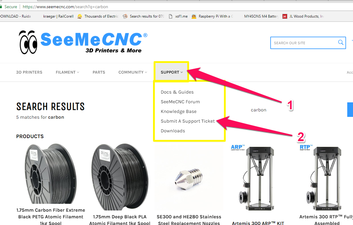

Sorry you're having trouble. Didn't see any open tickets in support. If you're still having trouble, just drop us a line. We do our best to respond within 24-48 hours. We work M-F, 8am to 4pm, Eastern time zone.
There are no electrical problems I am aware of. I see you purchased an ARP Artemis. Check for pinched wires when mounting the linear axes to the top and bottom assemblies. We have seen a few machines where customers have accidentally pinched a wire.
Official technical support is here:
SeeMeCNC-support-request-ticket

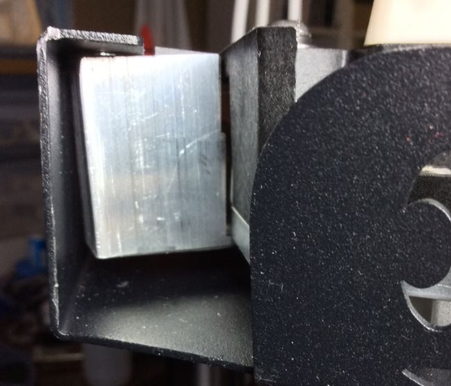

I just finished installing the grounding kit.
I had some issues getting screw holes in the aluminum grounding blocks to line up with holes on the enclosure.
The corners of the blocks hit the enclosure before the holes come into alignment, so I had to file down the outer corners of the blocks.
I thought I should warn other users of this. Don't expect it all to just drop in place.
I am really tempted to take a saw to those corners of the lower enclosure plate. That thing is a serious pain to remove and reinstall. I hope this will be redesigned for future revs.
