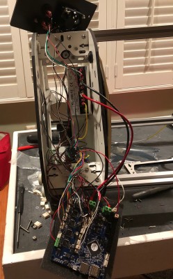

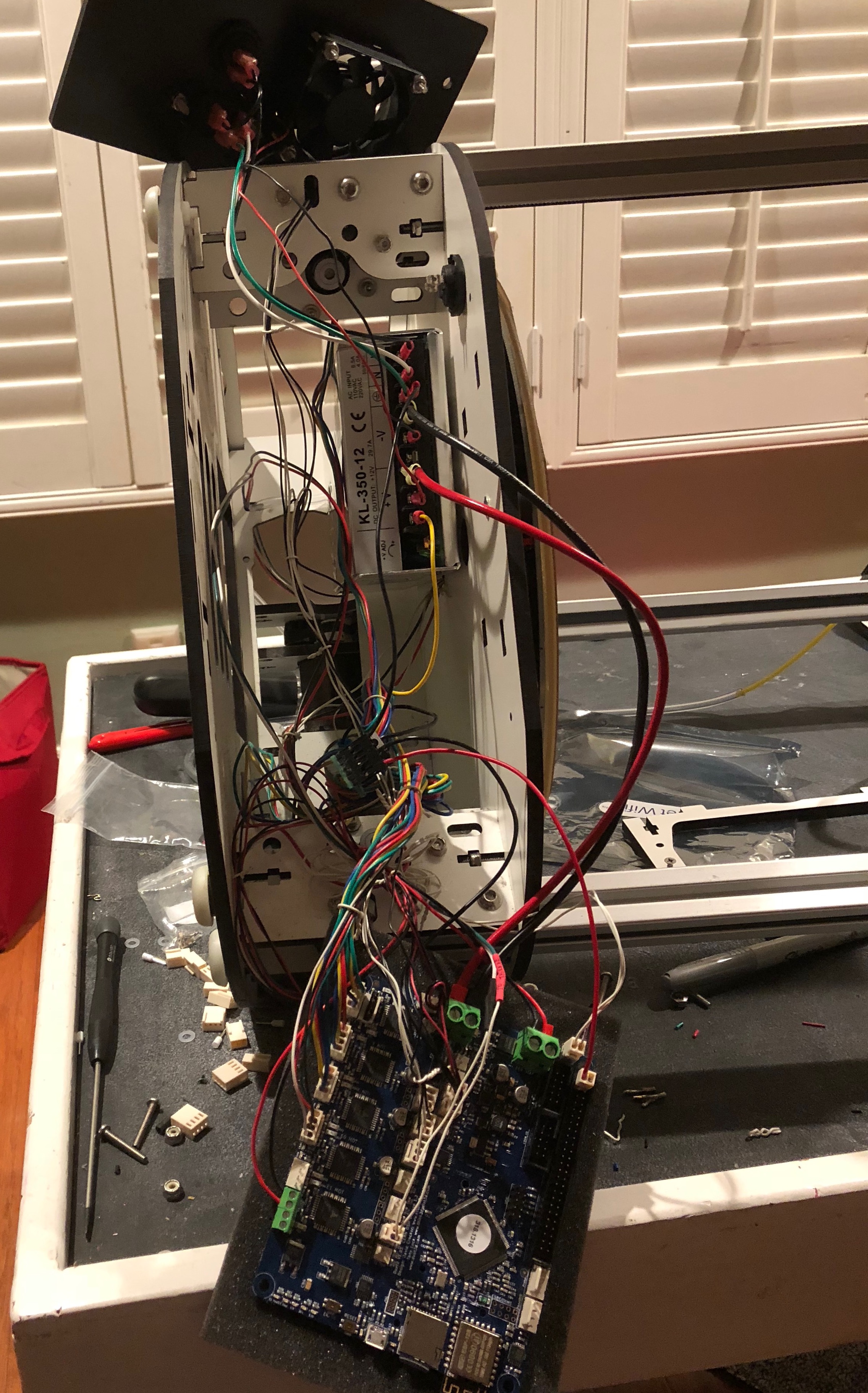

Me and my Rostock V2 have been on many adventures together. I swapped to a nimble and couldn't get the retractions working properly with the RAMBo so I took a break and wandered into SLA land. It's been fun having no layer lines, and less fun cleaning expensive resins, but now it's time to get back to my old buddy.

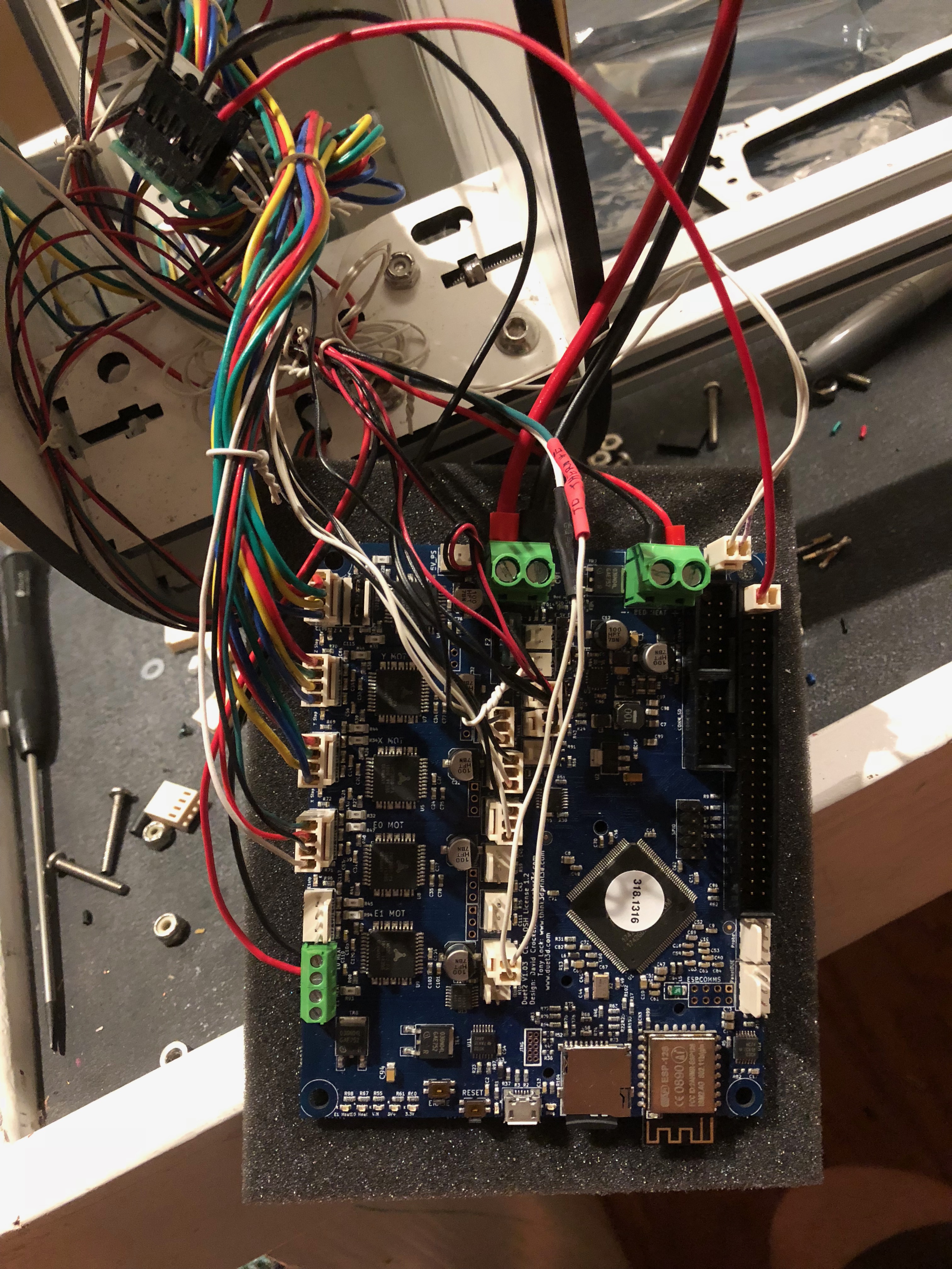

Most recently I've upgraded to the better power supply, and swapped out the RAMBo for the duet WiFi.
I've gotten mostly through it, doing mostly software now, but I had a few questions for people that have done this already:
1. The new power supply has added a new fan to the base thats wired directly to the power supply and is on full time. It runs at full power and is very noisy. I was wondering if there is a way to turn it down?
2. My peek fan is now always on, and doesn't seem to be associated with the temperature of the hot end any more. I couldn't find the place to adjust this.
3. I didn't get the panelDue, so I have no screen now. Is there a way to use the old screen? I haven't gotten to setting my Z-height yet, and I don't have a probe, I'm not quite sure how I'll go about it. Maybe punching in the G-code manually, unless the Duet Web Interface has some built in function for this.

1) Not aware of anything but I'm not familiar with your specific PSU. I'm running all Meanwells now. Putting the side covers back on would probably help.
2) See https://reprap.org/wiki/G-code (the g-code reference) for M106 and add the command you come up with for your preferred behavior to your config.g.
3) As far as I know, the screen that came with the v2 is not compatible. If you have an old tablet lying around, you can just use it with the web interface and the experience comes pretty close, arguably even better since the controls aren't tethered to the machine. You can prepare the set of commands you need for leveling as macros and just run them when needed.

I'm going to mostly agree with IMboring. Now, you can buy quieter fans, such as Noctua or Silenx (Little bit pricy, especially on the small diameter fans.)
2) It should only activate when the hotend is above 45C by default (if it's connected to fan1) Try M106 P1 T75, where 75 (AKA, whatever number follows T,) is the trigger temperature for fan 1 (whatever number follows P)
3), while the Duet has a connector to allow hardware compatibility with those sorts of screens in theory, AFAIK, the firmware side support has not yet been implemented, and considering that the web interface is pretty much top notch (If I actually had a connection between my workshop and my desktop, I would probably never use the touch screen. Unfortunately, the touch screen is a lot cheaper than trenching in cabling, so that's what I went with)

The PSU I have installed is the one sold by SeemeCNC, the Keling 12v 29amp. Upon further investigation, the noisy fan is actually the one that's built into the PSU. I'm not sure what can be done about that. Would be it be strange to take it apart and put a quieter fan in it?
Also of note, the board cooling fan is pushing so much air out, I'm concerned its cooling the heated bed off.

Some things I've learned: The noctua fan is very very quiet, but also it doesn't push as much air, so that's a trade off. One that I'm willing to make though. I also learned that noctua uses an inline resistor on their red wires to reduce fan speed and therefore additional noise. It's a handy trick I might use in the future for reducing noise on a fan if it's over cooling anyway.
I also took the PSU apart, and it was very easy. Just 6 screws and pull the case top off. Inside is a 12v 60mm x 15mm fan. You can actually fit the 25mm thick noctua fan in there but it's a tight squeeze. I couldn't find a noctua that was 15mm x 60mm.
I also learned that my specific PSU that SeemeCNC shipped me was defective. The fan was always on a full blast and it's not supposed to be. They've sent me a new replacement PSU. Good customer support!

I don't have a panelDue or a zprobe so I did all of the calibration manually as described in the RMV2 setup manual. I got jammed up on setting the z-height but figured out you can send a G30 command on the web interface and a handy popup lets you control the Z. At first I was wondering why my z wasn't changing, but I realized the G30 was just a helper. I still had to then take that value and minus it from the M665 H value (ended up at 387.9) in the config.g file to set my new z-height, then reset the board. Not too big a deal since I don't do that very often. Anyway, I hope that helps someone else.
