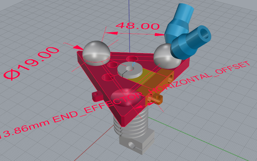

looking for stability in my effector I found this info.
http://reprap.org/wiki/Delta_geometry
I will show results. I hope to improve my first layer.

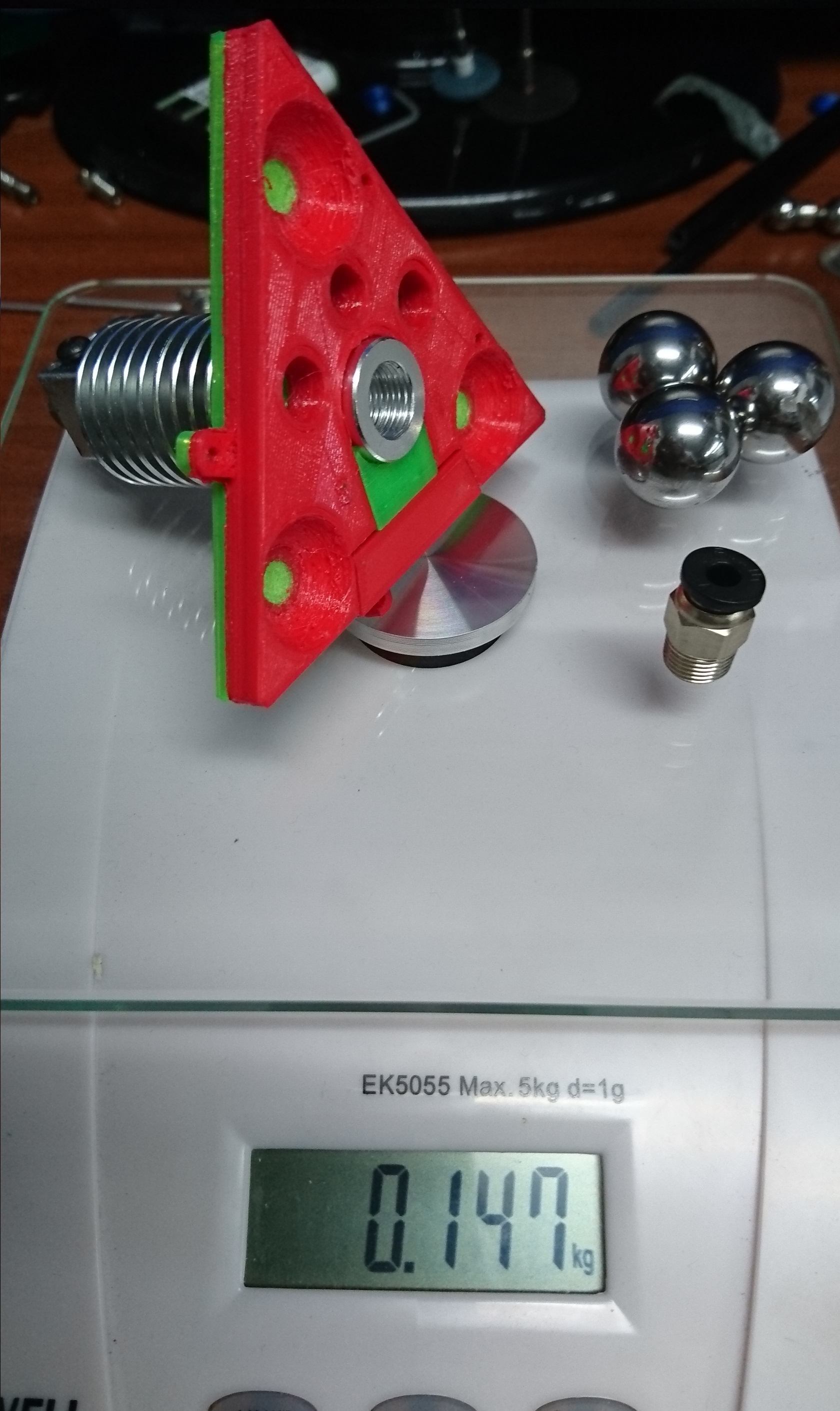

My first Test.
I do the g33 with low speed to see if my platform tilts when the extruder touches the bed ( :D :lol: very happy the platform now stays completely straight.
with my previous system the platform was tilted a bit when it touched near the ends of the bed.
The Radius chnge from 137.35 to 158.50
and negative values between the towers disappeared.
I am Happy with the results. I will put some numbers.
