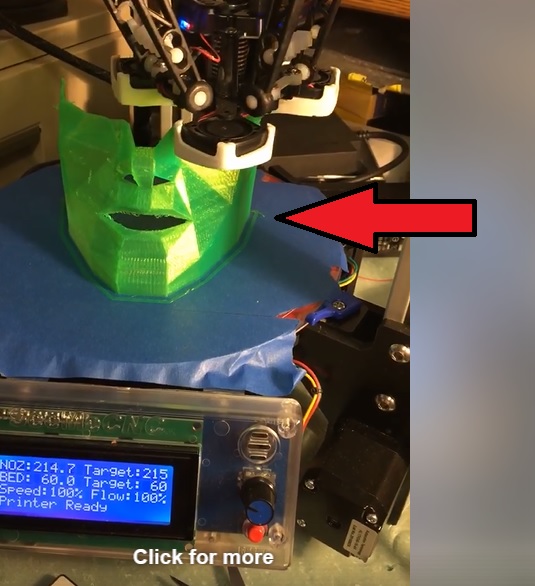

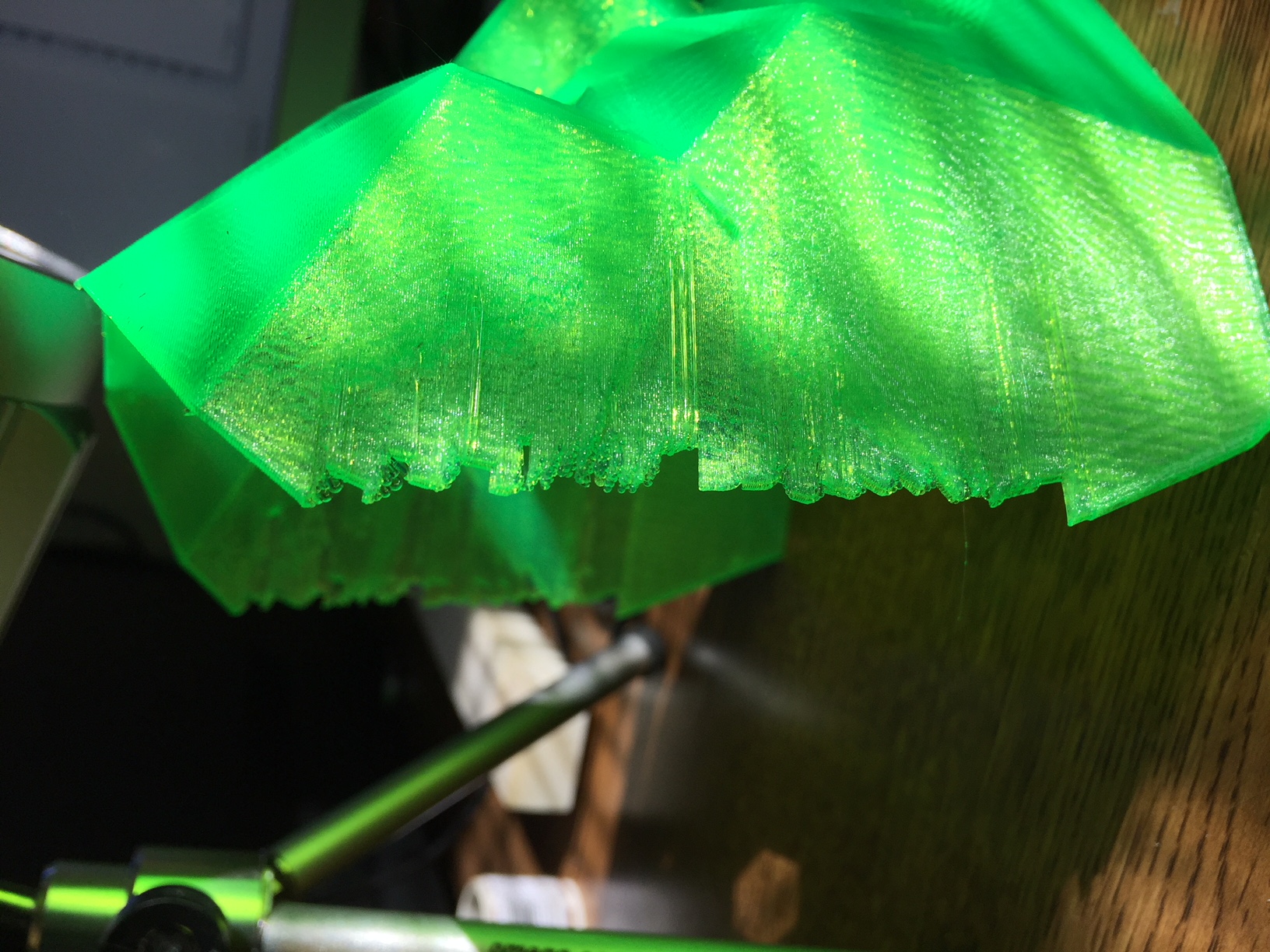

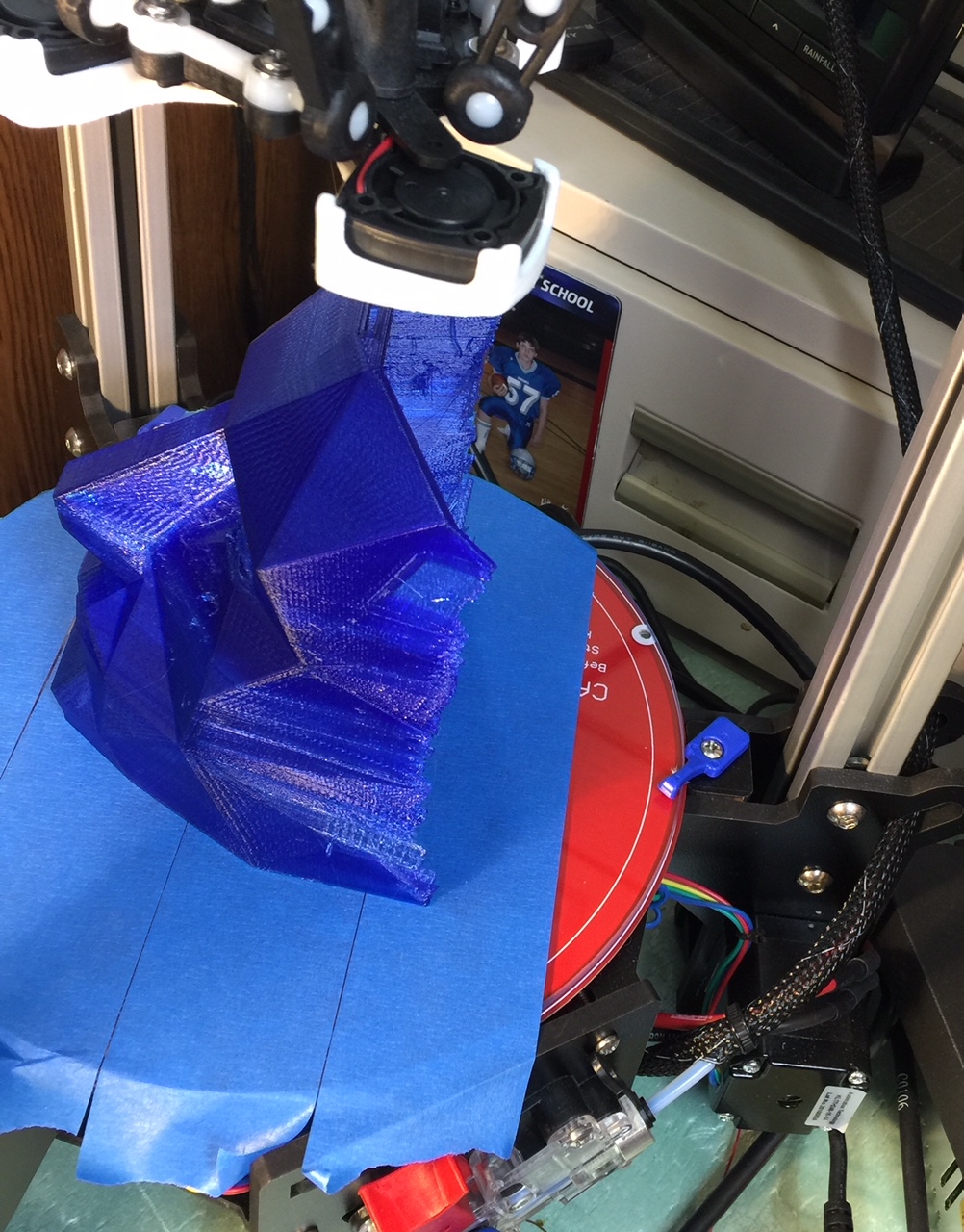

I've been trying to print some masks, but the printer is cutting off the edges on both sides as if it's hitting a limit.
I'm not sure what to change, there is plenty of room left for the mechanicals to move.

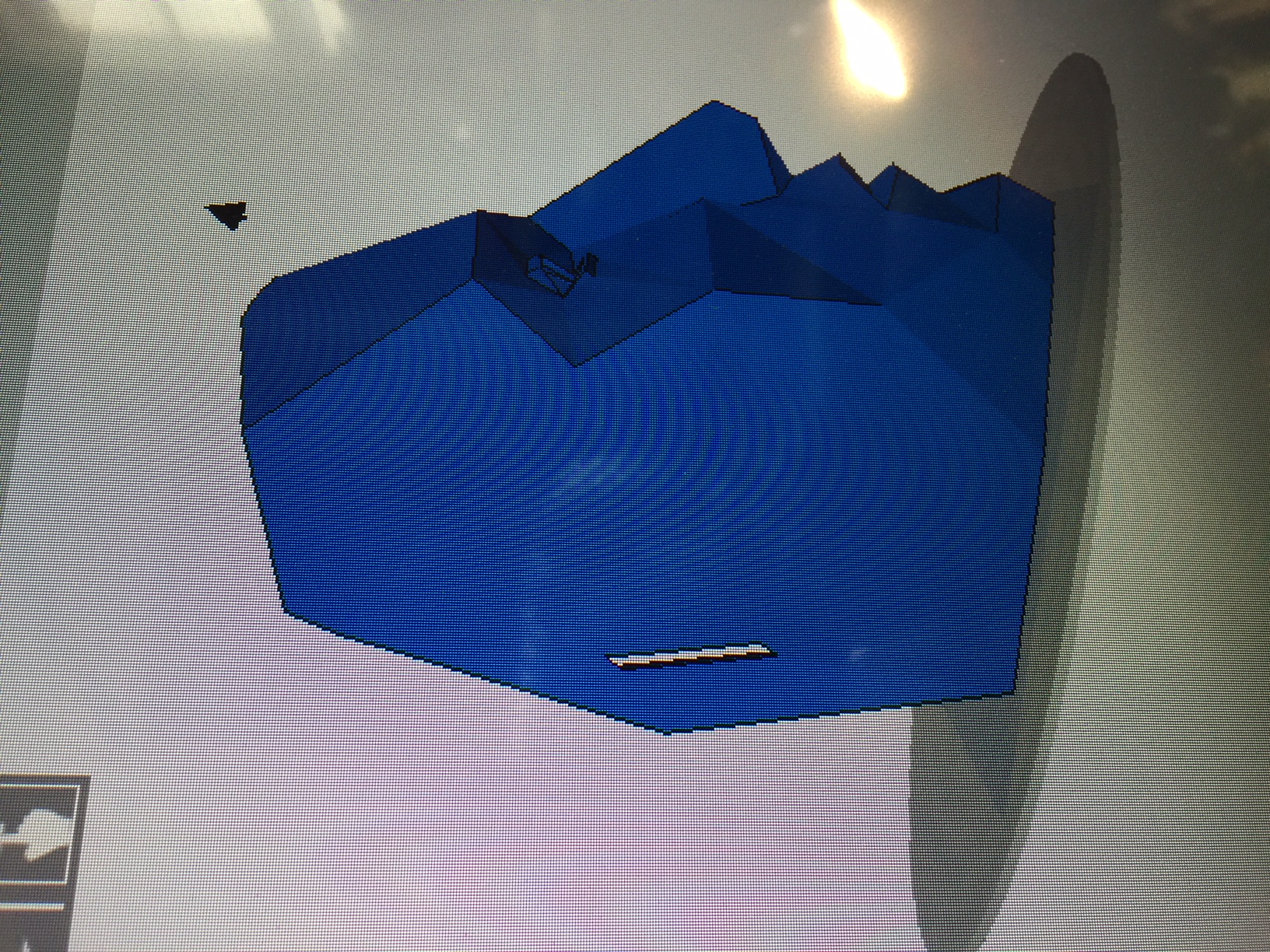

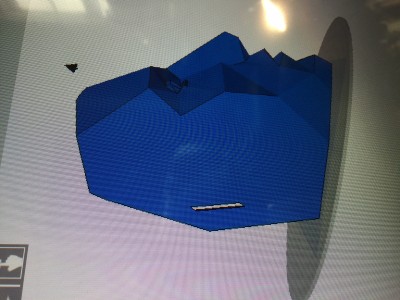

Here's a pic of what it should print. and here's what it's printing: Probably something simple, I've tried changing print area in MatterControl, and recalibrating the H2, I have the long arms installed.
