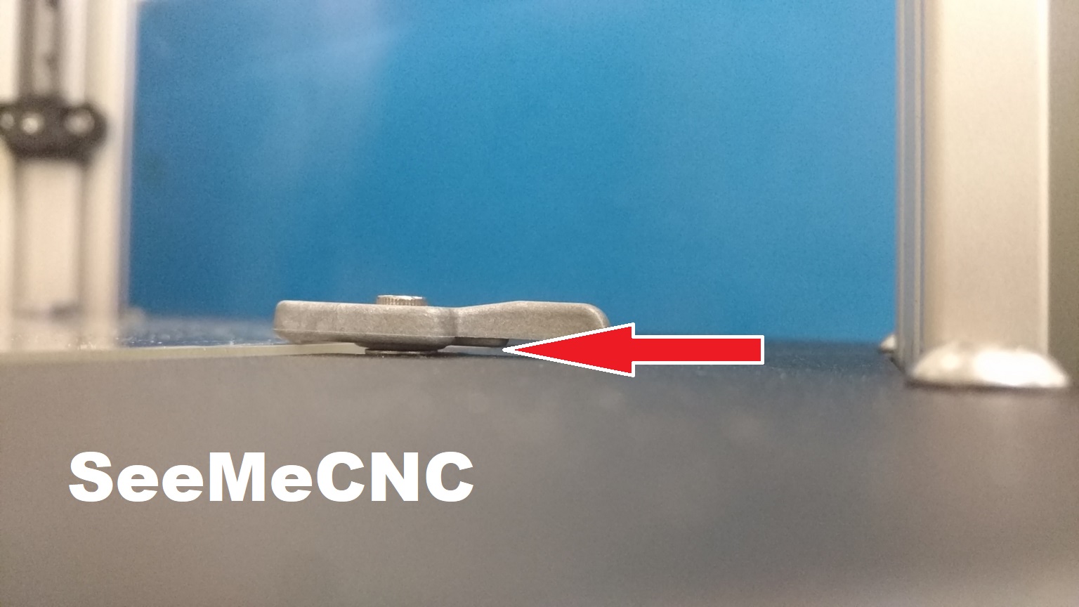

If you've got an FSR-equipped Artemis 300 and you're having calibration problems, check to make sure your bed clip is clearing the sheet metal chassis as shown in the image below.
The reason for this is that if the clip is in contact with the Artemis chassis, nominal nozzle pressure won't be enough to trigger the FSR at that location, causing either failed probes or excessive nozzle pressure.

Thanks for pointing that out. I rushed to check if that was my issue. Sadly it wasn't, but I'll keep it in mind.
