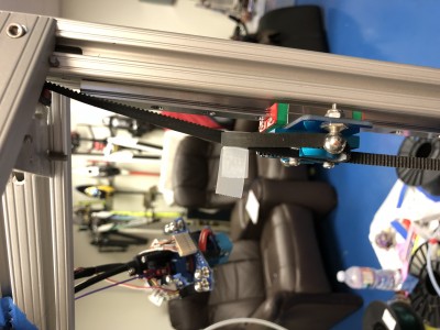

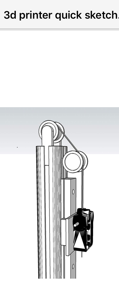

I'm currently installing a set of 600mm linear rails (HiWin MGN-12 model) and have run into a slight hurdle and am in need of those more knowledgeable than I (pretty much all of you reading this I'm gonna guess
) to please have a quick look over the attached couple images to advise me as to whether or not the idea presented in the Sketchup CAD drawing I quickly threw together will work, to overcome the obvious major deal breaker depicted in the photo of my delta printer as it currently stands with linear rails attached but problem with the belt path. In case you can't tell, the belt is no longer parallel with the motion path and catches on the ends of the rails pretty much the entire length of travel and is, therefore, unusable until a new path for the belts is devised.
I was lucky enough to get ahold of the resident pro on this forum (mhackney) who was extraordinarily generous and helpful, and was nice enough to forward me his existing solution for this same problem. I'm looking forward to receiving that message. The idea I drew in Sketchup is what I came up with that I would have tried to implement in the event that I wasn't so lucky with contacting Michael. I'm just very curious whether that idea shown above would, in fact, provide a feasible work around for the problem with the belts and their indented paths caused by the thicknesses of the rails and carriages atop the existing extrusions, or if there's some fundamental factor I haven't accounted for that will cause a malfunction with printing if done in that way.
