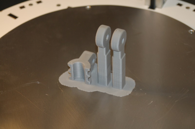

Re: My first Rostock MAX prints after calibration
Here: http://www.geneb.org/images/bearing-and-rod-ends-1.jpg - the tall parts are about 5" high.
This Spitfire grip: http://www.simpits.org/geneb/wp-content ... grip-1.jpg took a little over 11 hours to print.
No retract issues.
