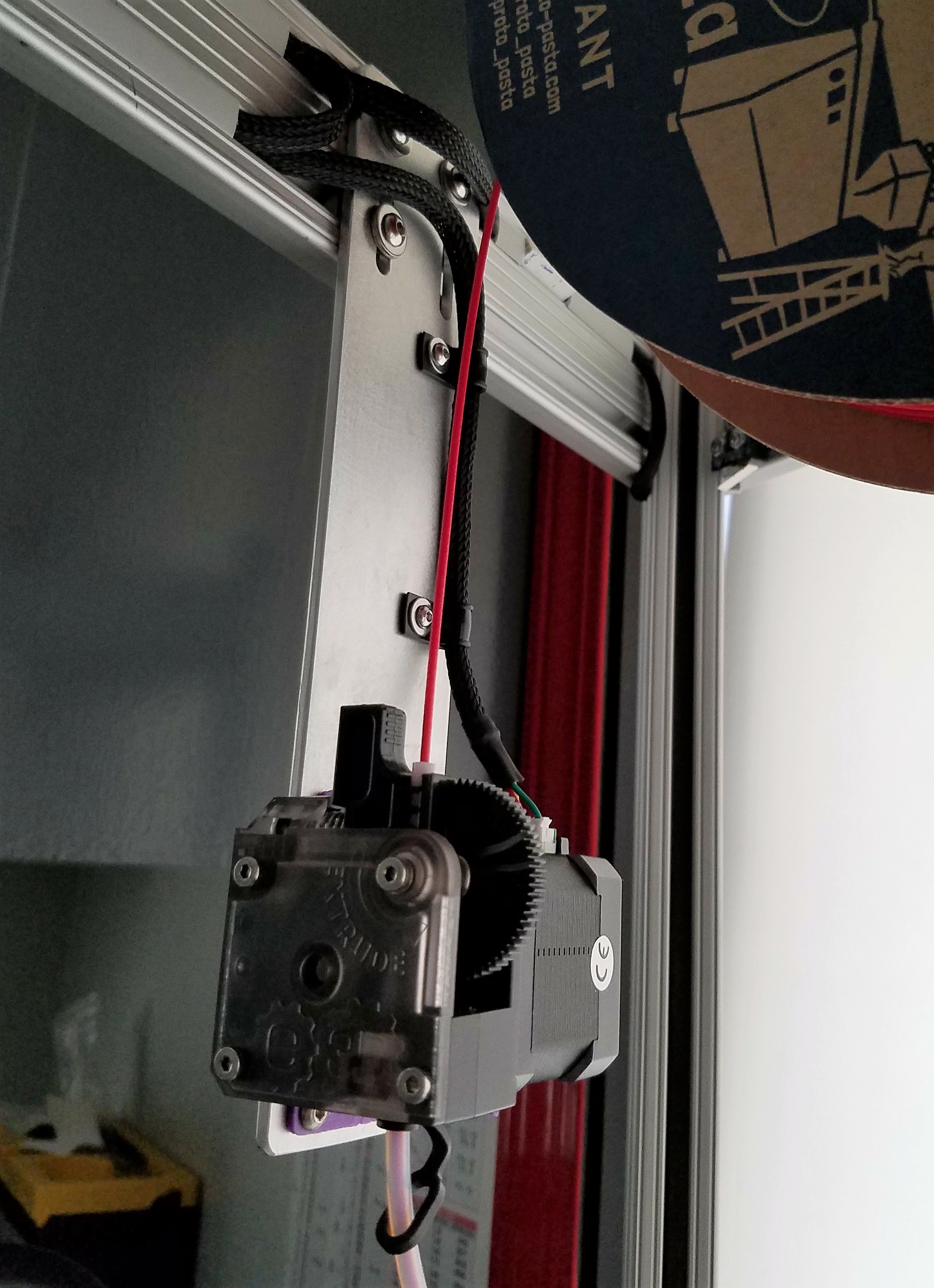

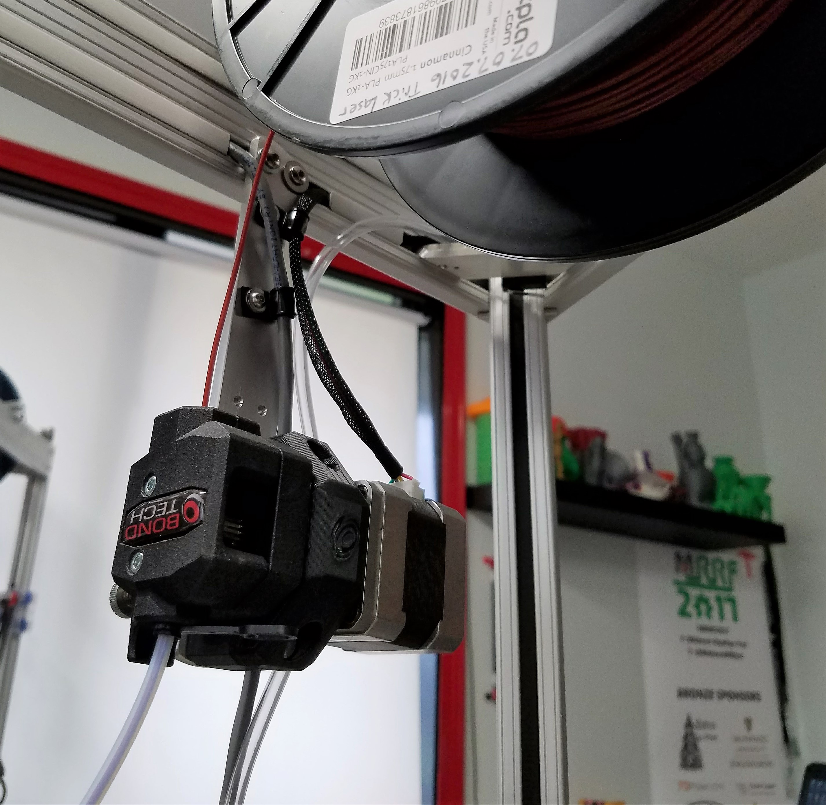

I have mounted the Titan and Bondtech extruder on the MAX Metal Frame with a simple flat aluminum bracket, see attached pics.
Mounting spool on a simple cross bar, like this...
http://www.tricklaser.com/MAX-METAL-Spo ... -SPOOL.htm

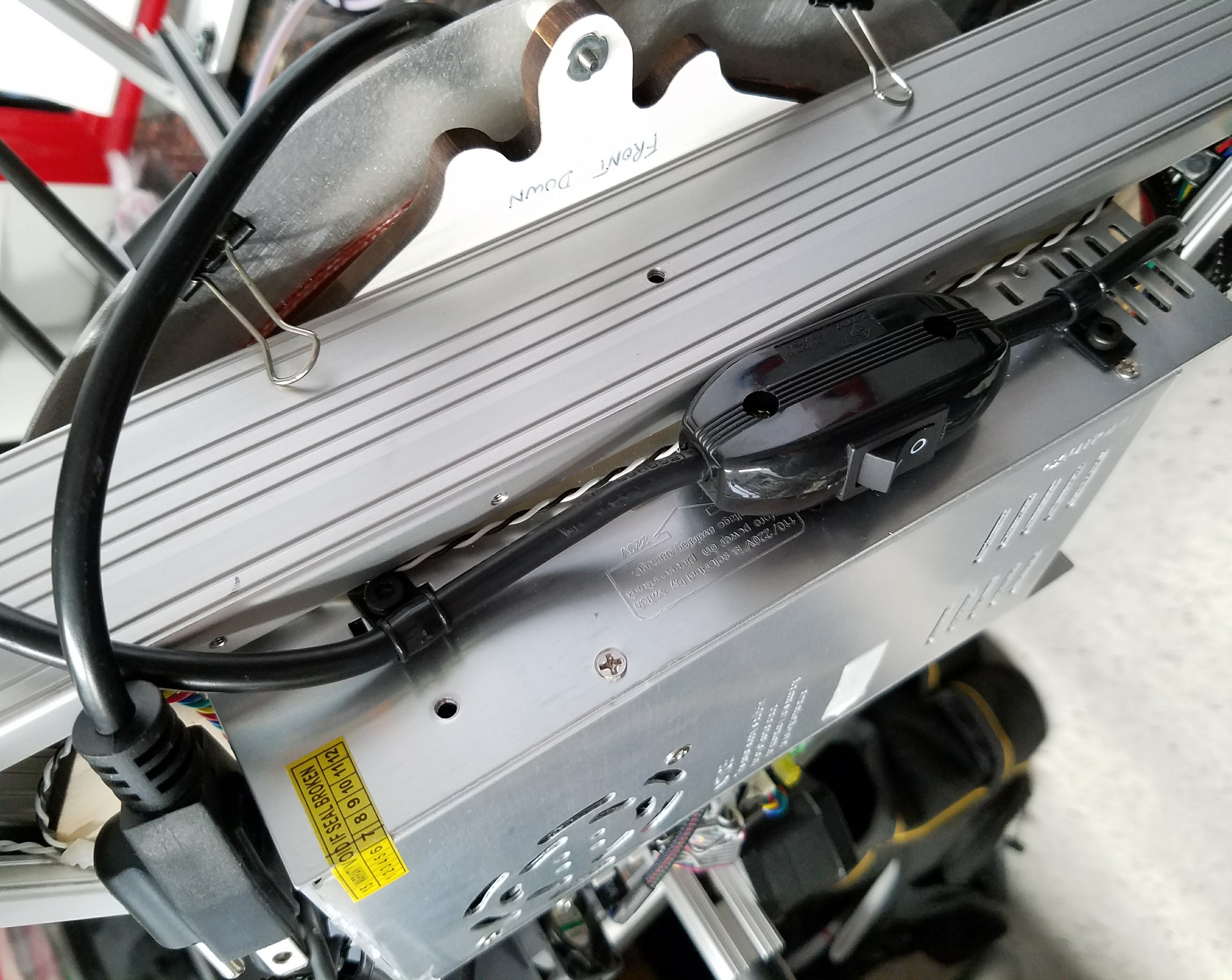

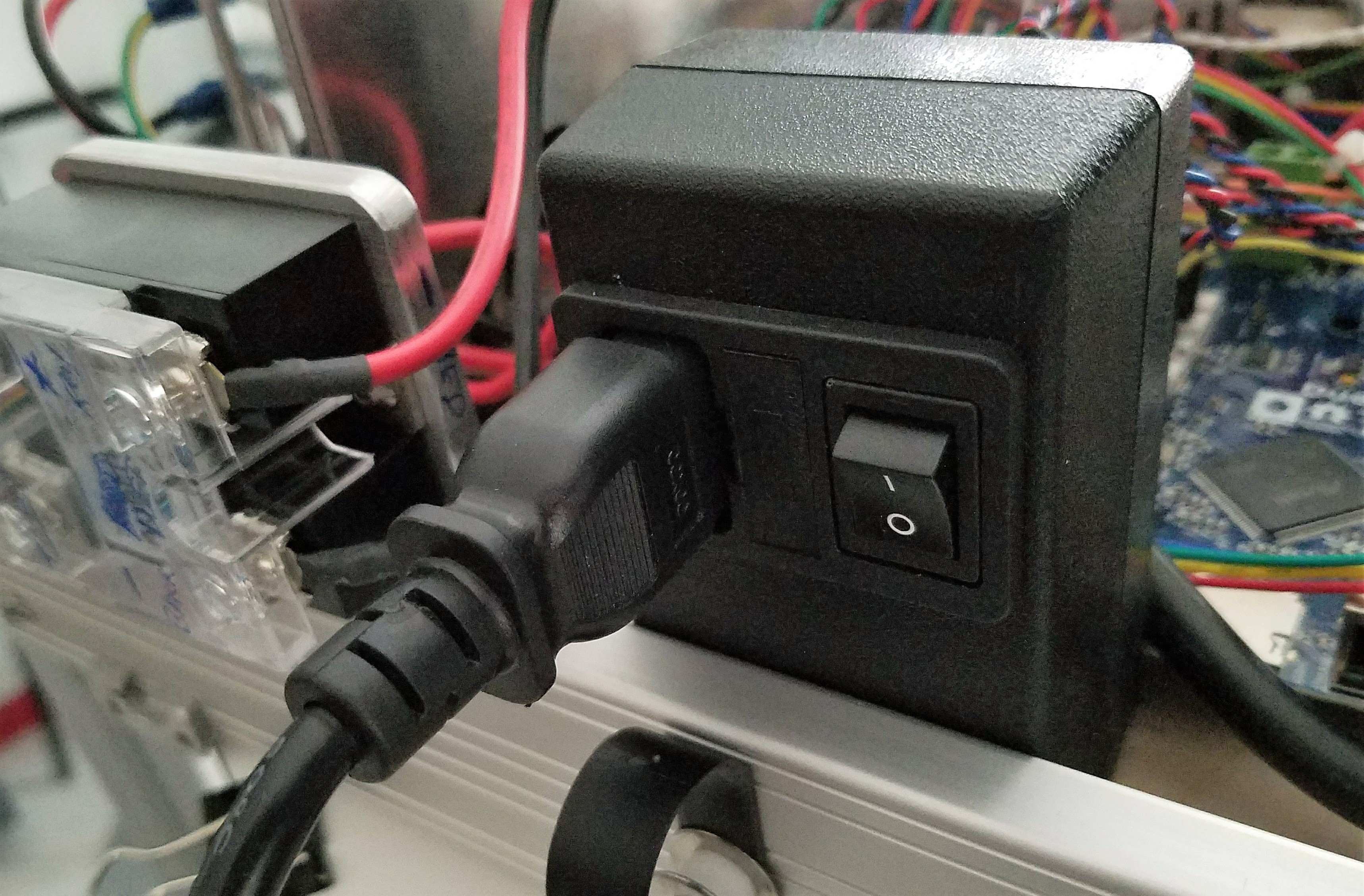

For the power entry I have not found anything I really like. I have used a small plastic box like this https://www.mcmaster.com/#7593k25/=171x0wz
or a simple inline rocker switch on the AC cord.
Some I mounted a IEC connector in the bottom electronics mounting plate, but that was a bit unhandy to reach switch under printer.
Some I have built used a ATX psu with switch and power cord plug on the psu.
I wish there was a clean and simple solution for the AC power in & fuse with the Meanwell style power supply.

Hi Brian! Thanks for the reply, I don't have access to a machine shop (unless you count Mhackney as that haha) to make those sweet metal brackets, but I should just 3d print something similar and that should work for me.

Brian - what have you used to cover up the wires in the extrusion channels? Looks really neat and tidy.
