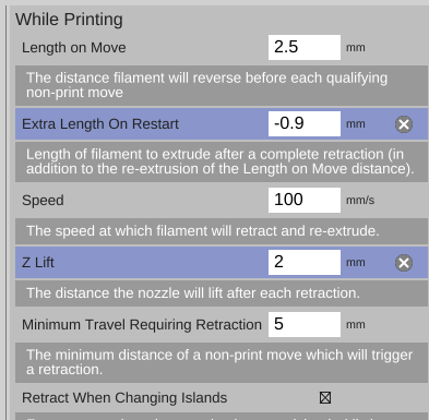

Rostock Max V2 with new HE280 Hot end, printing ABS, trying to dial it in. Receiving blobs on prints. Playing around with retraction, not moving forward. Any suggestions or settings? Thanks!
Screen Shot 2017-03-27 at 7.11.37 AM.png (52.17 KiB) Viewed 3695 times

If you're willing to try Cura (or crack open the profile and transfer settings), check out the SeeMeCNC profile for ABS (https://github.com/seemecnc/slicing-pro ... uraprofile). JJ worked on this one and has been getting great prints out of it.

Thank you! Running Curra with the profile for ABS by JJ and it is amazing. Appreciate it!
