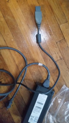

Re: H2 Delta hacker series: can i upgrade to a hot bed, and if so how?
okay, thanks everyone, i just got the resistor, the LED, the thermistor soldered to the orion heated bed, and im about to solder the wires for the thermistor <> mini-rambo link...
SO, exactly where do i cut the xbox 360 power cord in the attached picture...? AND tehn i assume theres 2 wires in there, and i screw tighthen them into the mini-rambo 'POWER INPUT A' screw down 2 wires'..
but due to the fact that this is the power, and im a newbie, that just built the H2, i want to make sure im doing the power portion correctly.
thanks
marc
Is there anything particularly magical about the XBox PS, or will any PS in the 130W range suffice? (I live a few blocks from a local e-cycler with a thrift store; they have plenty of laptop power bricks but not so much in the way of XBox hardware.)
- Posts: 1561
Of note is that some of the laptop bricks are adding a V-sense or a communications wire, meaning that some them may not activate the output until there is some communications (Or do other things, such as changing the output voltage, current limiting, ETC). Best bet in my opinion is probably the correct wattage of Targus or similar universal adapter, with a barrel jack stuffed into the printer, so that way you get the ability to disconnect it and take it somewhere with less power (say a show, dorm room, or camping)
- pouncingiguana
- Posts: 148
- Joined: Tue Nov 15, 2016 8:48 am
Which power supply you use doesn't matter, but remember that you'll be pulling close to 20 amps through it, so it'll need to be a beefy one. All of them should have their voltage and amperage ratings written on them. You're looking for 12-14V and at least 19 amps to run everything without issues. The Xbox Power supply or an old server power supply are the more popular and easier to find options.
