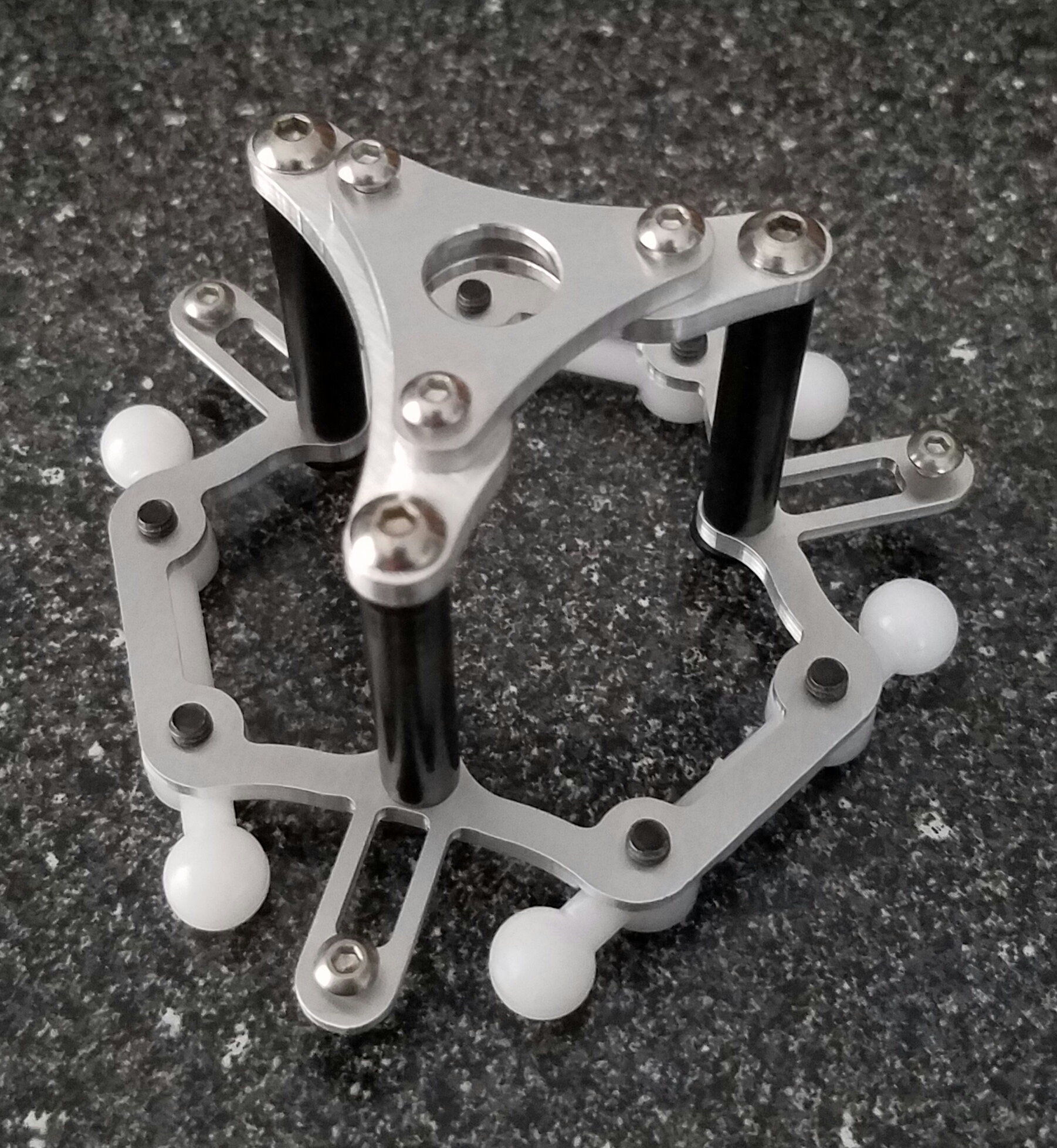

I'm trying to figure out how to install a Volcano hotend on the Max v3.  The hotend does not look very easy to swap, can't find any set screws to release to get the thing to drop out.
I also have a high-temp heatbreak attachment I would like to be able to swap out in case I want to print with PET. I couldn't find a good guide to how to do it.

The whole hotend and mount would be changed out, you would have to disassemble the old mount and desolder the accelerometer from the stock hotend. Then solder the heater cartridge and thermistor leads from the volcano into the accelerometer board and assemble into a new mount. There are volcano mounts you should be able to print or purchase from people that have fabricated it i.e. http://713maker.com/mounts.html
As far as PET, I was printing e-Sun PETG at 240c .3 layer heights @ ~50mm/s with stock setup with good results. I've upgraded to E3D V6 since then though.

All things considered, I would recomend you buy a new effector+ball joint set with the hotend, and either a compatible socket or another accel board, so you can swap them out, as the E3D and the like have slightly more issues with PLA than the HE280 from my understanding (It's a small difference).

What accel board would you recommend? I just swapped to the new hotend and Bondtech QR recently and liking the control now. I haven't had the chance of using the HE280 with the Bondtech so maybe I didn't have to upgrade but I am on an upgrading spree at the moment to get rid of inconsistencies I've been experiencing. I plan to have separate hotend+mounts (E3D for general printing/Volcano for prototyping/Chimera for multicolor or multifilament support) for different applications so all I would have to do is remove the whip clip/Bowden/platform from the ball ends and put the desired assembly on and do a quick calibration. This would save me time and reduce chance of damaging anything with my clumsy hands.Xenocrates wrote:All things considered, I would recomend you buy a new effector+ball joint set with the hotend, and either a compatible socket or another accel board, so you can swap them out, as the E3D and the like have slightly more issues with PLA than the HE280 from my understanding (It's a small difference).

With a Rambo, I would use the HE280 accel board.  With a duet or smoothieboard, I would suggest a Yellowjacket quick change board with either FSR's under the bed (So you only need one set of sensors), or an IR probe board.

I just finished putting a Volcano on my v3 using the 713Maker.com effector.  Works great and looks sharp.
