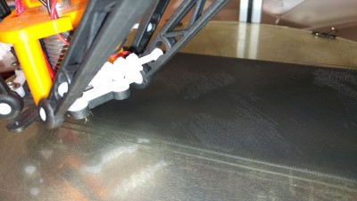

I am printing this first layer without bed leveling, but of course with duet auto calibration. Detail is so fine that you can see a moiré pattern
Anyone an idea?
Thought about that, but would the border between rough and smooth not be smeared over a longer distance? I' try rotating the bed to see if the pattern follows.DerStig wrote:Those look like high spots on the build surface making the nozzle closer to the build plate
